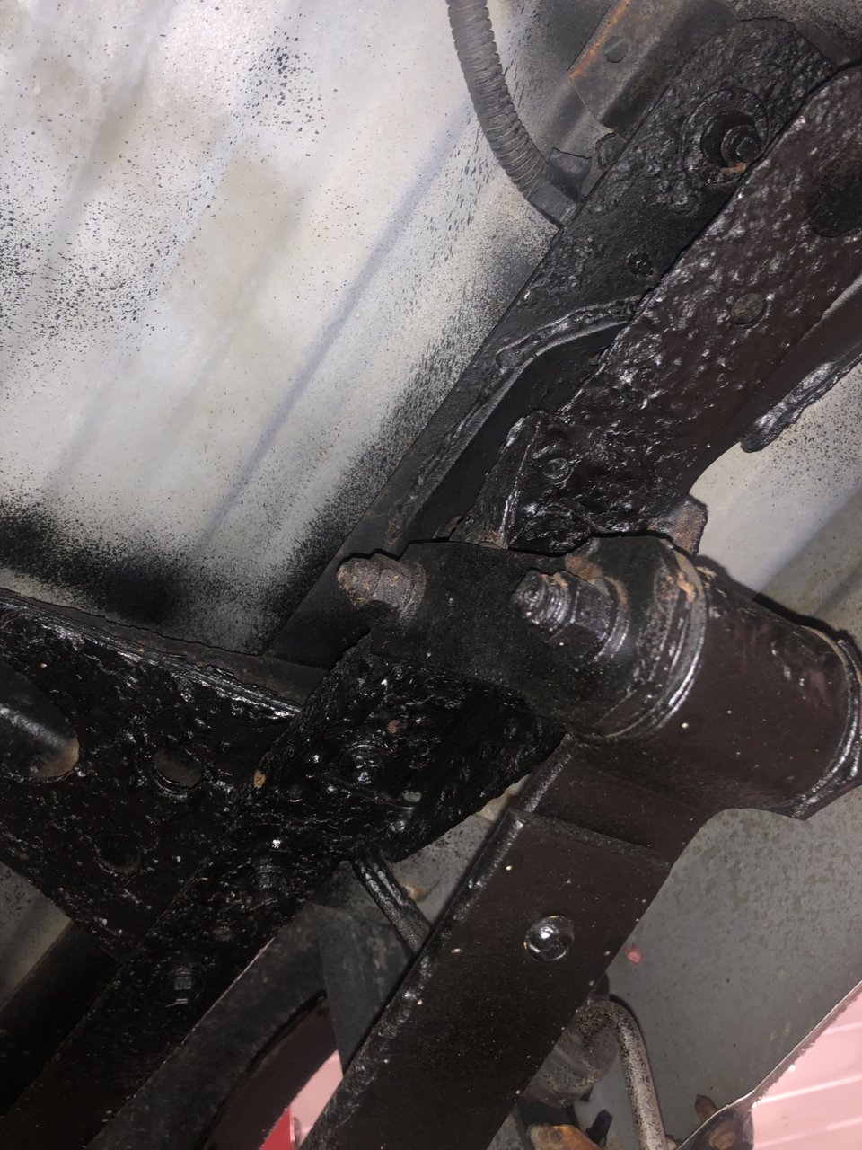

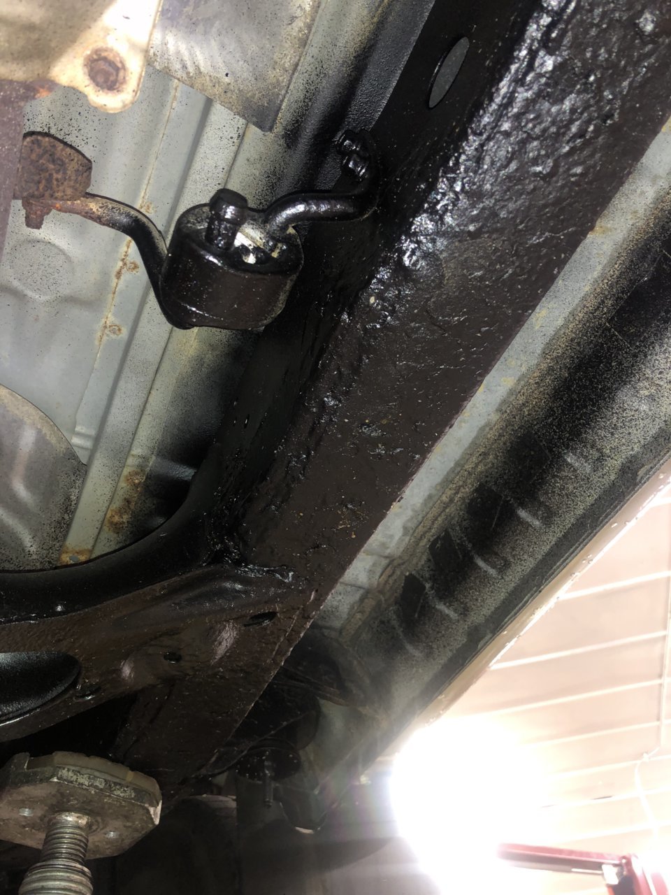

    Okay so I made a rookie mistake! Found an 02 Reg Cab 4wd A/T being sold in VA that lived a life in PA (I’m from Brooklyn, we don’t really salt roads) so I assumed PA was south enough (wrong). The engine (118k), body, and interior are 90% mint. The previous owner did a seat swap (center console) and rear window swap (sliding door). I was probably overly excited that I missed the really well placed fiber glass patch jobs hidden under a thick coat of under coating. Long story short the frame is rusted and in need of some Safe-T-Caps on pretty much the whole back end. Looking at $2k in parts plus whatever time I can spend cutting, cleaning, welding. Question. Is it worth it? Or do I attempt a complete frame swap?

    Post some pictures if possible. Will give us a better idea

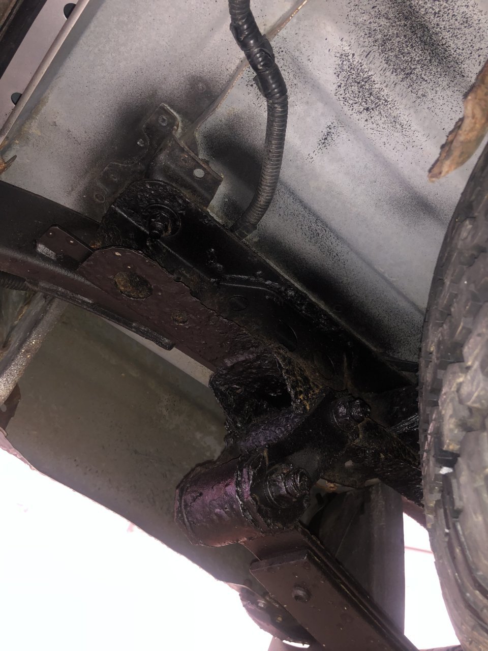

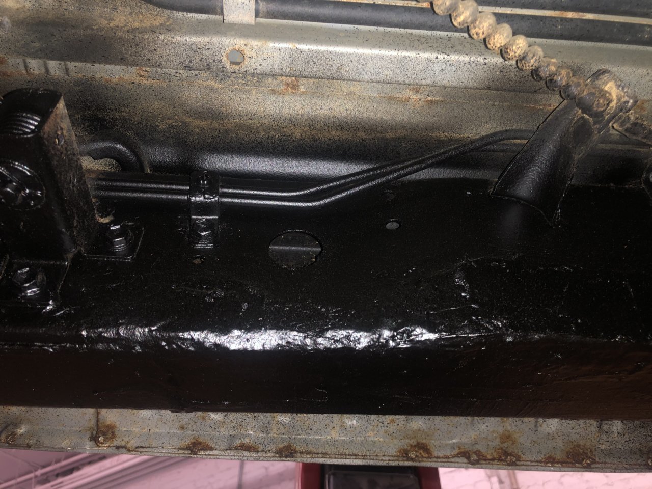

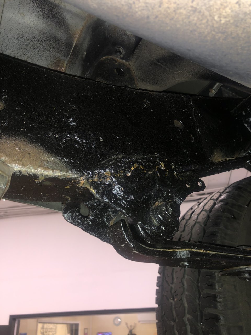

    These are initial photos which make it look a lot nicer than it really is. One of my upper read strut mounts is also cracked and needs to be cut off and a new one welded. Feel like Safe T Cap is kind of silly with the entire rear end needing work. But maybe I’m wrong (I hope)

    safe t cap rear sleeves come with the front leaf spring hanger so if you want to fix you just cut all that out and clean it up, put sleeves on and weld. its not a huge issue and it will be strong. Wont look great but will work. How much did you pay for the truck? Looks they tried to bondo it. lol

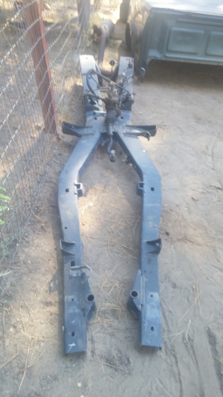

    I agree on the frame replacement being ideal. If I could acquire a rolling frame Id be interested but I feel like that’s unicorn these days especially being in the rust belt

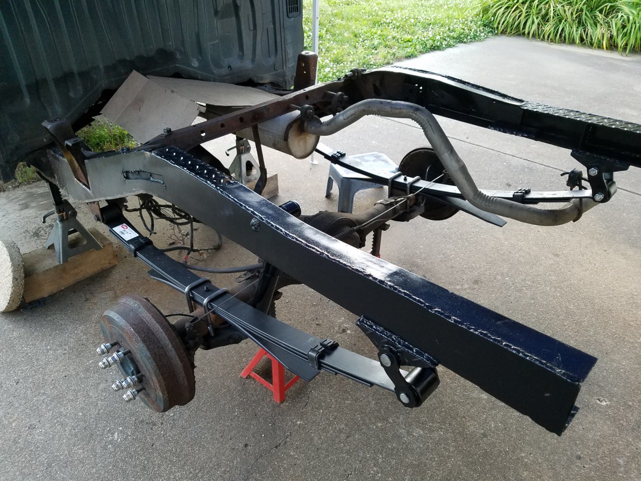

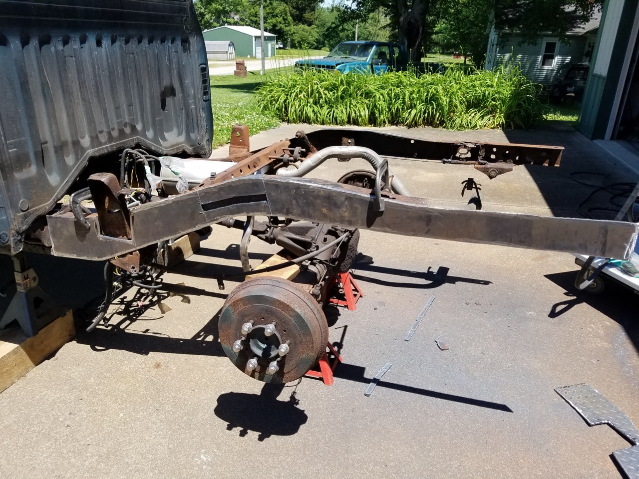

    If it's just the rear, I made a new rear section for one of my trucks. If you have a plasma cutter and MIG welder, its not that difficult. If you don't have them, you can buy them for less than what you'll pay to have it done.
    It's not perfect, but it does the job. 2 years later and no problems.
