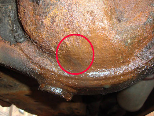

    Found the hole... took a wirewheel to it and found one small pinhole in this location.
    This is the old picture prior to cleaning the housing off

    Be easy welding the hole. Very easy to blow through steel that is that rusted

    i have a 95 gmc, rotted to the bone. the oilpan was rotted . cleaned it as best i could and mopped on jb weld. slowed the leak right down. just use it to plow my yard out though.

    similar to my oil pan .bet if you push on it you can see the oil comming out. put the jb on thick in a couple off coats. it will buy you some time.

    If its rusted so bad that oil is leaking out then that metal is thin. That would be like welding a soda can.
    Find a new rear in a salvage yard for a couple hundred bucks and spend a Saturday swapping it out. Then its done right and you wont have problems 500 miles or 6 months down the road.
