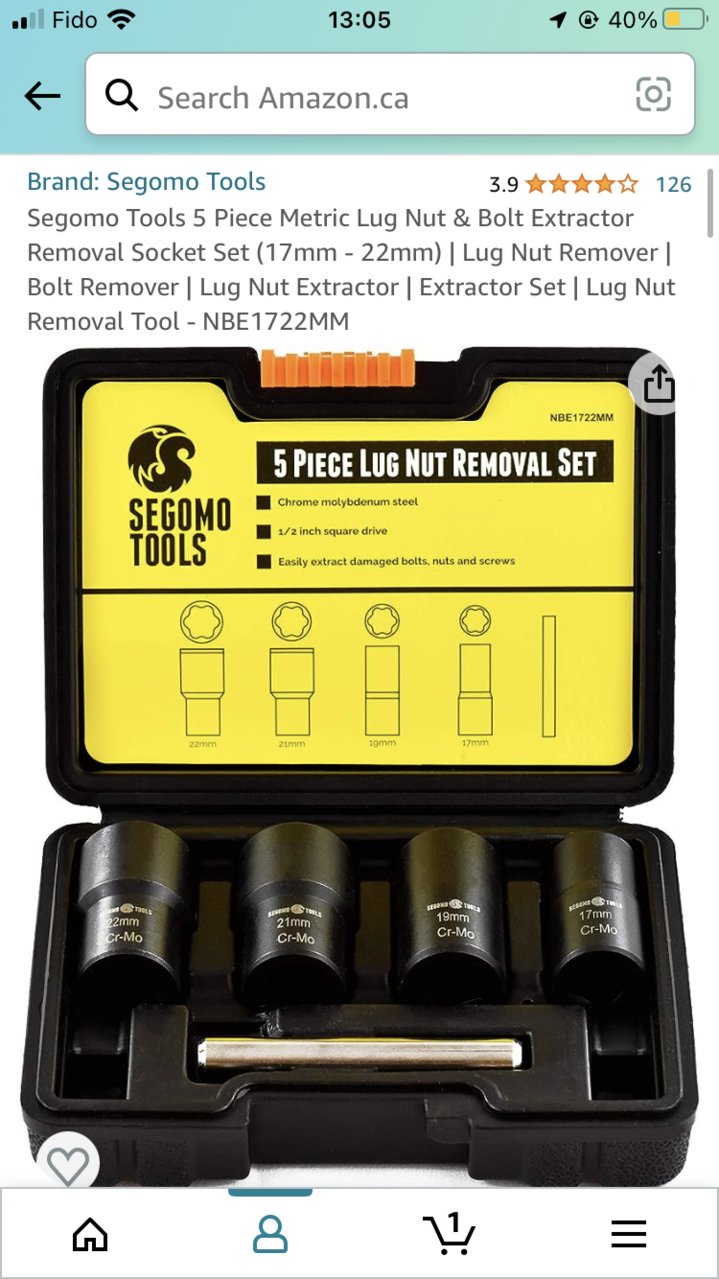

    Penetrating fluid. Spray, wait 30min, spray, wait 30min, finally pray.
    You can also TRY to use something similar to this if you don’t have a welder handy.
    But if that fails, just weld a nut to the fker.

    Had this happen on a prior rusty yota and the both the drain and fill nut started to round off. Used an Irwin 24mm bolt extractor. Both came right off. And that was a massively rusted piece of shit. Replaced both with new plugs.
