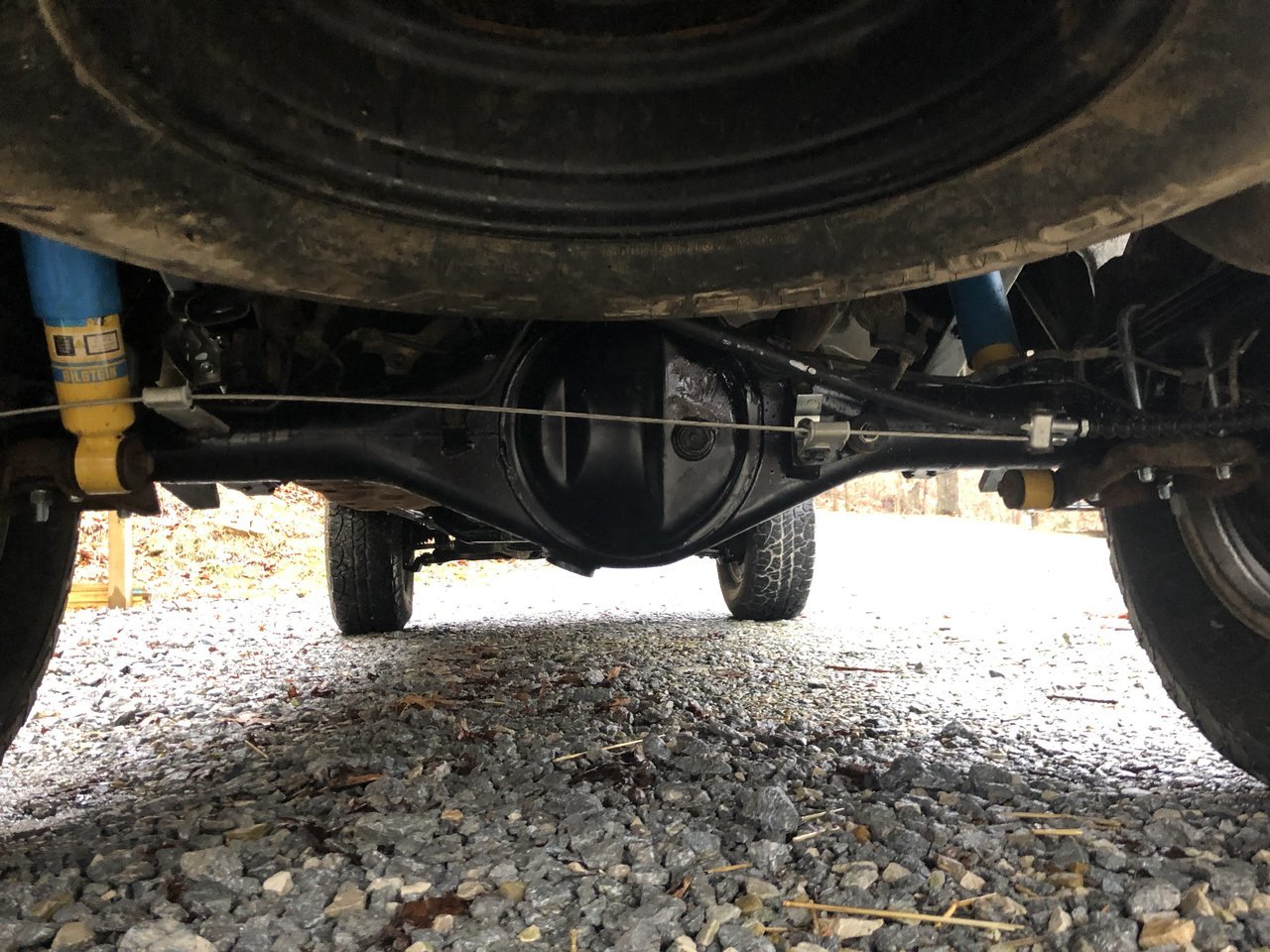

    I have an 03 and got my housing off an 01. The brackets were different for the e brake, but not that big of a deal. They changed brackets from old housing. My housing came off a non abs truck, and mine is abs. The non abs housing accepts abs, it just has tabs over the holes.

    03 was supposed to have the bracket on the pumpkin. This is the way mine was done. I think the housing was off a 01 or 02. 84BDE482-1F9A-457D-85B3-387A648FAA50.jpg

    Looks like the cable on the left side is very close to the shock. But it looks good.

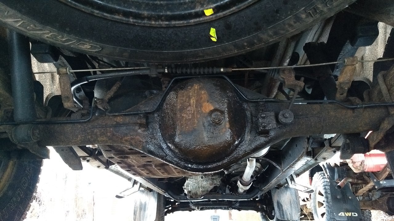

    This is mine at the moment.

    It is close. Just under a half inch of clearance. Better than what I had, and when I found one that accepted the e locker I went for it.
