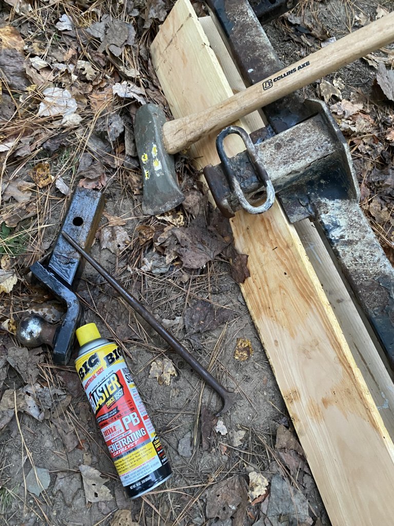

    IMG_1287.jpg A night of pb blaster, 2 pieces of wood and a BFH later tow hitch was removed. Thank you all for the advice and next up is the broken bolt.

    Glad you were able to get it out...
