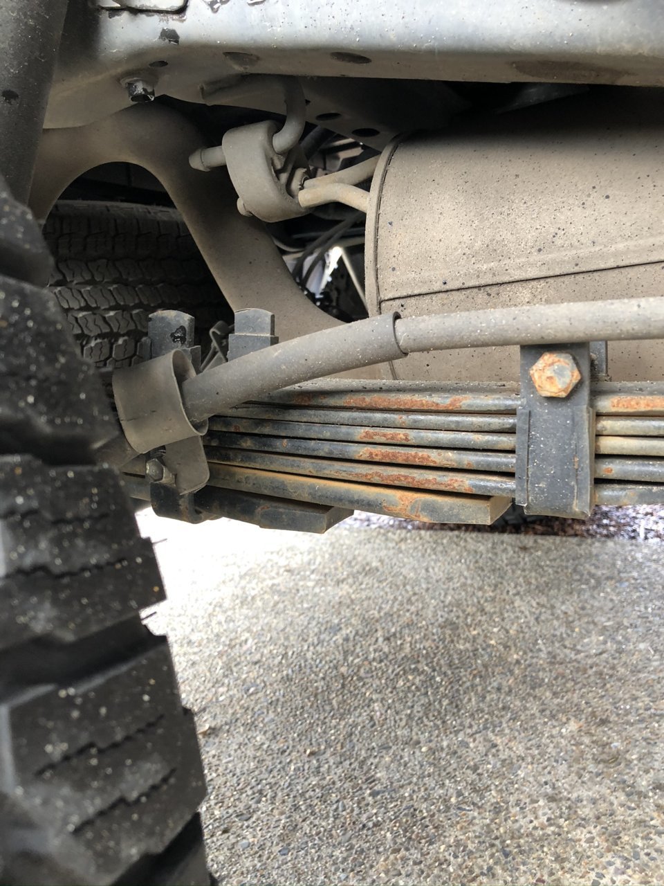

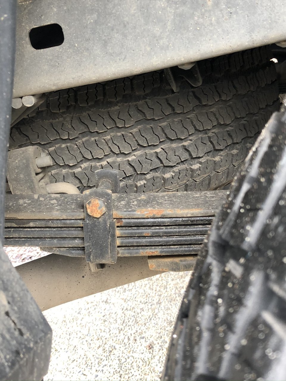

    5FB832D5-A299-48FB-95DD-9C622ED798FA.jpg 18CCCB4A-91E2-4B6E-BBF2-E44E7A3CB23D.jpg 5FB832D5-A299-48FB-95DD-9C622ED798FA.jpg Hey all,
    Quick question, I recently upgraded my leaf pack and after about 2 months I noticed a little bit of rusting on it, which seems wack. I called up the shop who installed it and they basically said it was normal and most leaf packs end up doing this. So my question is, is this actually common?

    These are AALs or a full new pack? If it's a Dakar leaf pack mine look identical. Ain't a big deal.

    Full new pack - dang even the OEM lasted longer than that haha

    My pack came with painted flaking off, which they said would happen, so I'm assuming the bare metal rusts pretty quickly. It's mostly surface rust

    The paint isn't as flexible as the metal. The paint flakes off, you get surface rust. To prevent that, the best way is to wire brush your packs and moly-grease them. They'll work smoother too.

    It’s hard to believe, but Toyota actually manages to make OEM leaves that resist rust. All the aftermarket leaf packs and ad-a-leaves rust right away. If Toyota put the same paint on the frames, we’d all be happy.

    normal, it really wont affect anything, they will wear out before it becomes close to breaking. if you feel bad, spray some rust reformer on it after a light sand, paint and call it a day. My truck looks like crap, and as long as everything works well, and is reliable, i really dont care.

    My Dakars look similar at three years after install, I try to get the de-icer, brine, salt etc. off whenever possible after it snows and thaws.

    You're right, and that is because the OEM leaf springs aren't quite paint. They are part plastic, to make the leaves "maintenance free". The frames are more coated than painted.. The black oxide is a mid or cold temp application, dirt cheap and gets everywhere. Not really paint bc that is a PIA to make in volumes.

    It’s pretty normal, my leafs arrived rusted when I order them. They flash rust and just throw a top coat on.

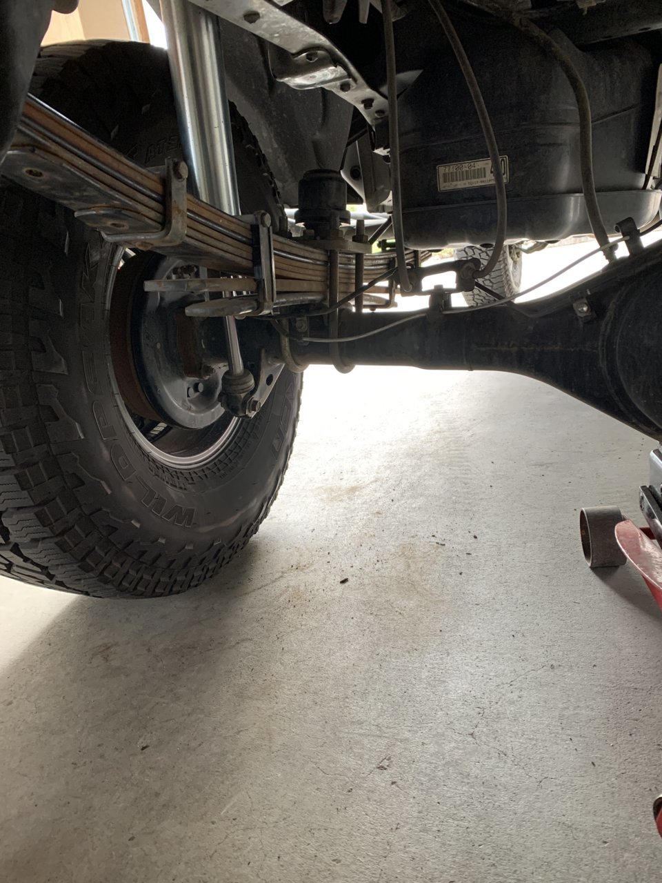

    These are mine and they are 3 years old.... Dakar's.
