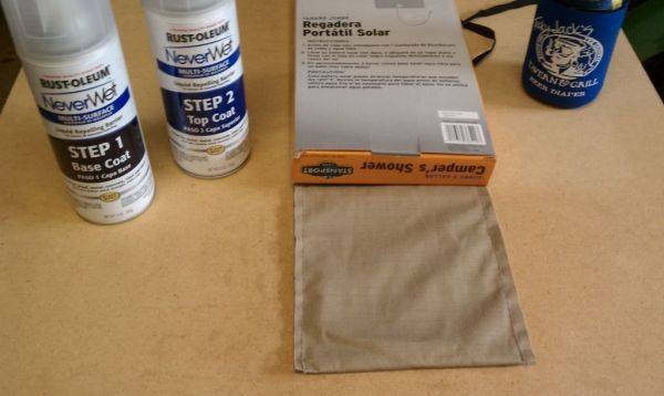

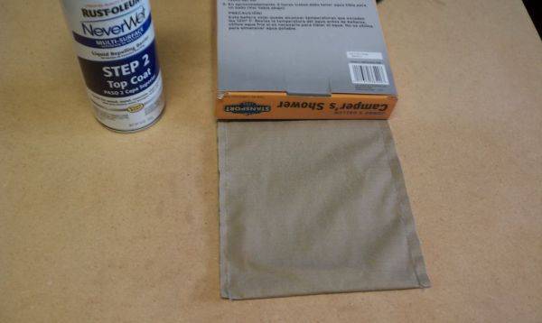

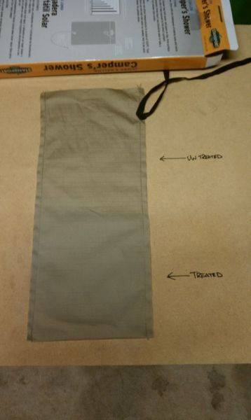

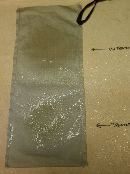

    I tried it tonight on a piece of ripstop tent fabric.
    Testing out NeverWet on a piece of tent ripstop fabric. The campers shower box is simply masking off a portion of the fabric. The base coat has just been applied. Top coat will be applied in 30 mins....
    Top coat has been applied. Cure time is 30 mins. Highest performance will occur after 12 hours...
    There is a slight frosted appearance between the treated and untreated side
    It definitely works. We saturated the bag with a spray bottle. The untreated side got soaked, the treated side continued to bead. I'm pretty impressed. How long it last is the question.
