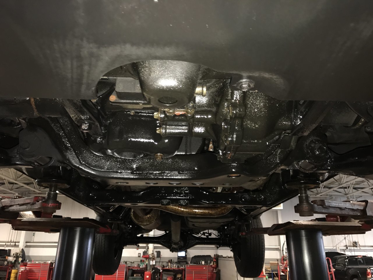

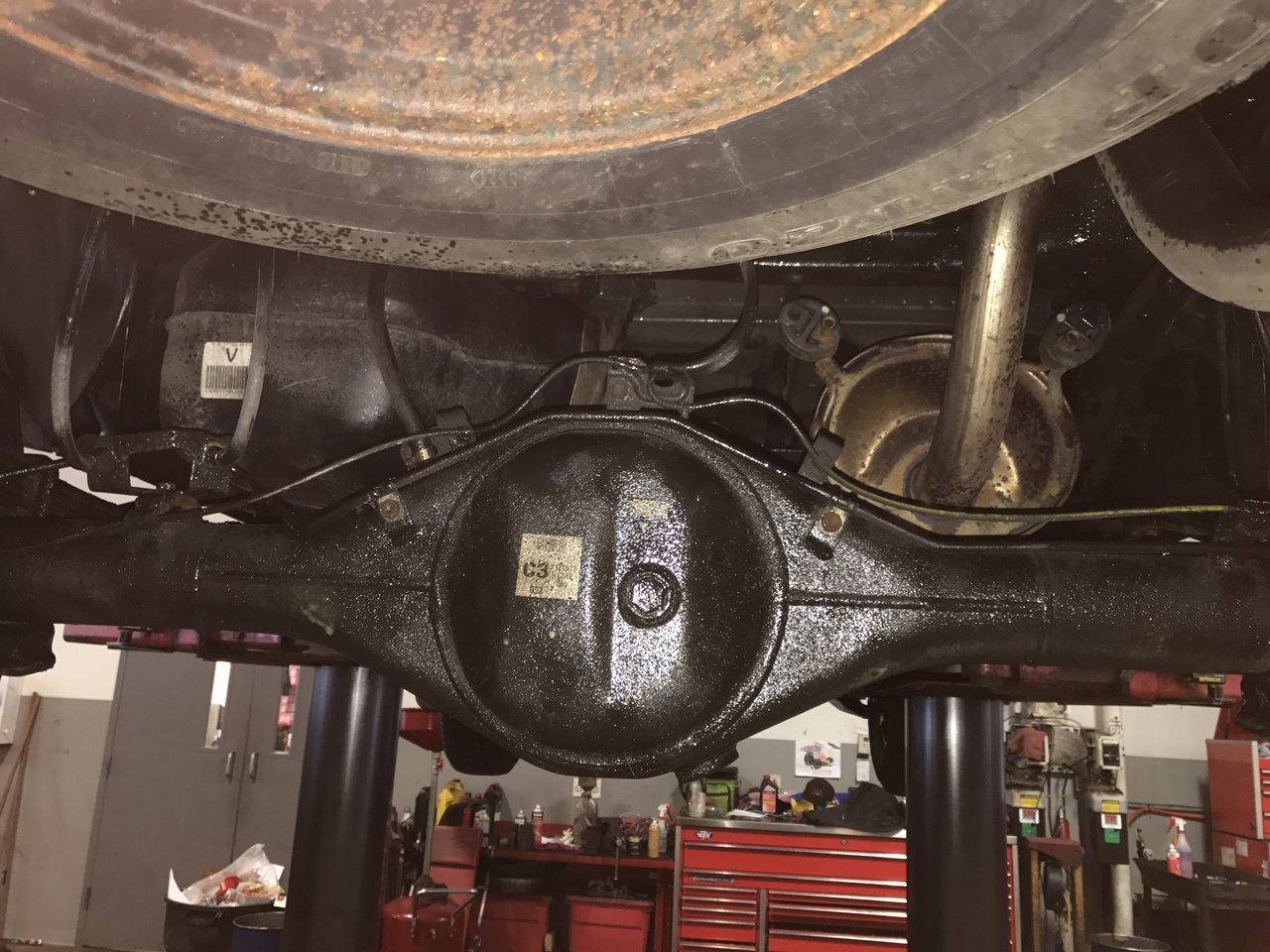

    It does work

    Is that your truck with FF treatment ? Very nice !
