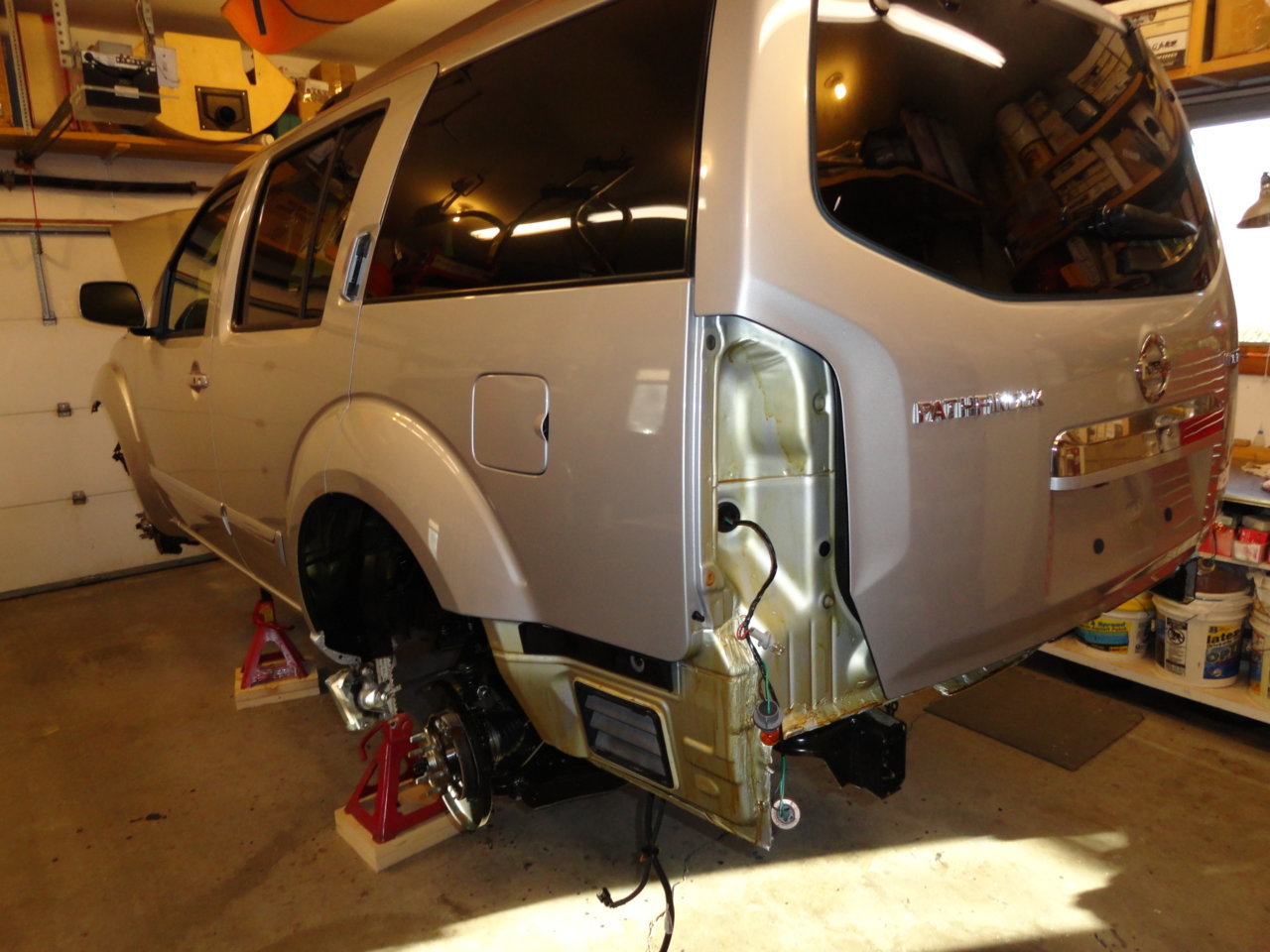

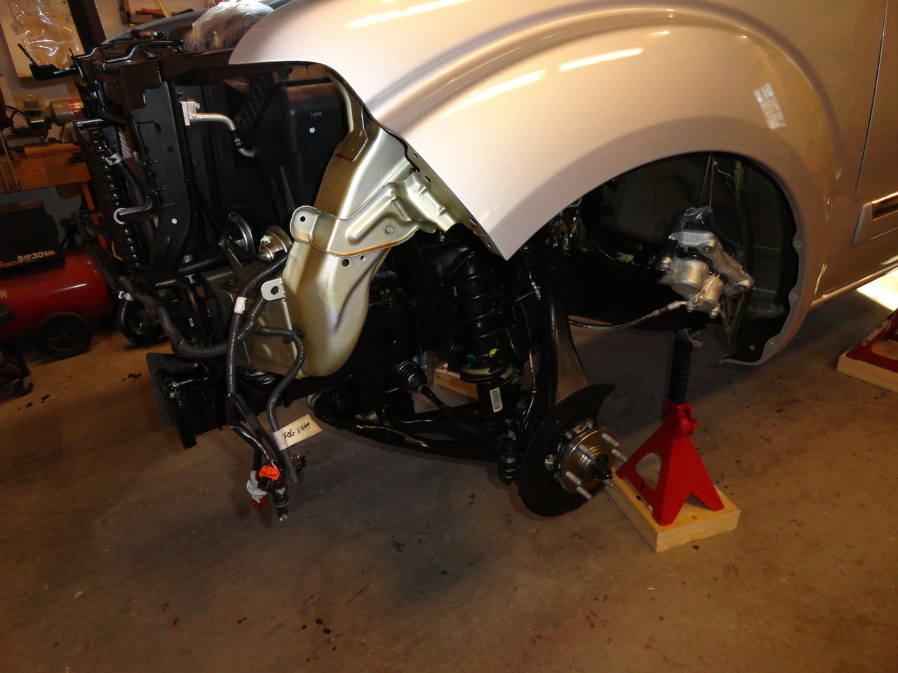

    I agree. When I get a new car now I drive it directly home (on clean dry roads) and put it in the garage and go to work on it. I disassemble things to a point that most people would think is crazy in order to get rustproofing in all of the nooks and crannies.
    Here's a couple of pictures of my wife's brand new Pathfinder about a week after she bought it.
    GQ7227, SR-71A, ponts and 1 other person like this.

    What did you use?

    I know I used paint in some areas (which I now think is a waste of time). The brown film is probably Amsoil Heavy Duty Metal Protector.
    On my 2016, I used the Amsoil followed by Fluid Film.

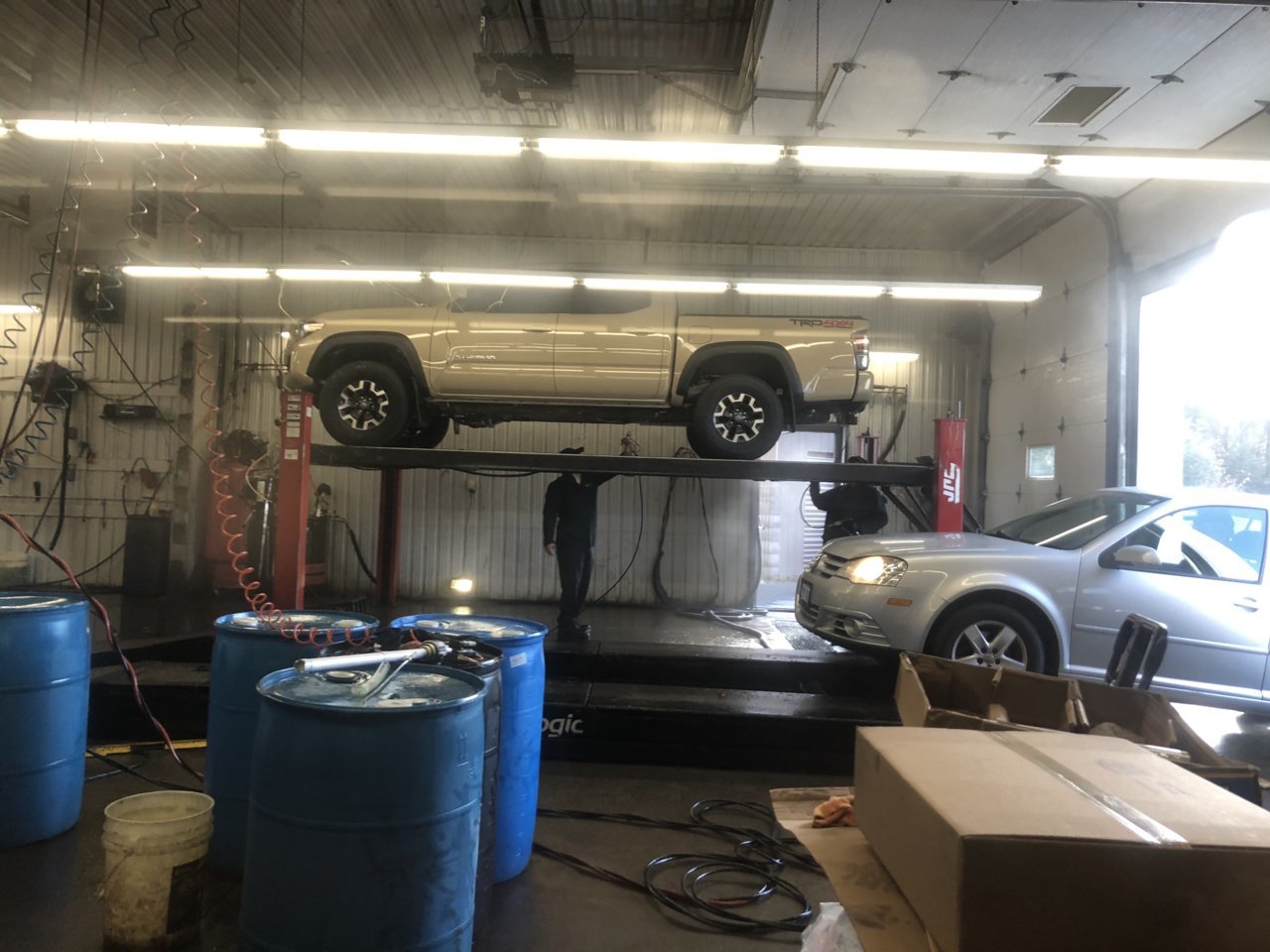

    I Krown everything. Here is my virgin truck a couple of days after picking it up from the dealer.
