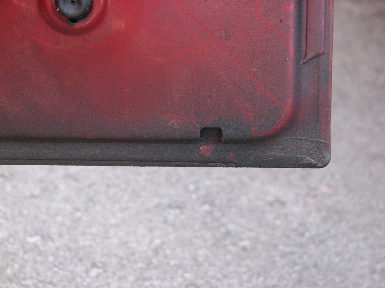

    This is the bottom of passenger door on my 2004 Honda Odyssey. 15 years in Toronto (canada) winter and all the salt that goes with it.
    100% intact seams and no rust and no clogging. It was Krown'd every year of its life and is solid.
    Also have a 2015 Tacoma in case you are wondering why i am showing a Honda but its the oldest vehicle so shows the results best.
    And as you can tell I do not wash the underbody and bottom of doors. i leave the accumulated oily and yes dirty film on there.
    The real issue with door seams is just normal condensation inside the doors etc.
    This will collect in the bottom seam and when it freezes it forces the seam open and cause cracks in the paint and even welds. Freezing water can exert a enough force to crack rocks, door seams are easy...
    With ever winter this repeats and as soon as some salt spray get in there its game over.
    What is good with WD40 type rustproofing is they are heavier than water and get into the seams and force the water out/up.
    But a picture speaks a thousand words and this 14 year old door seam says it all

    Did you use fluid film? Looks great!

    Maybe its the shop but the one that did my 2015 tacoma didnt drill any holes, they just used all the existing rubber plugs and access points... ON my 2004 odyssey they did a couple of holes.

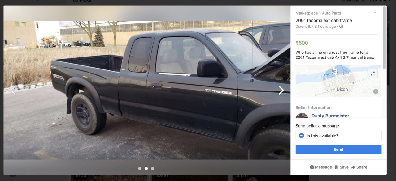

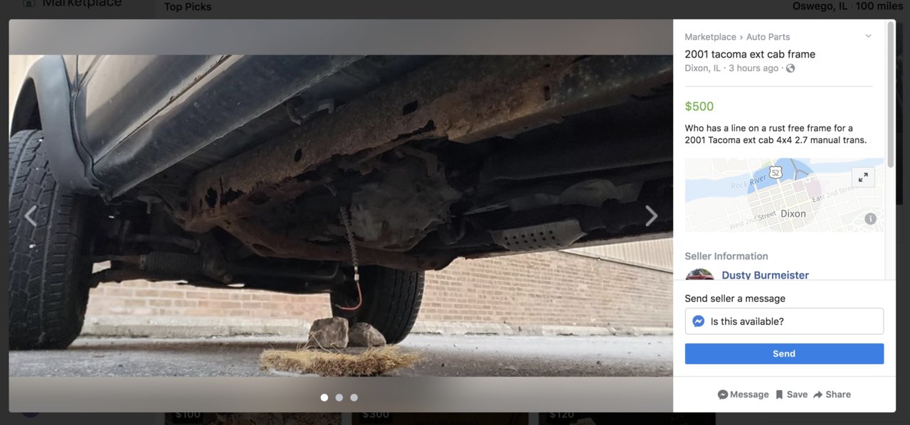

    Rustproof.

    it was Krown'd... Since its a unibody it has no frame underneath but what it does have is rust free. And it was my winter car so wasn't spared any driving in our salt infested winter roads...
