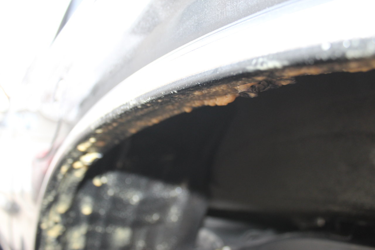

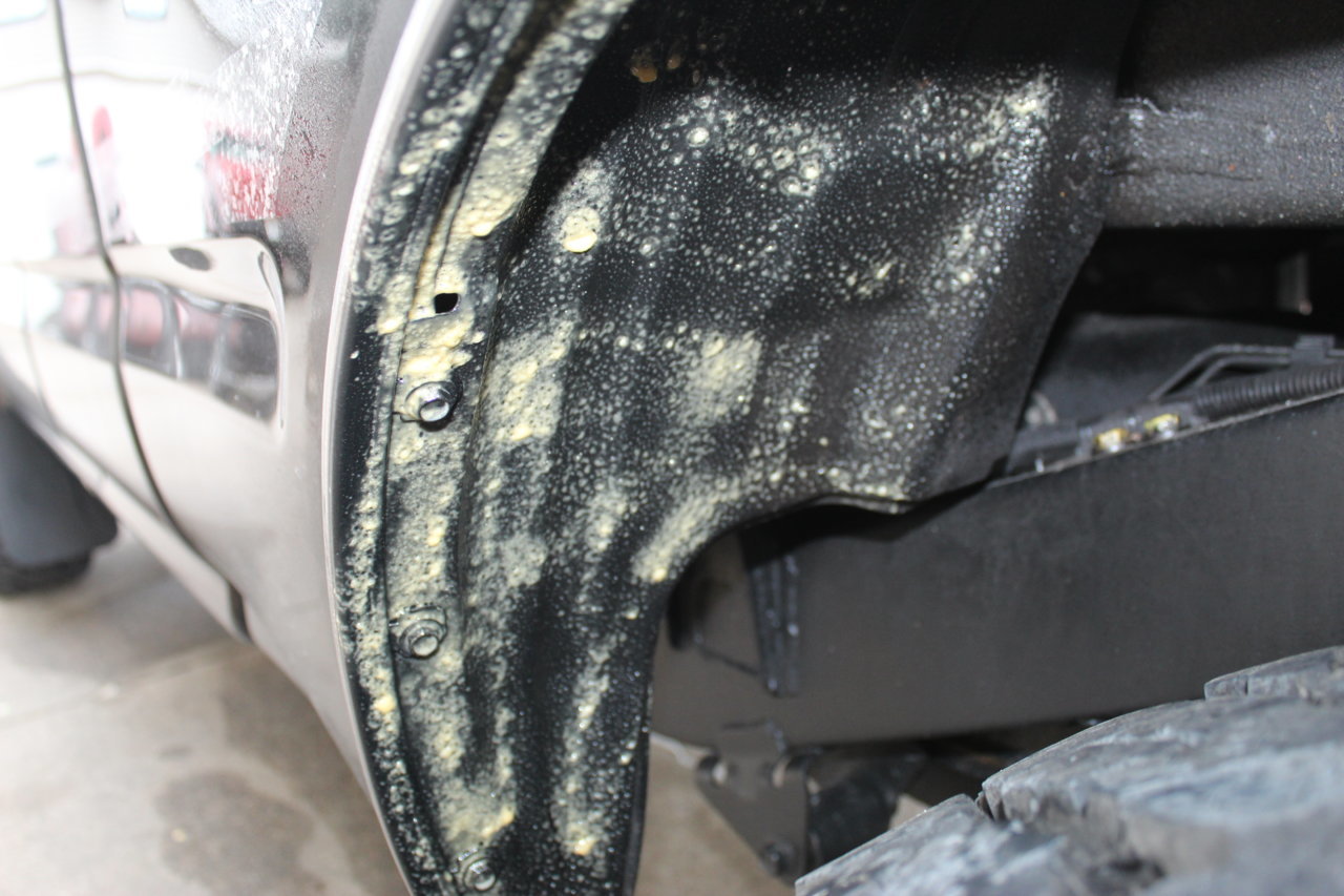

    i am attempting another FF treatment in the wheel wells as of yesterday to test out in the looming winter storm, first one of the season expected here on the MO river
    the Corrosion X HD is on the list to try out

    a guy from Chicago says this FF is going to stick so only time will tell
    i only used 1/2 a rattle can on it! all 4 wells
