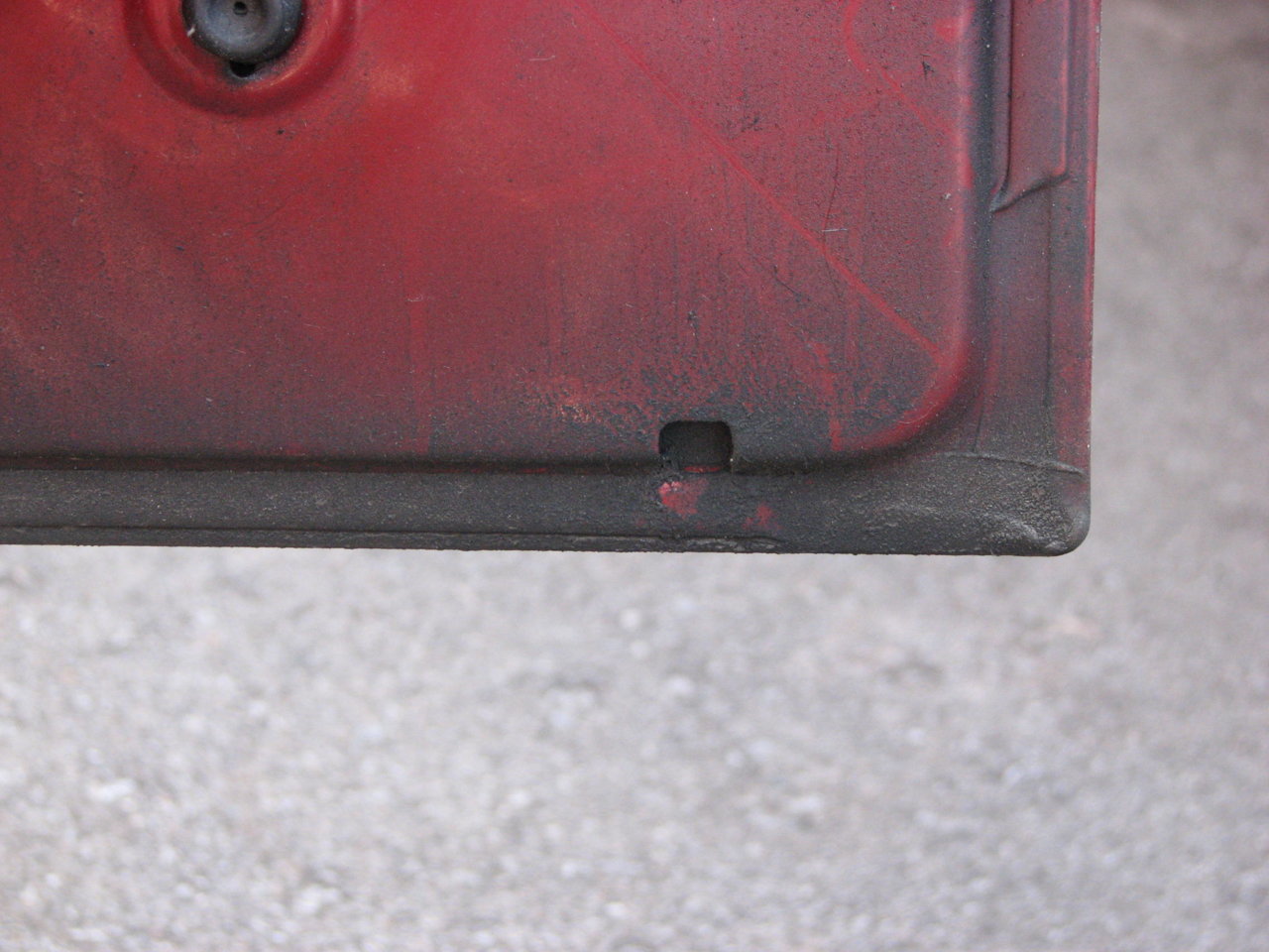

  16. May 3, 2020 at 7:02 AM
    #296
    babylon5
    babylon5 Well-Known Member
    Aug 19, 2015
    #162175
    914
    David
    2015 Tacoma Double Cab TRD Sport
    Also a fan of Krown.. I prefer this type when used in places like doors etc. Its thin enough that its sprayed in as a mist which get into and lubricate everything. Locks, window tracks , electrical connectors etc.
    And it doesnt harden like the waxy product that just trap moisture in the bottom of door seams etc.. (like superior and ziebart that i tried a long time ago but never again)
    It drips and creeps and gets into all the tight door seems.. Being heavier than water it fills the seams and forces the water out. If you live anywhere it freezes this is the deathtrap for your doors.
    once you have water in those tight seams and it freezes it opens up the seams, ruins/cracks any paint/primer that was there... And every year this accelerates till the bottom of the doors are gone
    the photo is of the door of my 2004 honda odyssey i just sold this winter. Went through 16 Toronto (canada) winters where there is almost more salt than snow.. And all the body panels are in the same condition, Seams 100% intact. . This is real world experience .
    My Tacoma goes in once a year at $140 Cdn..
    Some of the other product mentioned like fluid film etc look good as well and probably better on under body areas since they are thicker. . I would never use the old undercoat, its more of a noise reduction product and once it dries out and water gets up between it and the frame you are doomed.
