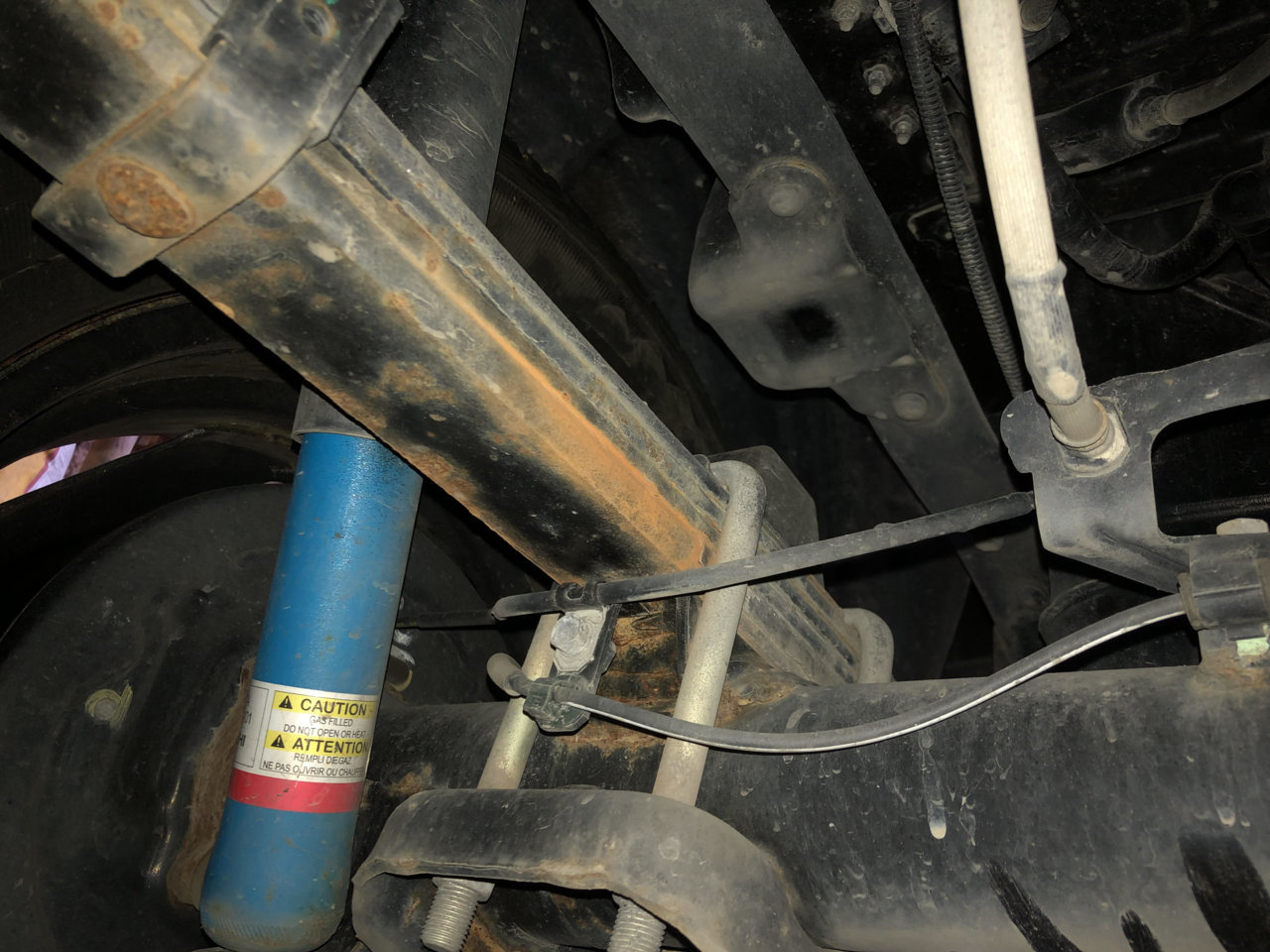

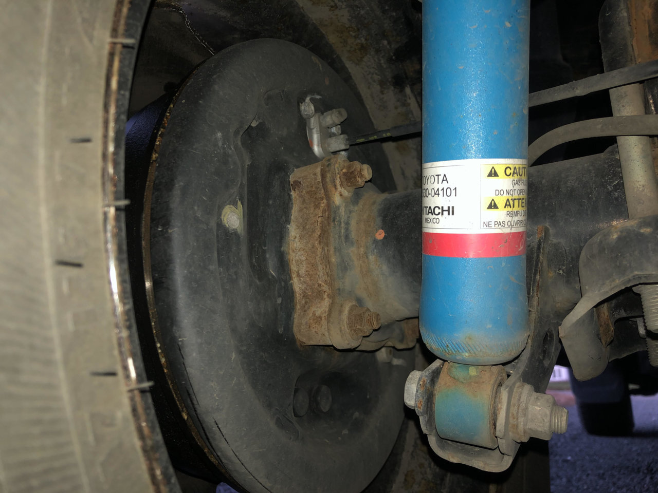

    Im only familiar with Fluid Film, not whatever product Toyota uses at the dealership. But as you say, it usually looks like a very thick oily wax type of stuff. Your truck looks bone dry in those pictures. Road spray from the tires can and does wash the stuff away over time, so good places to check would be above the spare tire, or deep in the channel / boxed sections of the frame. If places like that are also dry its a good bet they never did your truck. Take it in and discuss with the service manager. Im assuming you have receipts from last years 'treatment'?
    Personally I would just do fluid film yourself, but maybe the service manager will offer to do it for free this year in light of their oversight. But at any rate your truck still looks really good!

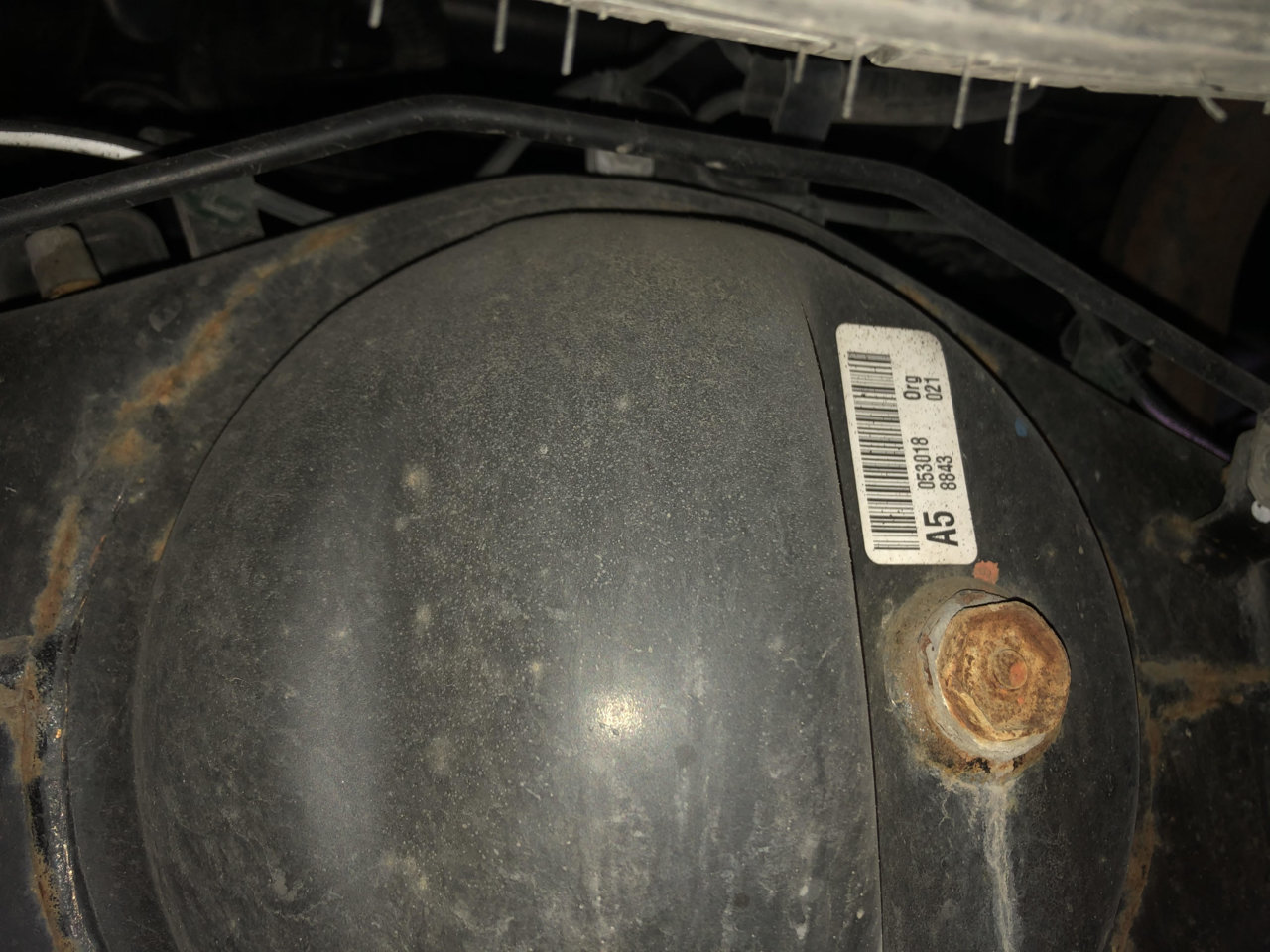

    Thanks everyone. Guess I'll be having a WTF conversion with the Service Manager on Monday. I've dealt with him before on another issue and he is very customer minded and reasonable.
    I did ask him if the rear end fill plug should be that rusty for a vehicle that was undercoated. His response was that he noticed that also and will check it out. I'm thinking that he's also questioning if the undercoating was done.
    SR-71A. The Toyota Rust Proofing and Undercoating is a one time application and comes with a warranty. Little known fact is that an inspection is required every 2 years to validate the warranty. Touch ups done as needed based on the inspection.

    Yours was not done at all. I hadn't he same treatment done at the dealer and it's a noticeable difference. They did not touch your under carriage. That's just terrible neglect from that dealer.
