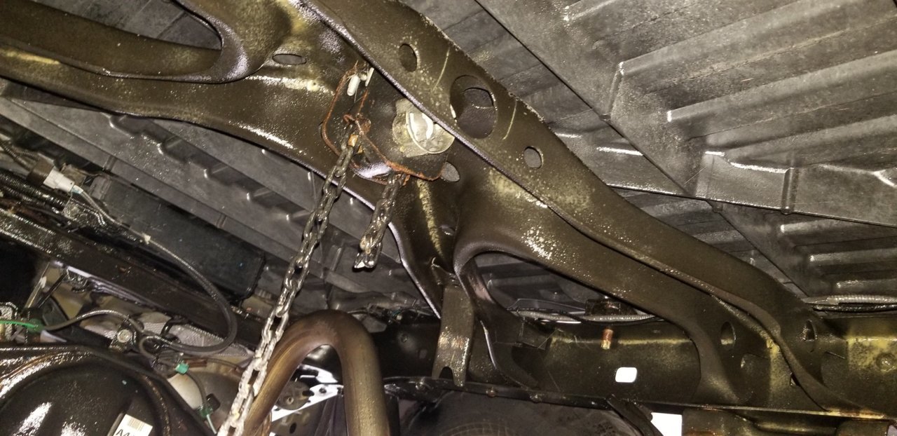

    thanks, i have probably another estimated six months of frame mod before i can use much of anything because i cannot paint over it!
    i was already told by someone in CA that i screwed up spraying FF on the near naked steel with a zinc coating
    and it maybe difficult to get the FF removed completely so that I can primer and topcoat it make it near good as good can get
    pricey is pricey, i think i have more than $1000 already into just tools and equipment to DIY fix my old tired tacoma

    Huh? Use a scotch brite pad, sand paper or wire brush or prep like you would any other metal surface before painting. The stuff is just a film it's not like it etches.

    hopefully its a simple removal of FF that i was attempting to prevent any flash rust, and does not get buggy in any pitted surfaces
    anyways i will need to re-blast a number of areas that i did not get fully cleaned on the passenger side last month and go from there
