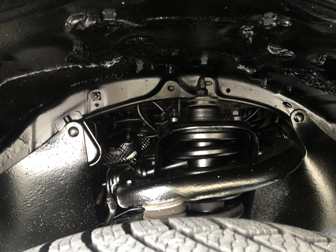

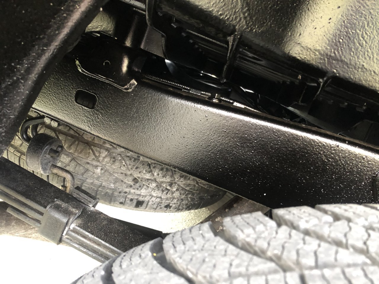

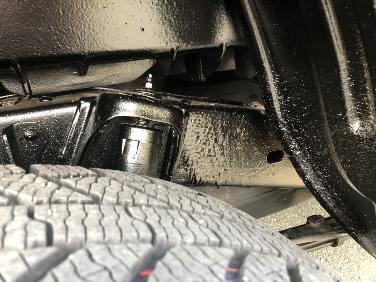

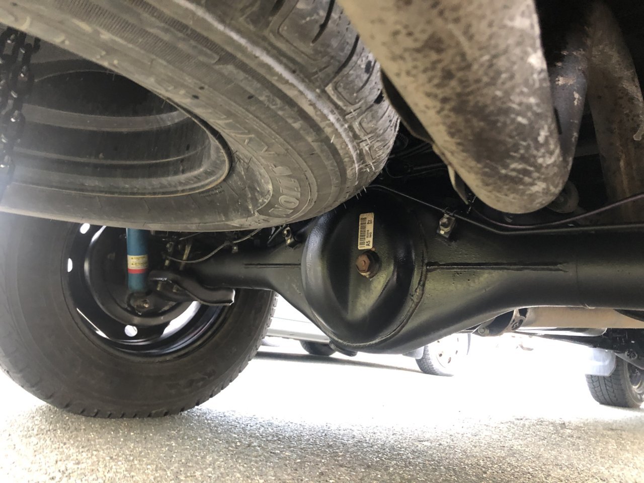

    Truck is back from the dealer. Service Manager came over to tell me that they looked the truck over and undercoating appeared to have been done when purchased. He acknowledged there were some areas that needed to be redone. Looks to me like that they undercoated the entire truck again. It's still wet - I put my figure in it - thick, black and tar like. I'm pleased with it.
    The rear end was sprayed with clear coat - the stuff they use as rust proofing the body panels. He said the undercoating doesn't last on the rear end because of the heat generated while driving.

    I hope you're not keeping that long term. That stuff is poison. Not trying to be a dick but in our humid salt filled climate that stuff is no beuno

    Is that Diamond Kote undercoating?

    Tar based is shitty yes, they got the vulcanized rubber nowdays. Looks like thats what OP got. Its an active undercoating, actually works well and lasts for long time.
