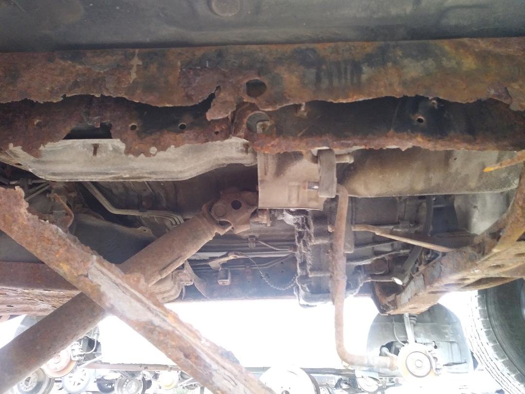

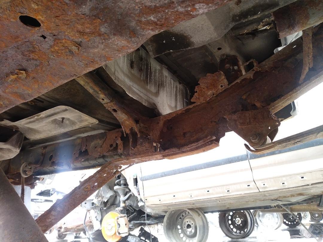

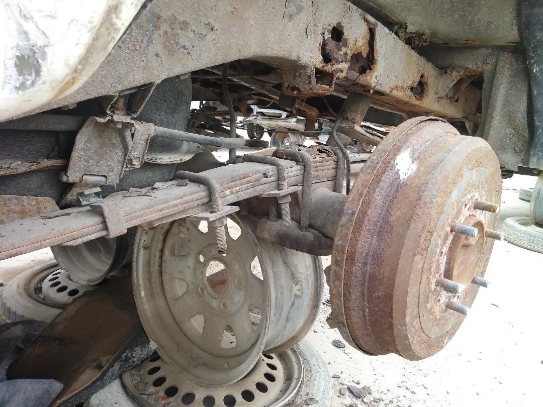

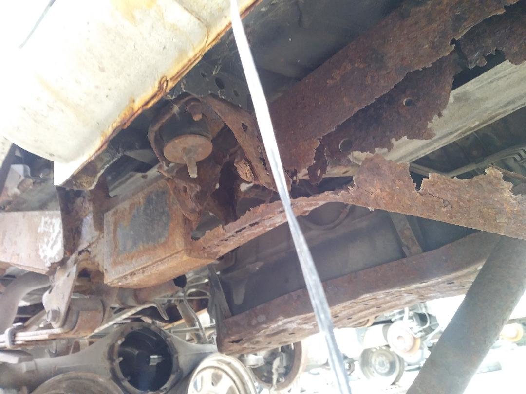

    i spent many winters at the wand wash hosing what i could reach in the numbing cold, but i was mostly concerned with the body panels keeping it all clean as i could
    these are some pics i got from the local salvage yard from a truck a month older than mine (03/97) and 100k more miles
    it was always registered in same town (per carfax) until it met its demise on the roads earlier this year with a police sticker to 'please remove vehicle from the road'
    Toyota does not put my area on the cold climate list and we have NO problems! nothing to worry about

    Looks new, is there some rust on it? ;)

    This thing was still on the road!?
    Im gonna have to use this next time I see a 3d gen guy in AZ complaining about a little bit of surface rust on the rear diff.... :duh:

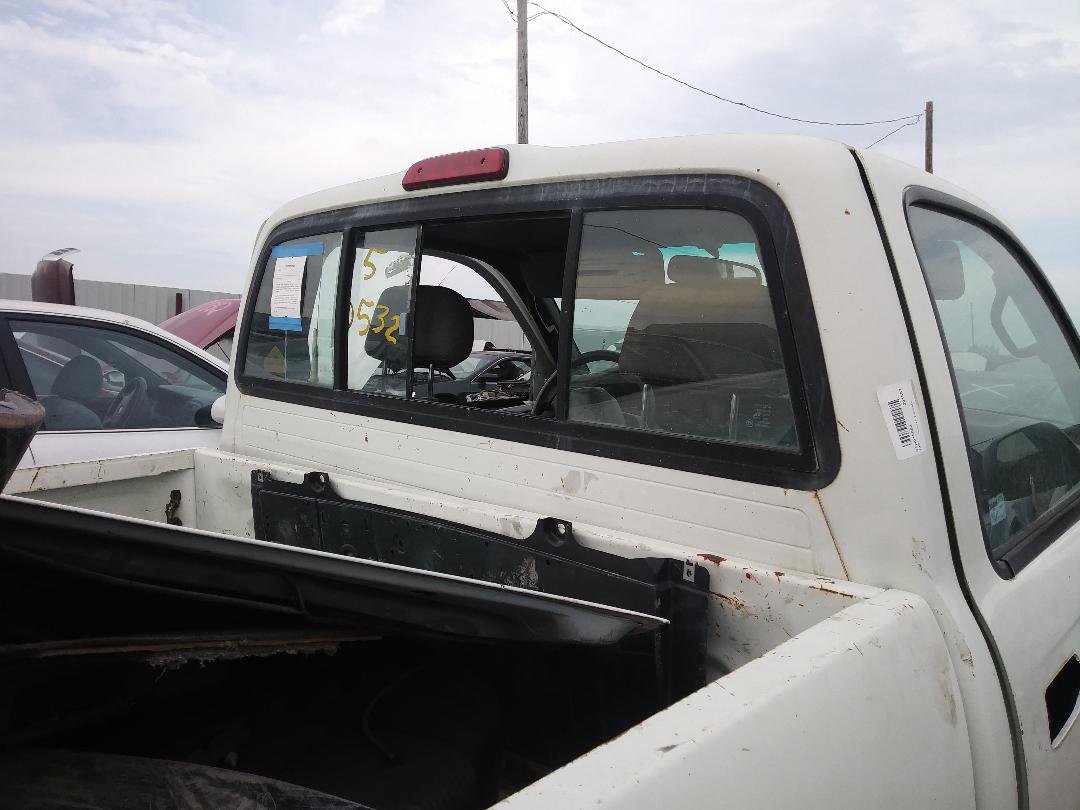

    as far as i know it was abandoned on the road here
    police notice in the back window
    no evidence of a collision, just a collapsed frame and suspension
    Big tall dave and SR-71A[QUOTED] like this.

    That's scary and also shows the inferiority of a Toyota frame!
    You can tell the frame metal is junk, I mean look at the pictures, even the heat shields are not rusted, those studs the hold them on rust Quickly up here
    My 2004 had huge holes in the frame and all body panels, even the rockers, were like new. That should tell them something

    this one apparently missed the buyback and crushing under warranty (or some other reason who knows)
    it had 3 owners that probably did not know anything about the issues going on 10 years ago
    i certainly did not!
    and never received a notice to get mine inspected, the Toyota service departments here really have no clue about this issue

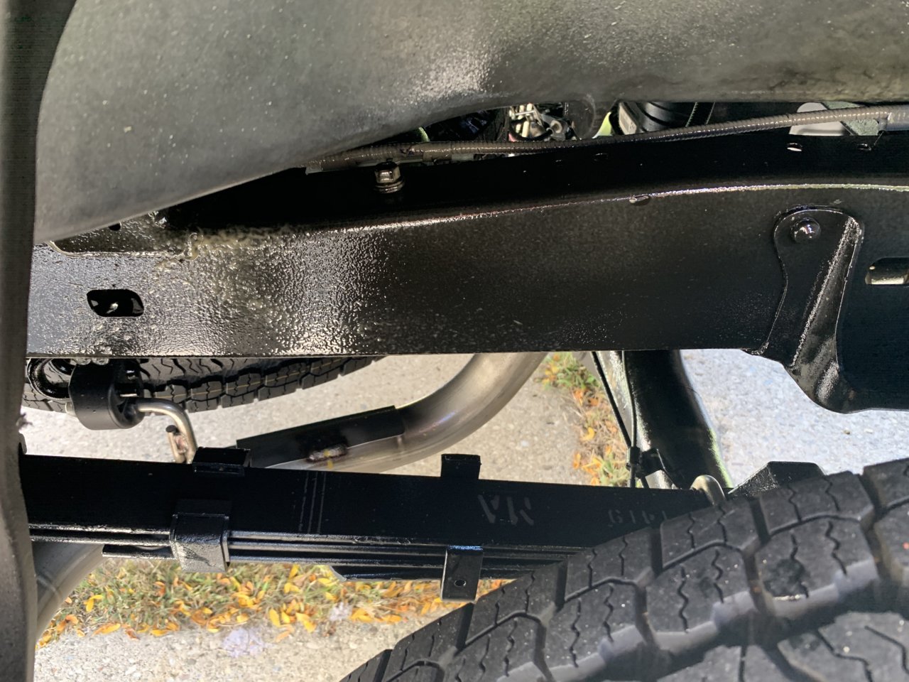

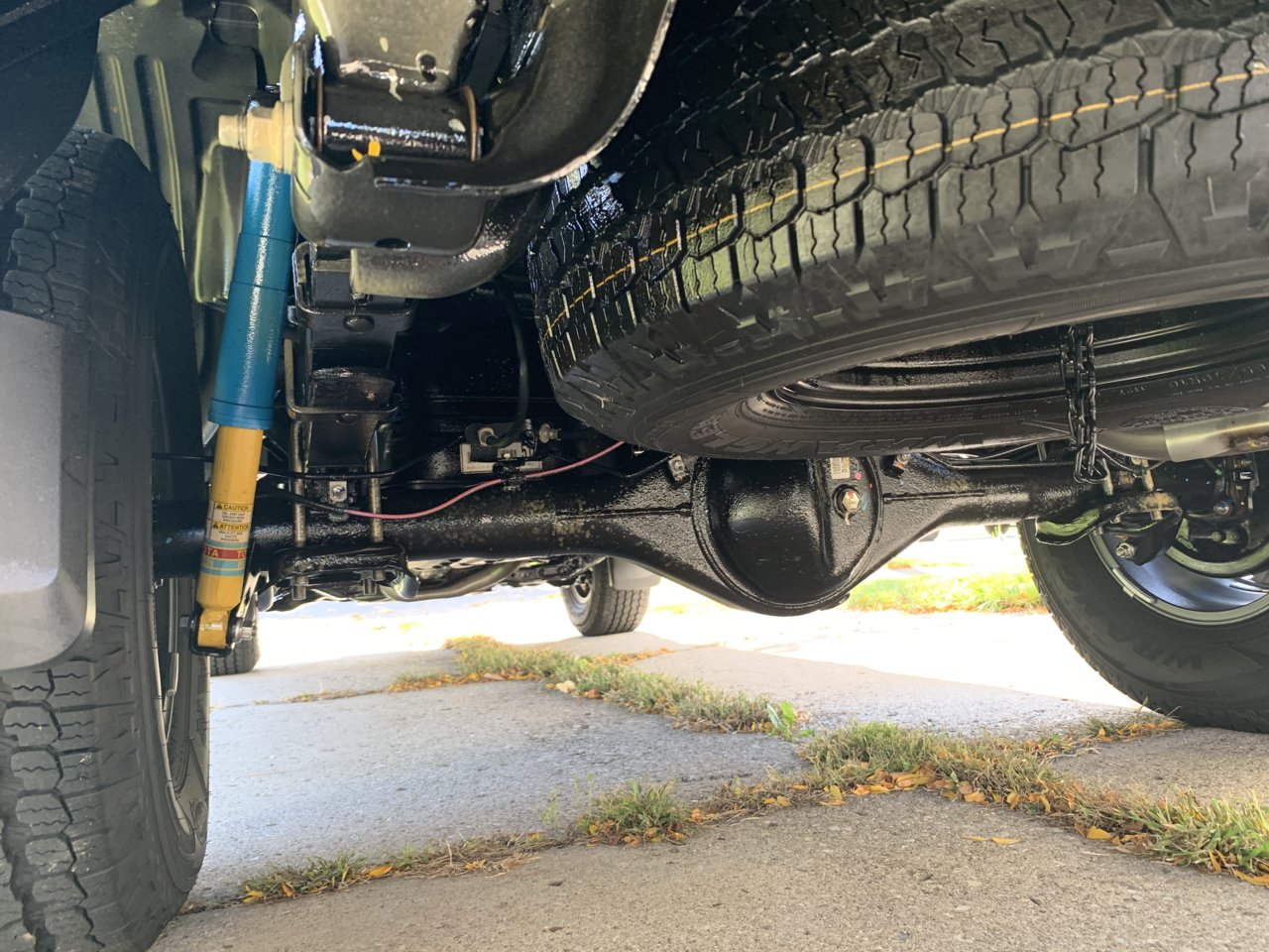

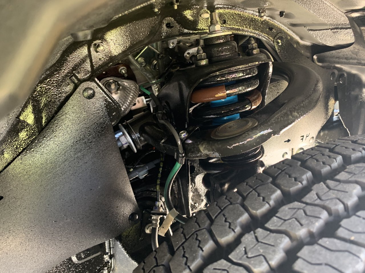

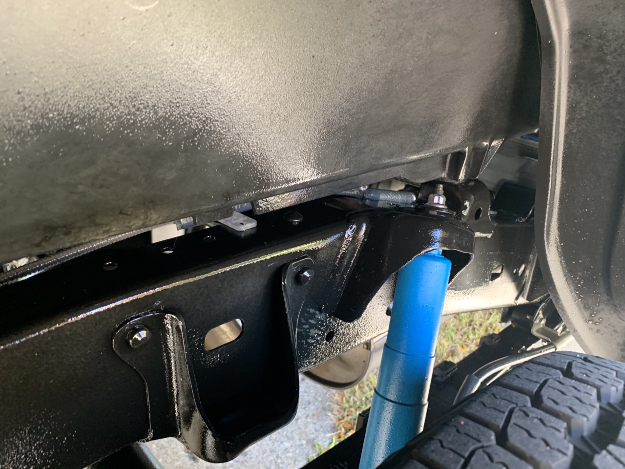

    I live in Western NY, I fluid filmed the crap out of mine before the first snow fall. I'll update in the spring. Also didnt feel like taking down the spare.. lazy me

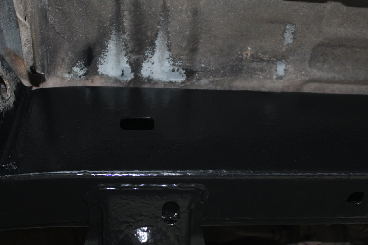

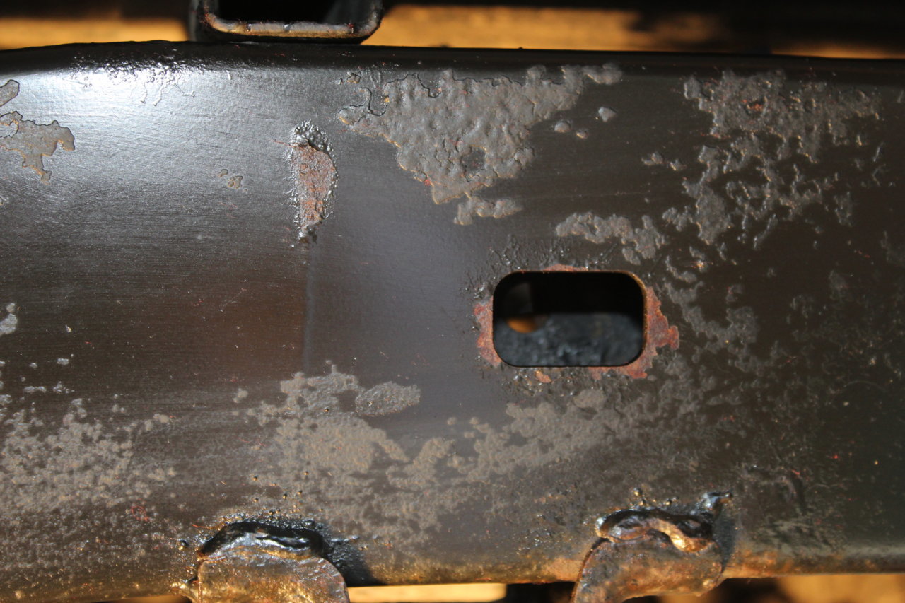

    not directly under the floor pan, under the bed or behind the rockers, there may be some scattered gravel or rock chips & cracks but didn't seem to be real bad under there after a quick look
    those bare silver spots on the floor pan are ricochet from the blaster gun cleaning the frame down to bare metal, I just sprayed some FF on those spots until i figure out what to do about it, touch it up or redo it with new stuff because the old coating seems very brittle.
    in the wheel well the coating had worn off over the years from the power wand sprayer at the wash
    the halogen light really brightens the bad spots starting to pop up
