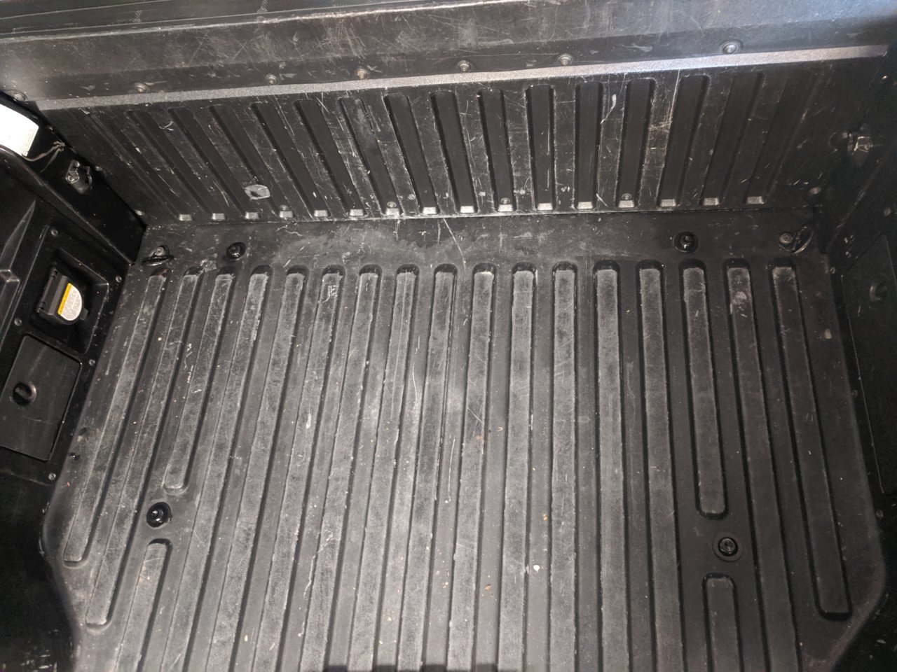

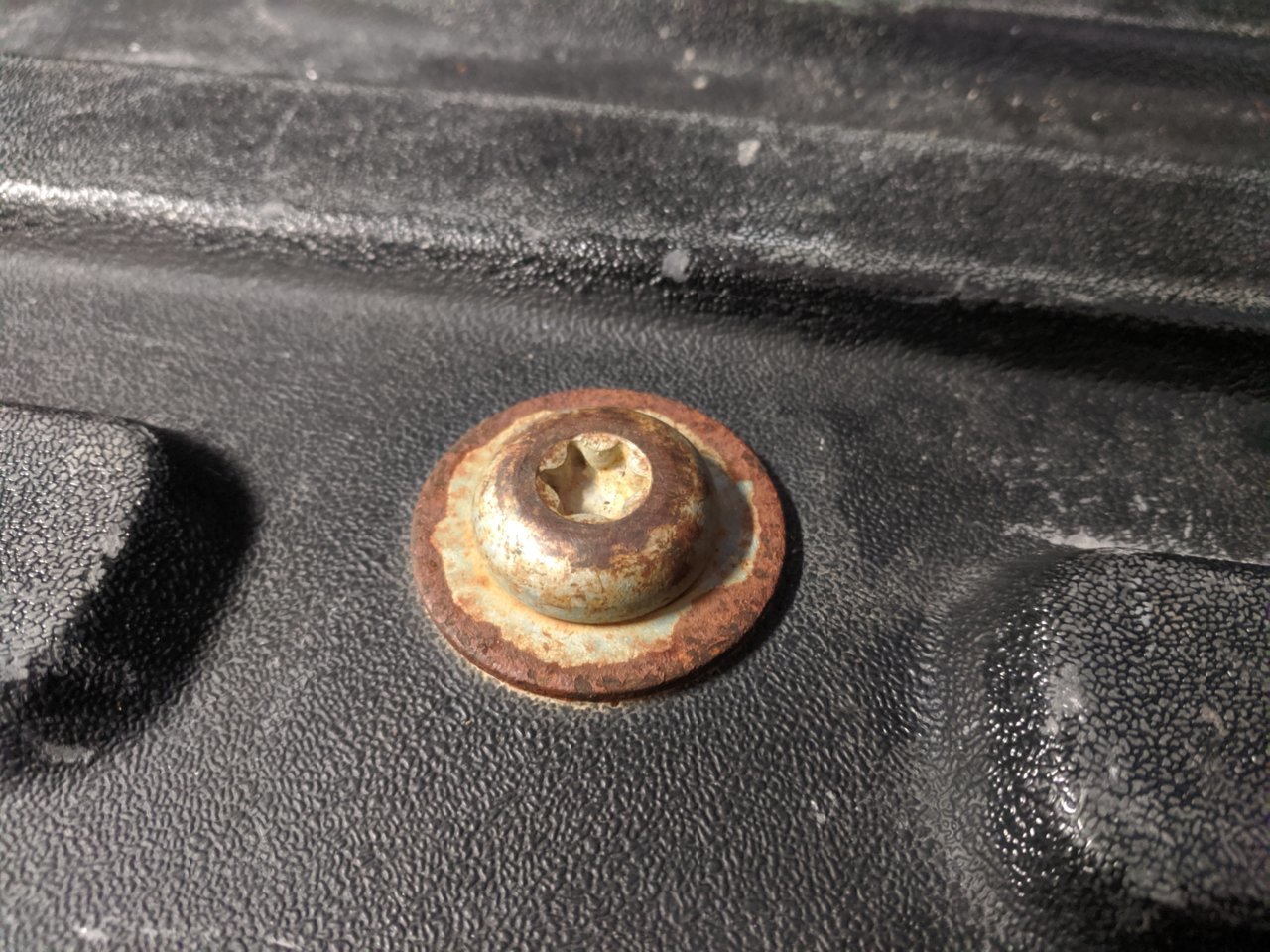

    Here's a quick & dirty hack for concealing rusty bed bolts in your 3rd gen. I'm in northeast Ohio where the winter road salt attacks bare metal in any form, anywhere on your truck. I couldn't stand looking at these things, despite my bed being a bit scuffed up otherwise. They stuck out like 6 sore thumbs.
    1. Wash & dry any area you want to attack

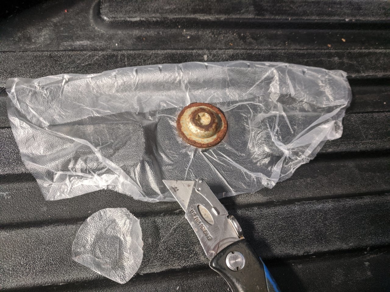

    2. Use some press 'n seal cling wrap with a sharp blade to mask off the bolt heads and limit the overspray to keep things looking somewhat tidy.

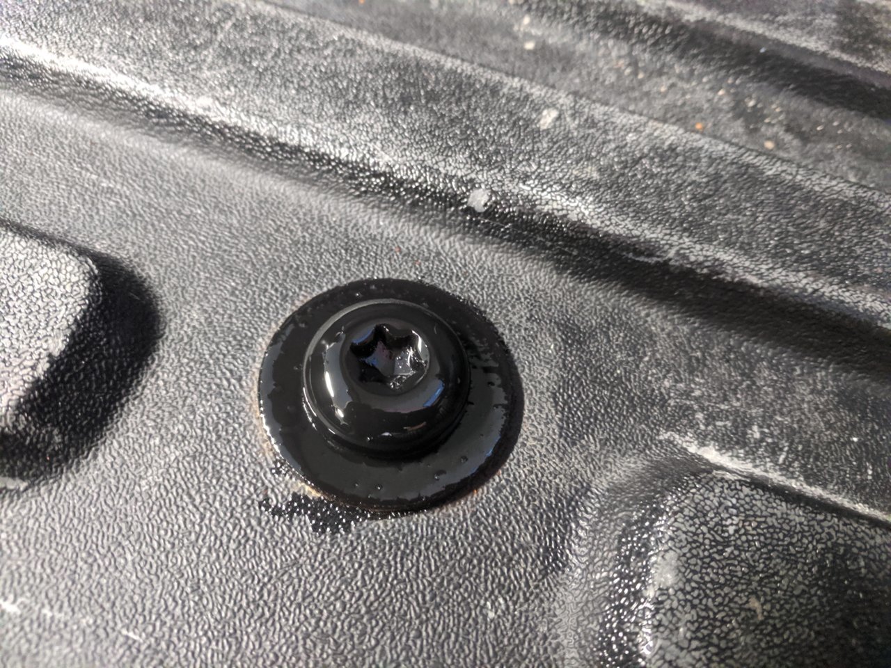

    3. Grab your favorite rattle can - this should work with anything - spray paint, plasti-dip, bedliner, etc.
    4. A few shots on the bolt heads and those rusty nightmares disappear. The same piece of cling wrap can be re-used for all 6 bolts.
    The whole process took all of 8 minutes to hit all six bolts and cost $0! ...so long as you have some old rattle can in the garage and some press n' seal in the kitchen.
