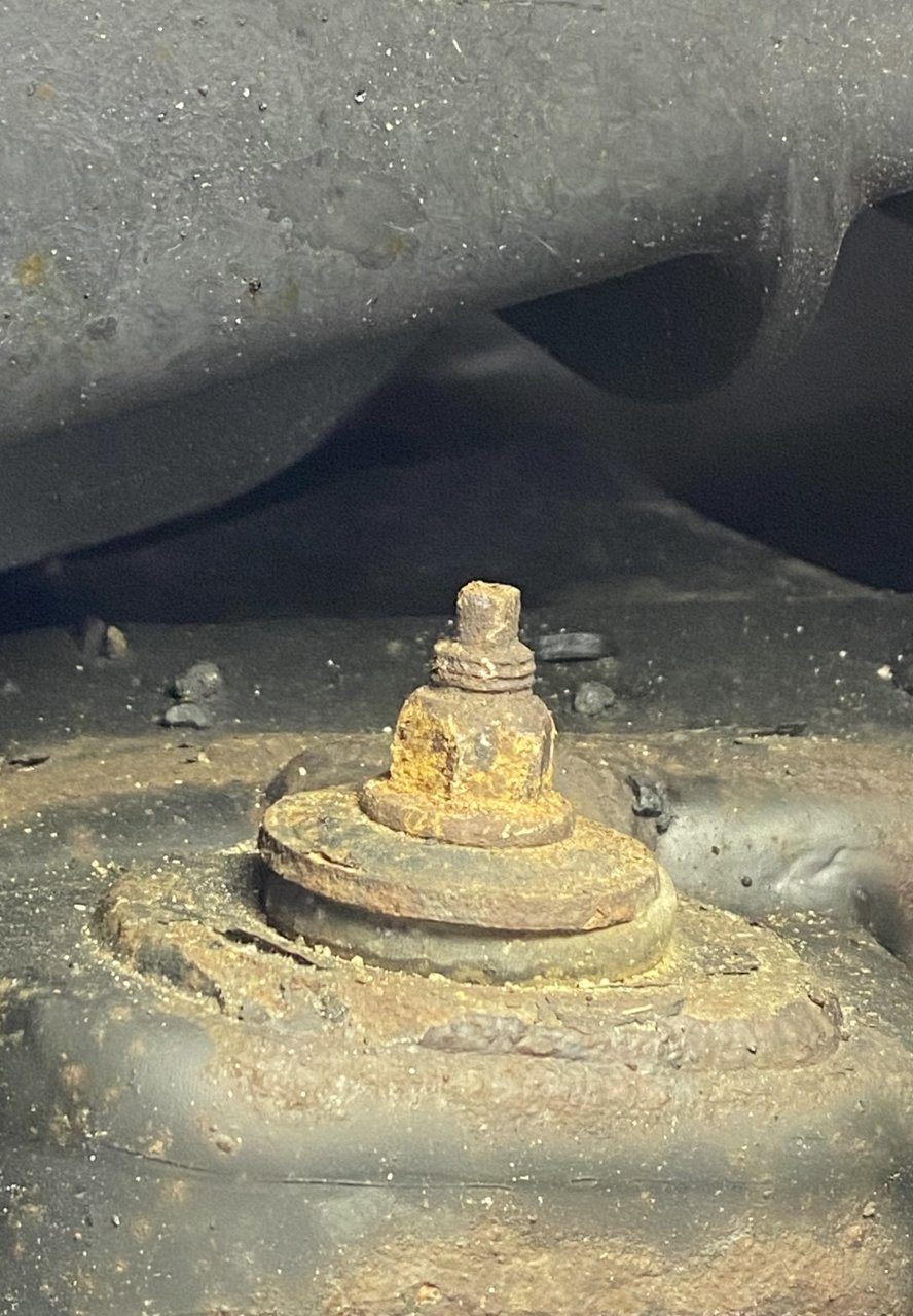

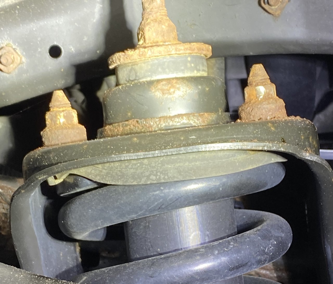

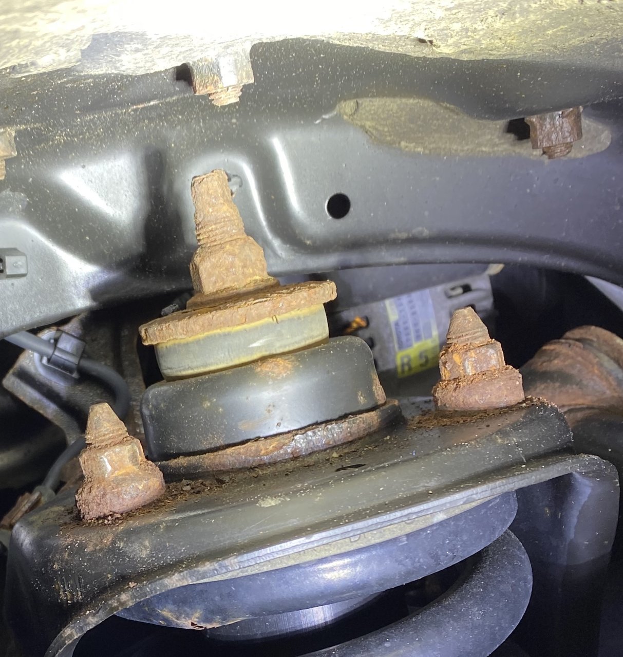

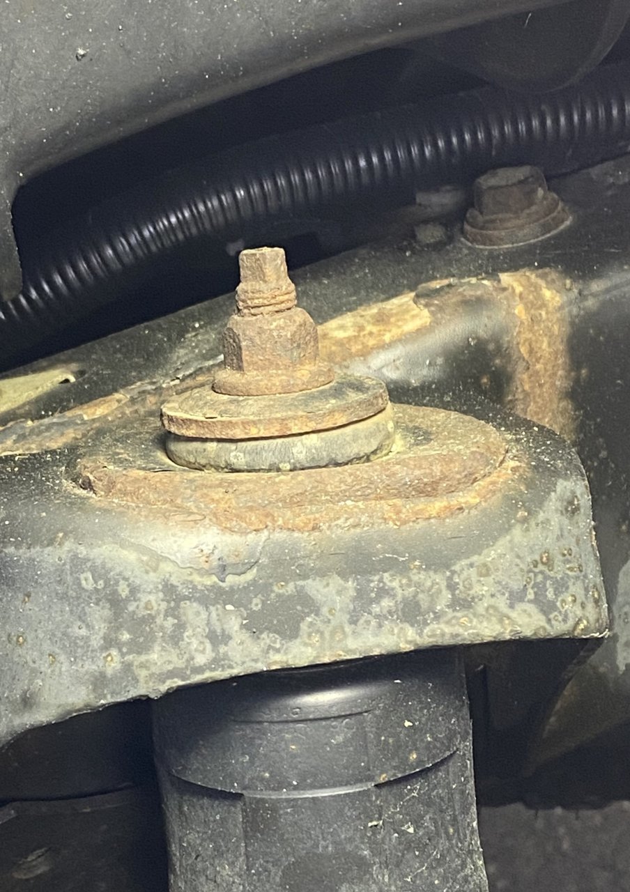

    2B9F95AA-8E8B-40BC-9444-A91EA248FF00.jpg 4CDA84B8-E7E3-4154-962C-4DAAE230AE15.jpg 72534F8C-BB1E-487D-93E9-B1E7C9CEA110.jpg getting my new suspension delivered in the next 2 weeks or so. I knew my shit was rusty, so tonight I figured I’d go see just HOW rusted on everything is. I started to strip just about everything I put a wrench on, so I just stopped messing with it. I’m going to get a couple wire brushes, clean everything up as much as possible and hit it with some PB Blaster. Wash rinse and repeat a couple times until all my stuff comes in. Just figured I’d come here to see if anyone has any other ideas/insight/suggestions. The strut assembly nuts, and the rear shock mount bolts are going to be the only thing holding the whole process up. I may go buy a torch tomorrow too. 3A189E96-1C26-49F7-80A0-61243E792DD6.jpg

    Your plan is exactly what I do.
    Penetrating Oil, brush, repeat.
    I probably replace as many of the nits and bolts as I could, to reduce the risk of stripping them on install.

    Yep, spray, brush, spray, brush, soak. After about a week of this, try putting a good 6 point box end wrench on them and go easy. Don't worry about the top hat nuts, just the strut and shock mounting nuts. You'll get it.
    Before I resorted to cutting them off, I'd even use a little heat, in moderation.
    Keep us posted!

    Hey OP, as someone already suggested, you can cut off those rear bolts. IIRC, I used a reciprocating saw on the area surrounded by the rubber bushing (it was about a year ago). Someone please correct me if this is an unsafe practice because I don’t want to give out bad suggestions.
    Used a hacksaw blade and took about 5-10 minutes, allowing some rest time so the blade and saw didn’t get to hot. Good luck!

    For the rears I would just cut the top off either with a sawzall or an angle grinder.
    The front, I'd just continue to soak with a penetrating oil every day leading up to the install. I would also go buy a 6 point wrench (you need 14mm). These have a lesser chance of rounding out the bolt vs a 12 point. A 9/16 wrench may even be better because it's 14.28mm and will give you the tiniest bit of extra clearance to get over all that rust.
