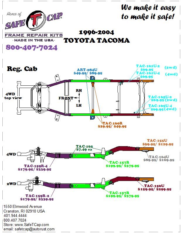

    Not sure if I’m reading the chart right, do they make caps for 2WD regular cabs?

    Check out the Website !! To see for sure the 2Wd will have it`s own page if they make them.
    You have the 2WD 5 Lug wheels truck not a prerunner.
    Yes check the AutoRust Website There is a listing.

    YES

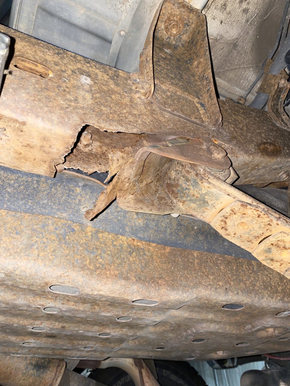

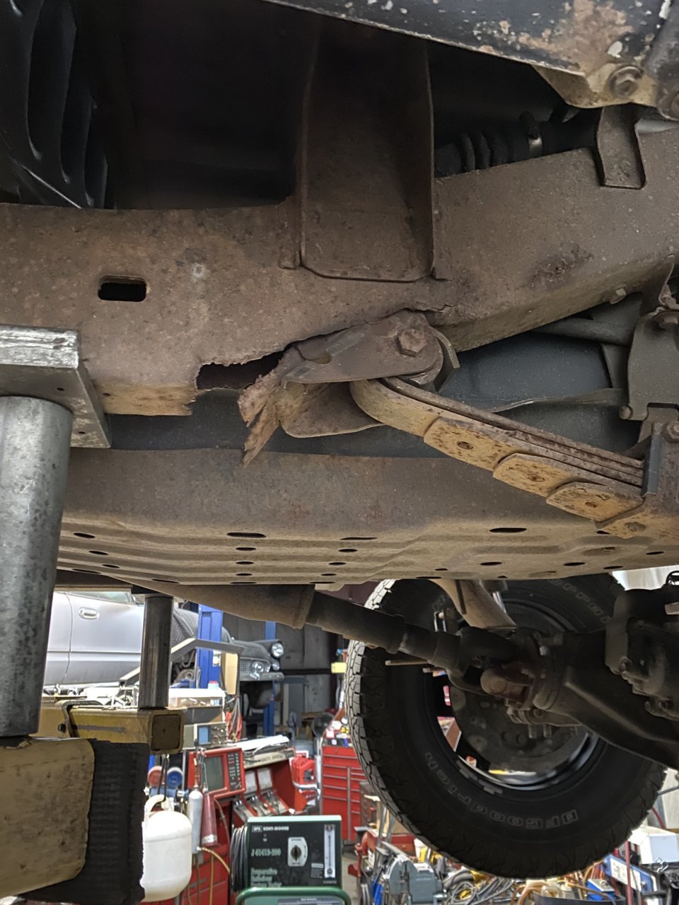

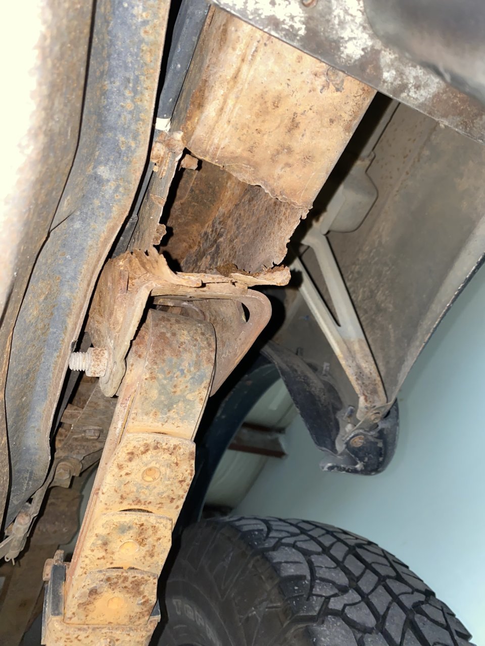

    So I was able to talk with my mechanic and he said that he’s going to do some research and he might be able to fix it using the frame caps. Now I’m waiting on a quote and hopefully good news. The picture I posted was one he sent me, so when I went to look at it I took some of my own as well. Here are those pictures for anyone who wants to see. I still can’t believe I was driving around with the damn thing like that

    You never heard any banging as that moved around??
    Or were able to feel a difference in ride or handling??
    look at the other side real close.
    Good Luck!

    I did hear some clunking going over speed bumps, but it sounded exactly like how a U bolt sounds when it goes bad. It drove like it needed an alignment which is part of the reason I brought it into the shop. But the fact that the spring is barely on there is probably why it didn’t drive straight. Besides those things it drove pretty decent.
    I’ll definitely check the other side really well, as well as the frame under the bed. I might end up buying these to go back there depending on how bad it is

    The caps are the only way to go for something like this. I would not try fabricating this unless you are really good at these sorts of things.

    Quite different if your buying them to save the end user labor $380.00 plus shipping
