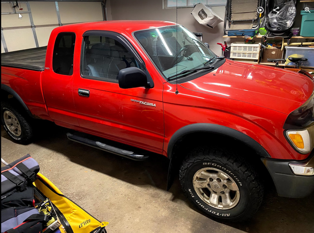

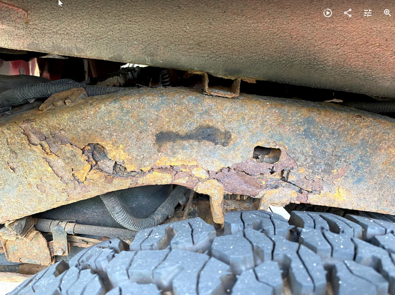

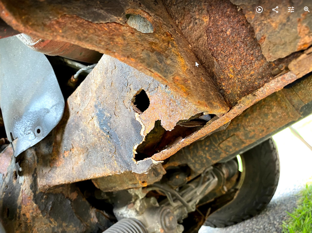

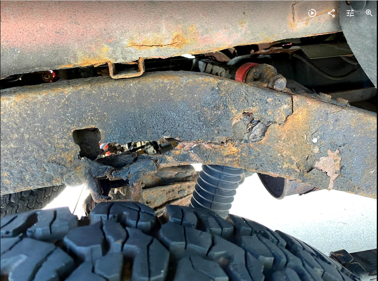

    Hi All,
    Wondering if anyone can help as I just spent 6k on a 2000 Tacoma extended cab. The truck appeared in great shape with minimal rust on the body. After purchasing from a private party here in Minnesota, have discovered the frame is completely rusted and there are holes in the frame. The vehicle is unsafe to even drive.
    After doing some research and learning about the recall and issues with these frames in cold climates where salt is used I was able to learn from my local dealer that they replaced the frame under the extended warrantly/Recall in 2011. Given that they replaced the entire frame in 2011 I'm literally shocked that it would have completely rusted again in 10 years!!??
    I've contacted Toyota and even had my attorney call but they deny any wrongdoing and called me back saying you have no recourse and we are not going to return the call to your attorney. Since that call my attorney is working with me to file a complaint with the attorney general.
    I'm wondering if anyone else here has experienced this issue where the frame was replace and then rusted out again in a relatively short period of time. It's obvious Toyota just put the same defective frame on the truck when they replaced it.
    Anyway would be great to hear of others have had this problem and what they did or if we should consider contacting Toyota as a group and filing a class action.

    I could be wrong, but I feel like I hear people getting donor trucks for engine or 4wd swaps for around a grand. Looking the photos, the entire underside, including the drive line, is rusted.

    Not going to lie, that frame looks to be approximately exactly 21 years old. Not sure how you're going to make this worth your money. The first step might be acknowledging a very valuable lesson.

    Not to be the one, but how did you miss the huge holes right above the rear tire? If you did not see that, what did you check before making the purchase? As far as getting something back, images_099d6fcf02a2e8579db1b1e4b7698d82e463a5f9.jpg

    Ok first, you need to do more research. The frame thing is NOT a recall. It was an extended warranty. Owners had 15 years from the in-service date to deal with this, regardless if the frame was replaced under the warranty. That has long since expired for all 1st gens, especially your 21 year old one.
    But let's do some math: The frame on your 21 year old truck was replaced ~10 years into it's life. And now, that same amount of time has passed, and you're surprised it's rusted again? The replacement frames were identical to the old ones. They weren't magically impervious to rust.
    As far as if anyone has experienced this. Yes, many. This is a well known issue.
    Sorry man, this sucks.
    But in the end, this should be a MASSIVE learning experience: a $6000 lesson. You can very clearly see the giant holes in the frame though the rear wheel well just standing next to it. I mean... yikes...
    Every car I've ever bought (used and even new) I get under it and look for rust and corrosion, and this was long before I ever knew about the Tacoma frame rust thing, and I live in sunny CA where rust isn't even a "thing" for the most part.
    If you don't have the expertise to do that, pay a mechanic to do it for you. Best ~$200 you could spend, especially when it saves you from making this kind of mistake.
    Private sellers have almost NO responsibility to ensure the vehicle is in working condition so it likely doesn't matter if the seller knew about the rust or not. That's on the buyer.
    DO NOT DRIVE IT.
