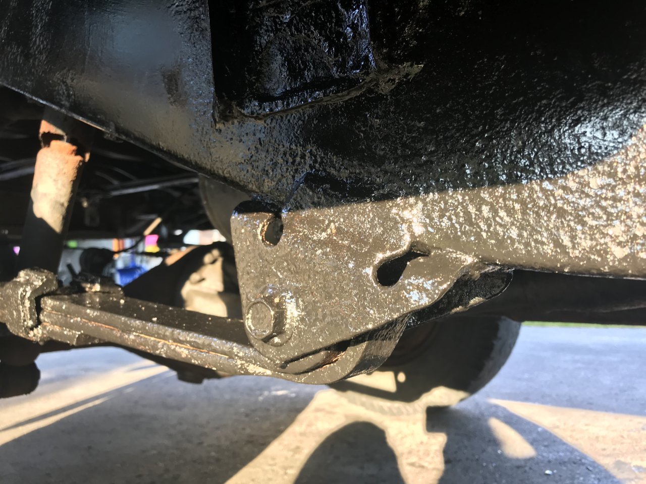

    i used safe T caps, POR-15 paint, and fluid film on my 2002 Tacoma recently for a frame restoration and it worked really well.
    before
    after
    Frame Holes that needed safe-T-cap
    safe-t-cap
    Roberto123 likes this.

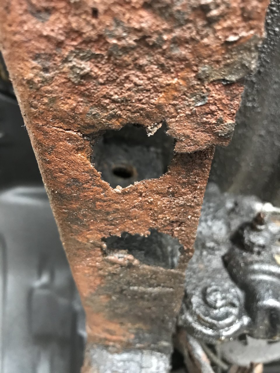

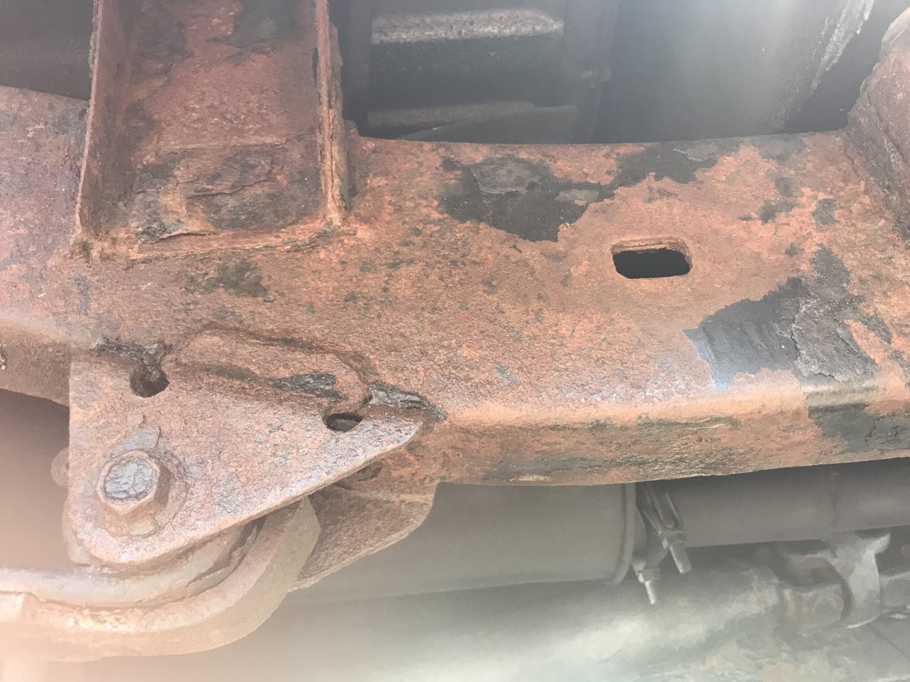

    When someone posts rusty frame pics, being from the rust belt I am usually the one saying "it's not that bad, you can probably drive it for several years...". This is because 2 of the 3 1st gen Tacos in my family have had pretty severe frame rust and were driven quite a while that way.
    But, I have to say, the pics you posted are enough for me to say don't drive it. That right rear area is done. And I suspect the front of your rear spring mounts, while not pictured, are likely ready to break. That's when the whole rear section will become unattached.
    You're just gonna have to decide whether to replace the frame or part it out. Lawsuits will be fruitless unless your State has some recourse that most don't.
    Frame replacement is likely not feasible ($$$ wise) unless you can do the work yourself. In parts, you are probably looking at $6000.
