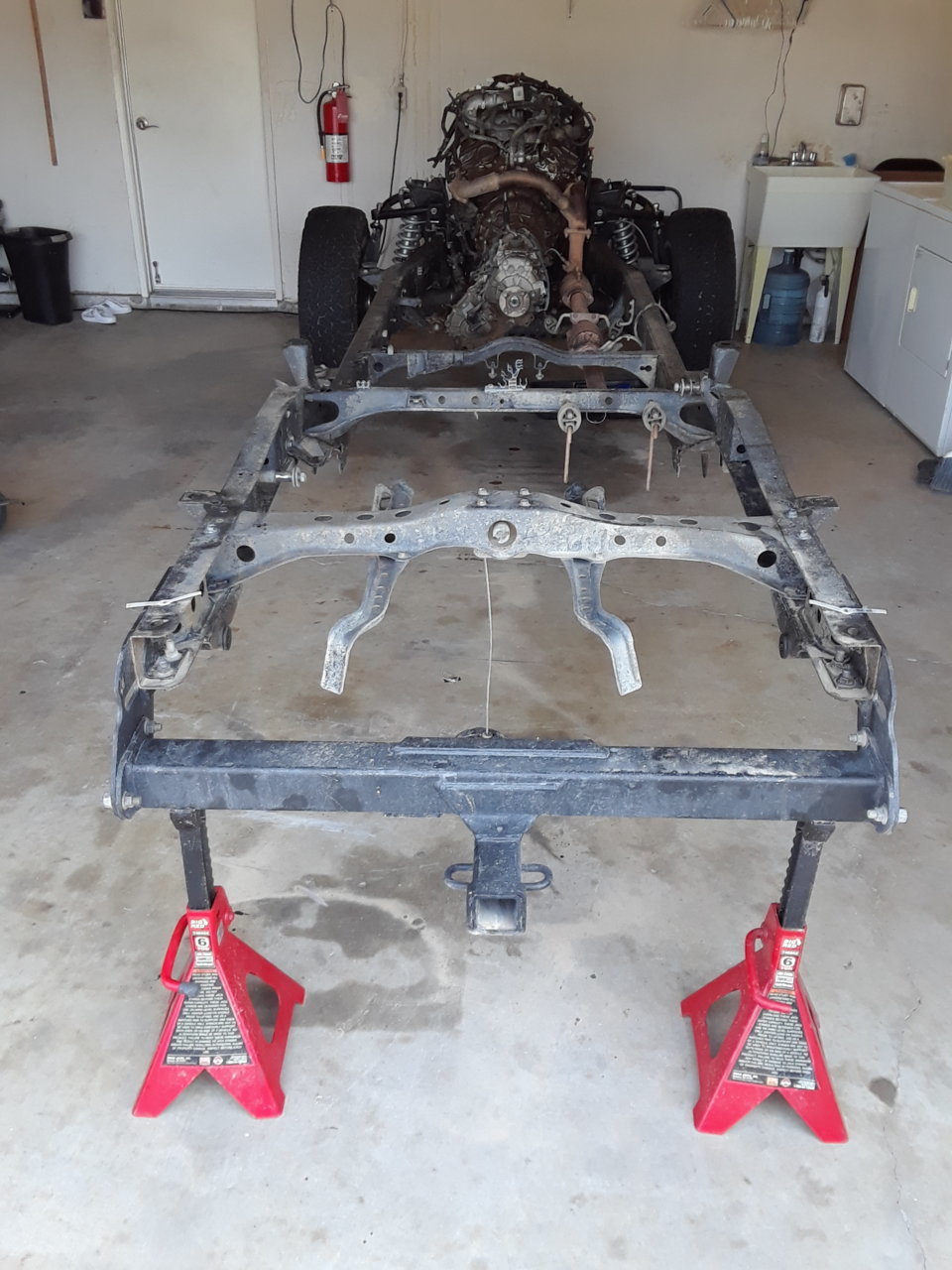

    Quick update: My mother really wants to keep the truck and has decided she would like to see if we can replace the frame. We’re going to try to buy a rolling chassis with the full frame all the suspension parts, gas tank etc. and have a body guy install the body of the truck onto the new chassis.
    Is it worth it to go thru all this and potentially sink another 5-6k into it?

    you'll most likely never recoup that much money invested in the truck. But if your going to keep this truck forever, and pass it down to other members of the family, then I say do it. I'd only go this route if the body and interior are in really nice shape.
    In the end, it's really up to you, keep the truck, or sell it, or part it out.
  19. Sep 8, 2021 at 7:38 AM

    If you have to ask, probably not. The only people(on here) that seem to be up for the task of swapping frames are incredibly mechanically inclined.
    However this will hold value and won't be tanking like buying a new or couple year old truck. Having an actual new frame is a huge selling point down the road and piece of mind.
