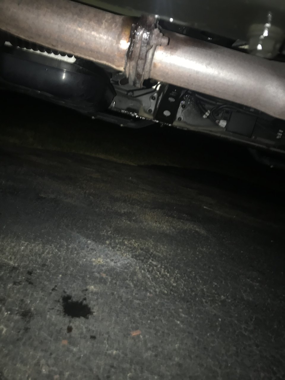

    Hey guys,
    Quick question. When I was fluid filming the undercarriage yesterday I realized the flange (I think that’s what it’s called) that connects the exhaust is super rusty and has a small super slow leak when the car runs (see pictures).
    Im wondering if I should replace the flange or possibly the gasket inside? Maybe just get a MBRP lol $$$ ‍♂️
    I was a sucker and bought all the warranty’s when I bought the truck. Only 26k miles currently. So we’ll see what the dealer says when I call them mañana.
    Any advice / suggestions would be appreciated!

    My knee jerk reaction is that it looks like what most newish exhaust pipes look like in the rust belt. Consider yourself lucky that it's not full of huge holes and hanging down and scraping the ground.

    I never got more than 10 years out of a stainless exhaust system, usually much less here in connecticut. Back in the day when they were plain old steel, 2 years and they'd be leaking. Short trips is the biggest exhaust system killer here in the rust belt.

    RE: Short trips
    When you start the truck from cold the the moisture in the air condenses in the pipes and also makes steam out the tail pipe. On a short trip the engine and therefore the exhaust system don't achieve full operating temperature. This condensate is somewhat acidic and corrodes the pipe from the inside out.
    On a longer trip the system is hot enough to completely bake any moisture out of the exhaust.
    In your photo showing the black drip spot had you just started the truck? If so there probably is nothing to worry about, if you check with the truck fully warm (15 - 20 miles of driving) you will probably not be able to feel an exhaust leak at the joint.

    Thanks for the detailed reply. That’s correct I had just started the truck. Really appreciate the explanation thank you!
