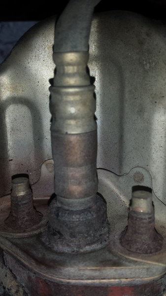

    Oh boy very relevant. Check out this o2 sensor. Discovered this today while trying to change it out. No idea where to go from here.[​IMG] So far everything else I've handled with acetone+atf, vice grips, and a sawzall. IMG_20150815_093830.jpg

    Been there all to often !!
    If your lucky you can get the studs out and replace them
    Living in Pa I keep the oxygen Sensor bungs on hand trying to drill out studs and replace takes way to much time.
    I can cut the old one off and weld a new bung in faster ..
    Then if I want to frustrate myself try and fix it later for fun most just pitched in the scrap
