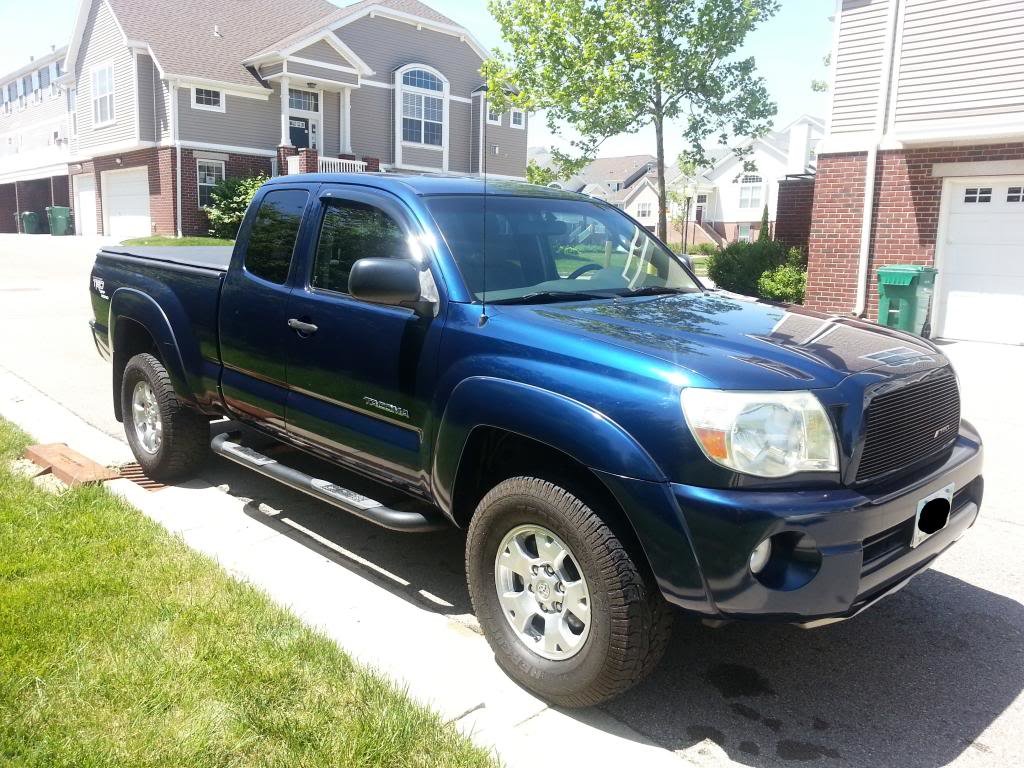

    06 A-Cab TRD Off-Road 4x4

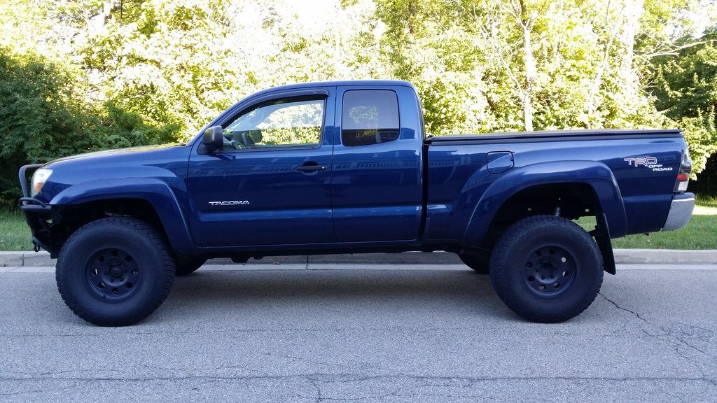

    Before Photo
    Wheels
    American Racing Mojave 16"
    Nitto Terra Grappler 285/75R16
    Gorilla Locking Nuts
    Suspension
    All-Pro UCAs
    Fox 2.5 Non-Res Coilovers
    All-Pro (Apex) Expo Leaf Springs
    Fox 2.0 Non-Res Shocks
    Timbren Bumpstops
    Crown Performance Extended Flex Hoses
    Lift Increase:
    Front Driver - 3-1/4"
    Front Pass - 3-3/8"
    Rear Driver - 4-5/8"
    Rear Pass - 5-1/8" (saggy OEM leafs)
    Armor
    4xInnovations Hybrid Front Bumper
    Viking Bow Shackles
    KB Voodoo Tailgate Cap
    Performance
    Stock
    External Lighting
    CSJumper LED Headlights
    TaoTronics LED Fog Light Pods
    Elusive Elements Light Bar
    Kragen 7" HID Lights
    AnzoUSA LED Taillights
    Internal Modifications
    BlitzPro Fog Light Switch
    BlitzPro Rear Diff Locker Switch
    BlitzPro Off-Road Light Switch
    Sound System
    Pioneer AVH-X1600DVD Head Unit
    Power Acoustik GT1-1600 Amp
    Pioneer TS-W260S4 Subwoofer

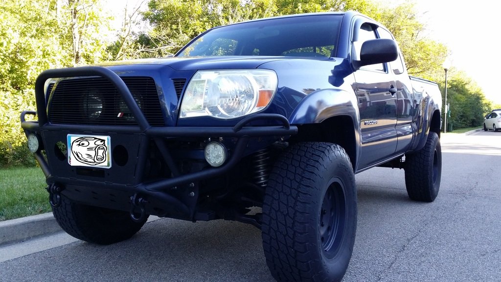

    Current Photos

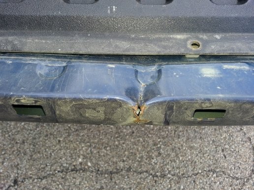

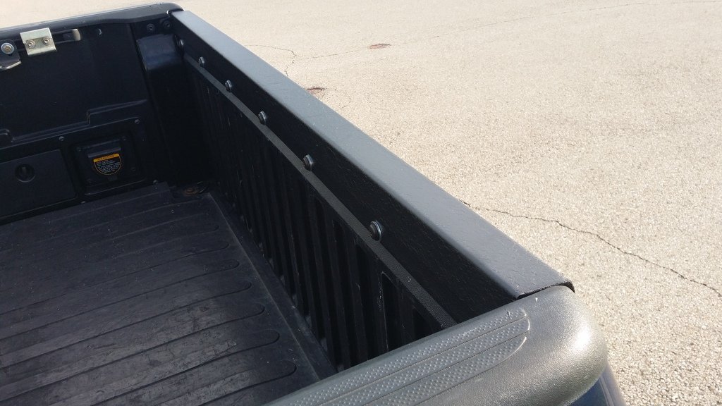

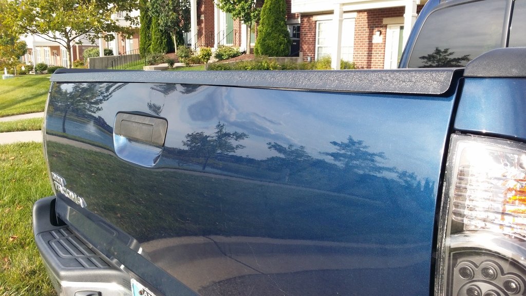

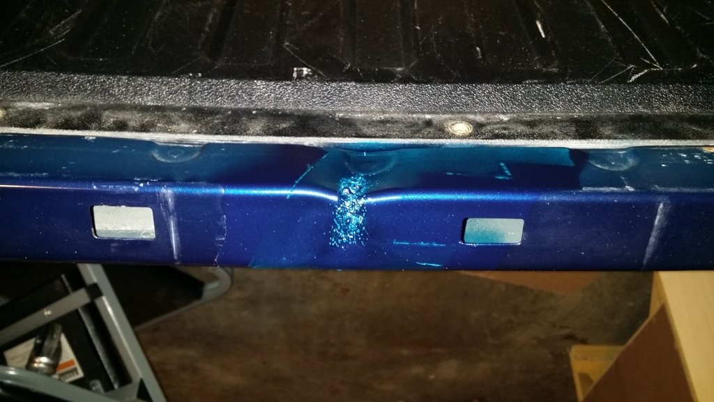

    Finally got around to fixing my tailgate and installing the reinforcement!
    Damage started on the top lip, and went up toward the tab:
    533357cb-b933-4352-a054-7319d83c1146_zps_25ae10a216b72c858d8e1948cb2af1f6f46fb9b6.jpg
    After half assed straightening, shitty welding, and color-matching:
    Finished product:
    The tailgate will never be straight, but it will no longer buckle on me.

    and that tailgate cap is awesome. day after i installed, i loaded a buddy's harley in the bed. Tailgate didn't flex

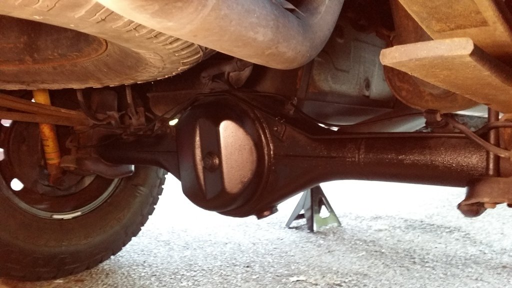

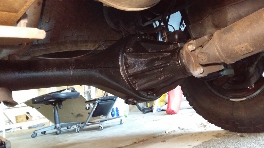

    Little less rusty underneath. Painted the rear axle and differential today. Will get the axle closer to the hubs during suspension install.

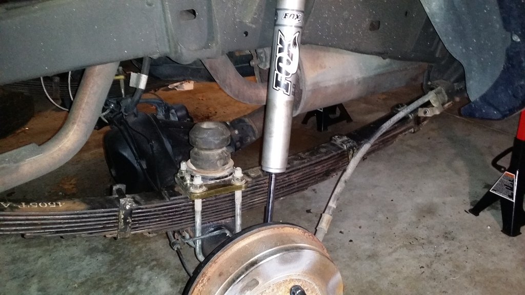

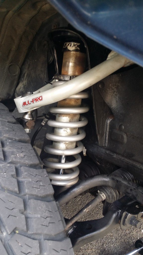

    Got the coilovers and UCAs installed last Sunday (30 Aug).
    Coilovers gave me 2-1/8" lift on both sides, which about levels out the truck (1/8" of bro lean, NOOOO). The expo leafs are supposed to give me 4" in the rear, so i'll need to get those coilovers up to 3" before I change the rear.

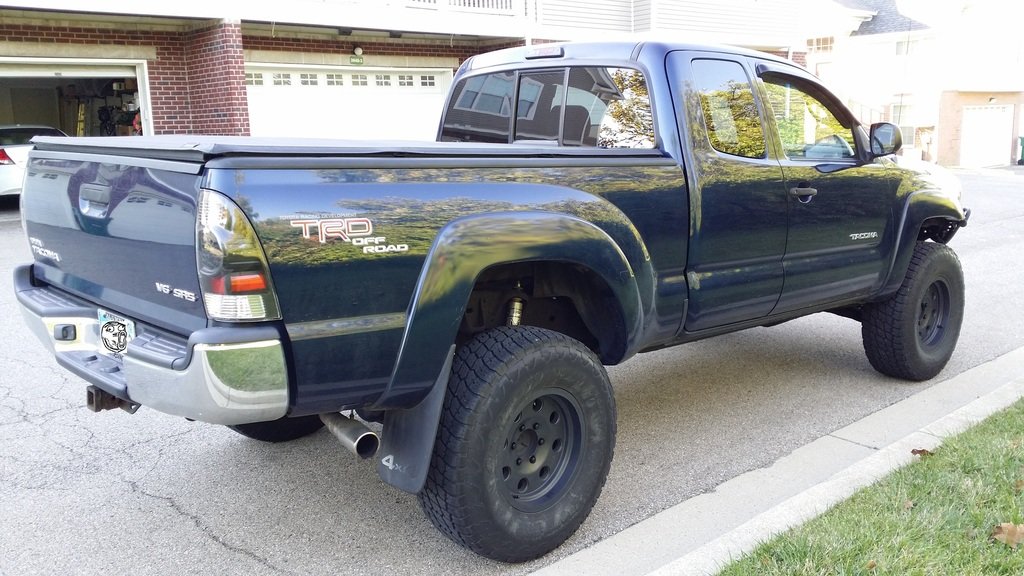

    Rear expos and fox struts installed today. No need to adjust the front coils; the height difference between front/back is 3.5".

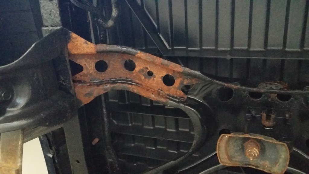

    this rusty frame crap is getting ridiculous. I didn't qualify for a new frame, so i got the goop spray. Removing the spare tire for the rear suspension change revealed this...
    Large scale covered in the goop spray just starts falling away at my touch. :annoyed:
