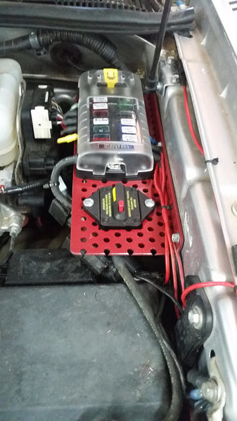

    Rad build! I was wondering if you can you elaborate more on your fuse panel set up? Perhaps a parts list & high level design concept. This seems to be an area where everyone tends to do something a little different or unique to there build and I like yours a lot. Any info is appreciated, Thx!

    Blue Sea Systems 285-Series Panel Mount 100A Circuit Breaker https://www.amazon.com/dp/B0053PGXQ2/ref=cm_sw_r_cp_apa_60IPxbD3DG145
    Blue Sea 5026 ST Blade Fuse Block w/Cover - 12 Circuit w/Negative Bus - 1 Year Direct Manufacturer Warranty https://www.amazon.com/dp/B01C7A8PT8/ref=cm_sw_r_cp_apa_83IPxb8C9P1CE
    And i used steel peg board to mount, makes it easy to zip tie relays to. The circuit breaker makes it nice when ur working on something because you can trip it and kills the whole fuse block, easier than disconnecting the battery
