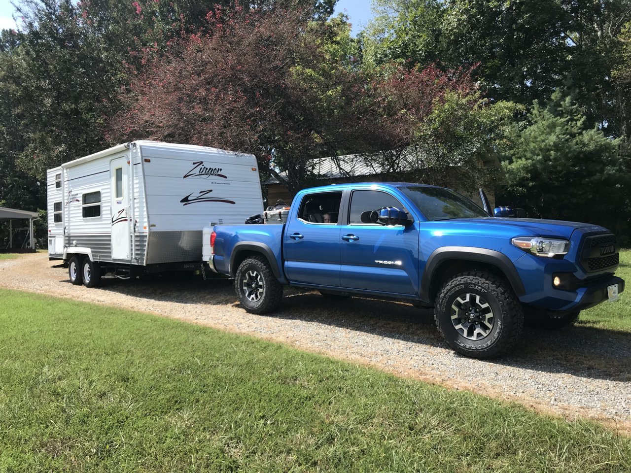

    Mine weighs about 3700# dry and it’s honestly to much for the Tacoma anywhere except flat backroads.... it does it fine but I’ll be upgrading to a 1500 before next spring!! Just for safety with the wife and kids it’s not worth the risk

    evansdmax
    evansdmax Well-Known Member
    Jun 11, 2016
    #189295
    829
    Evan
    Western NC
    2017 TRD OR BBP 6 SPEED MT
    18rb something or bother coachman zinger
