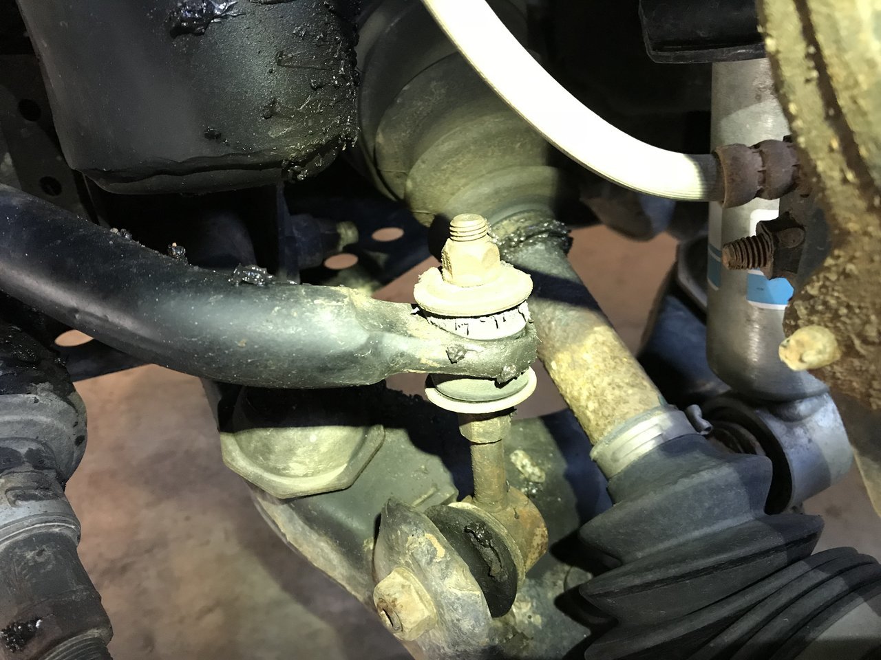

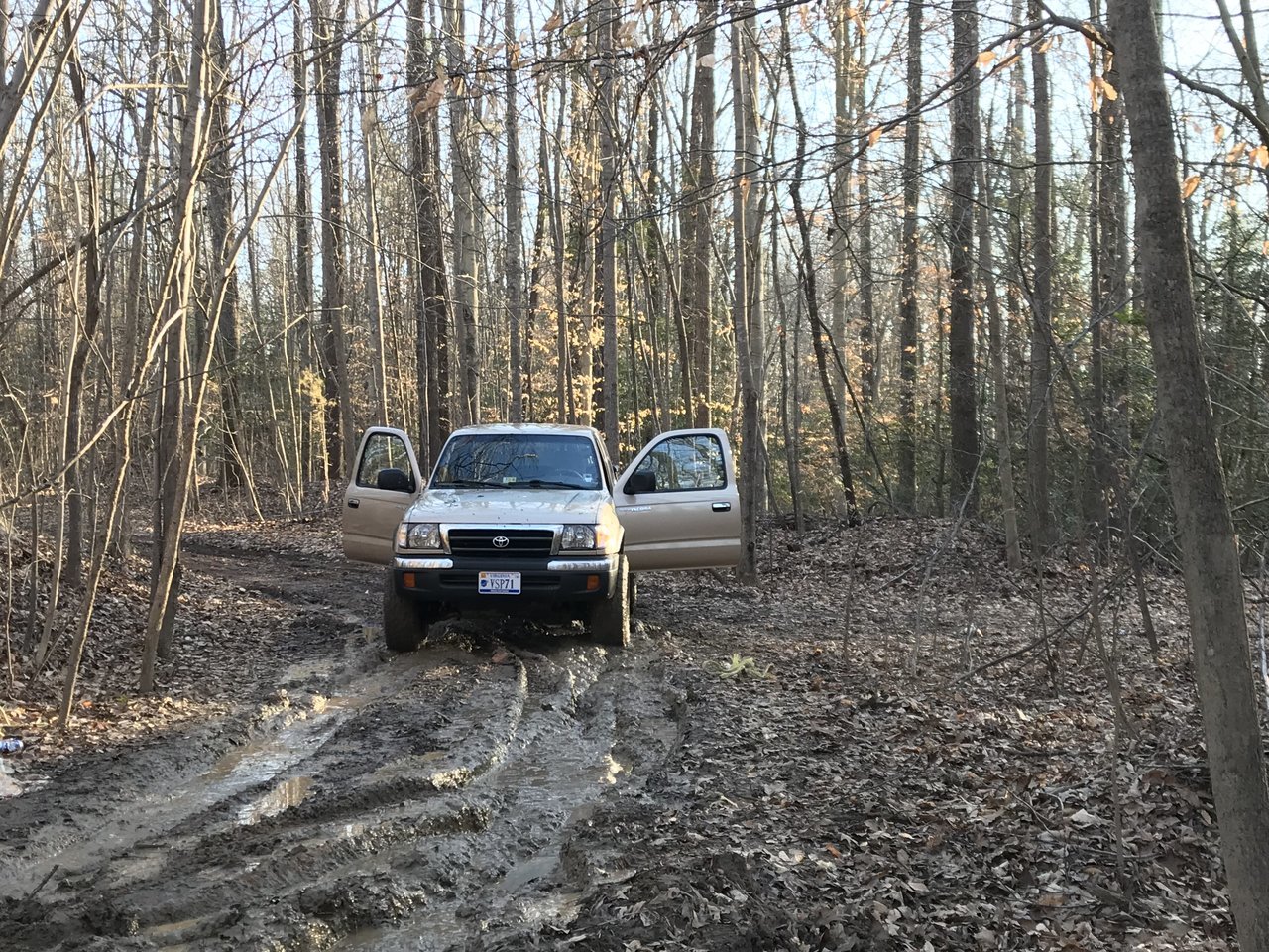

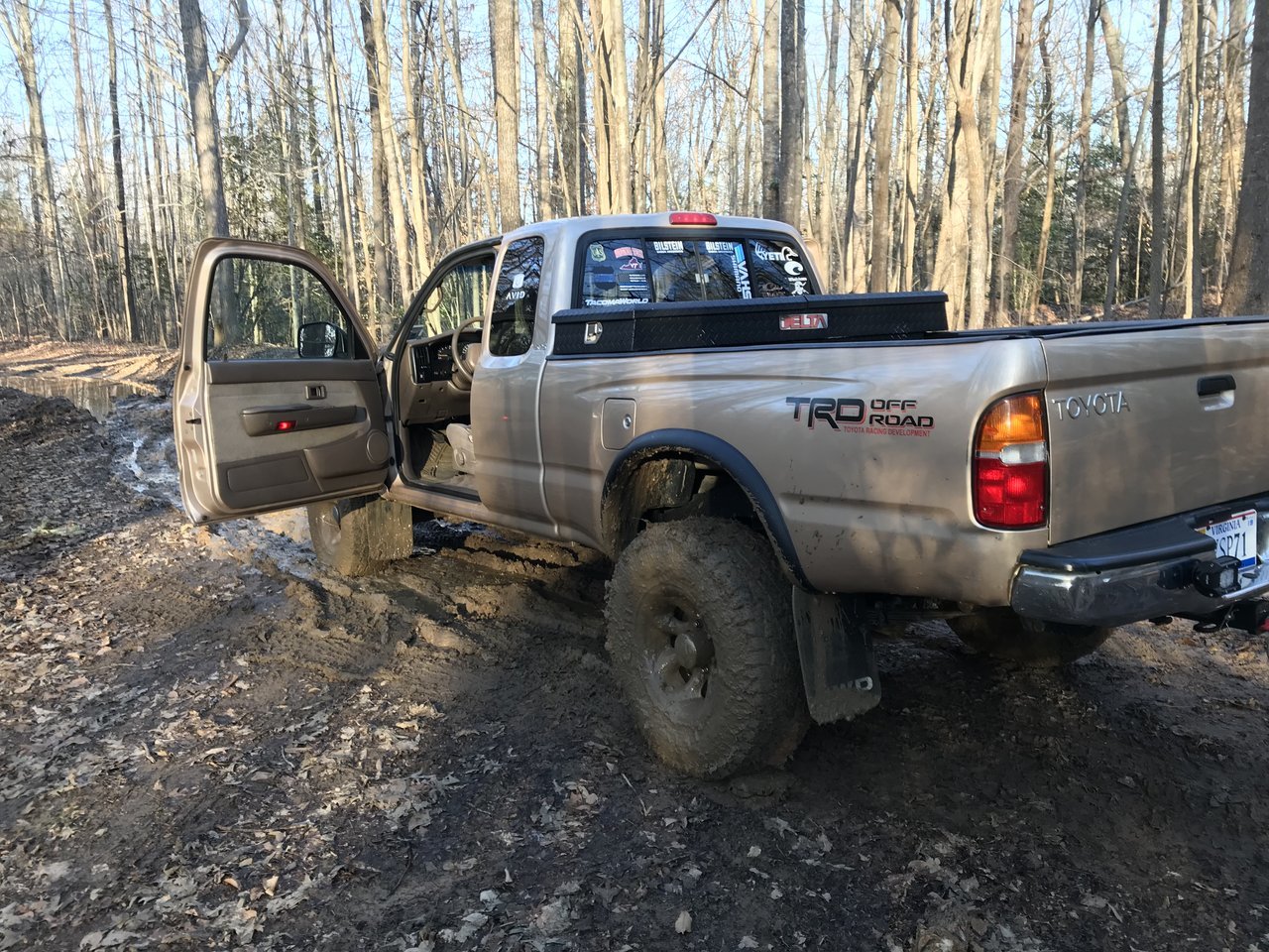

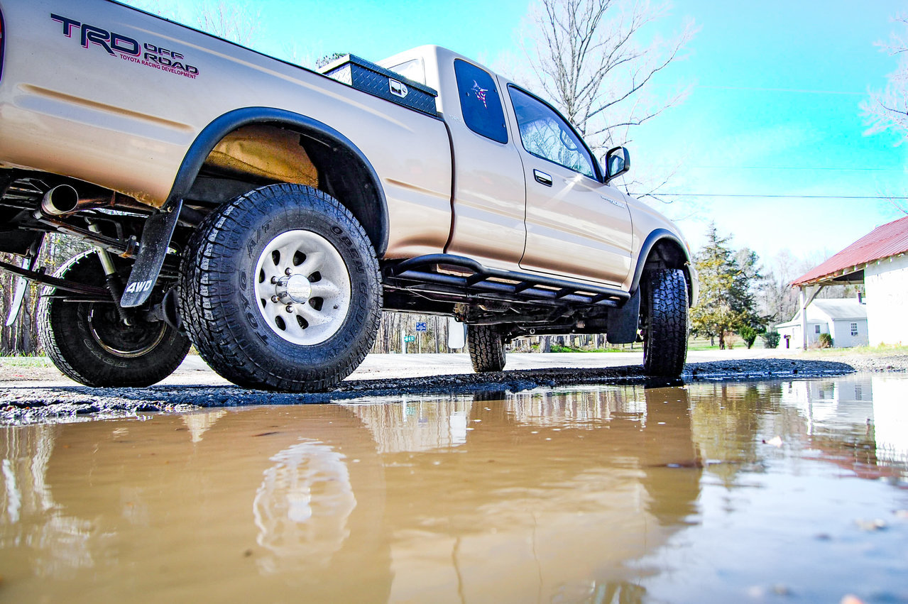

    Due to the unseasonably warm temperatures today in Virginia, I decided a nice little after school project would be to install my extended brake line that came with my lift. This way I could fully flex my truck without fear of ripping out my stock brake line. So I made my own little bleeder kit with a Gatoraid bottle and some 1/4" (I think) inner diameter clear hose. The job itself was pretty straight forward; replace the line, bleed the brake, enjoy. While I had the wheels all removed, I noticed that there was grease coming from my CV Axle, I attached a picture below. Does anyone know if it looks like these things need to be replaced? I don't know why I waited so long to do it, I guess I was just scared of messing up because, you know, brakes are nice to have. It was after my friend and I finished is where the adventure started.
    I was all stoked that we accomplished the project with ease and since it was so nice I suggested we go somewhere to find a rock to flex out on to get some pictures and stuff to brag with. Well he knew just the place, it was some path off of a backroad near my house. We end up going down this path and I'm thinking "what the fuck are you making me do." Eventually we get to this mud hole and he says that I shouldn't go through it because it's like 6 feet deep and I'd sink the truck and that I should take the path to go around. Cool, sounds easy enough, nope. In Virginia it has rained for like the past month so this place was nasty. I couldn't get over to the path without sliding into the hole which I ended up doing. So now I'm stuck in this hole from hell, probably on some dudes private property, and slowly sliding deeper and deeper in. Shit. At this point I was pissed, I told him to call my friend to help pull me out, but I didn't want to give up there. I said fuck it, locked the diff, threw it in reverse, and just punched it. It took a few tries but holy shit I got out. Needless to say I turned right on around and drove my ass home. Looks like I gotta get my friend back now... Oh and while driving home the battery light came on, no clue why, it won't come on again. I just got a new battery so it shouldn't be that. Maybe alternator???

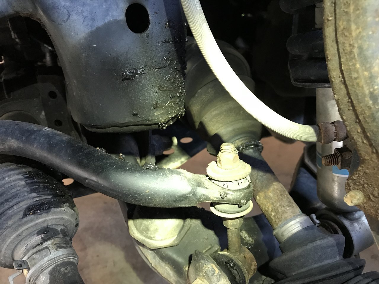

    CV Axle grease. Looks like it's been slung out while spinning. Anyone think it should be replaced??

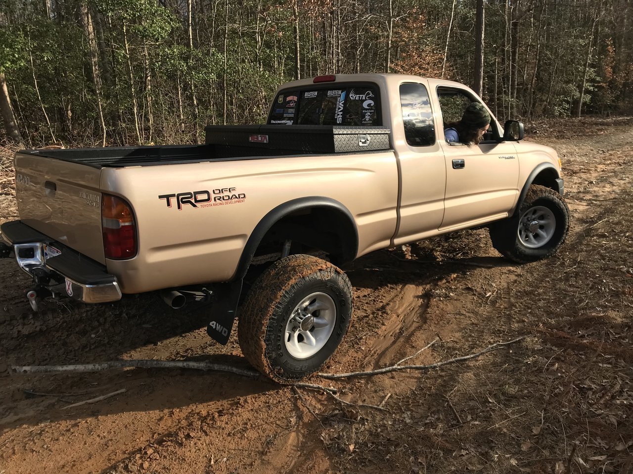

    IMG_0937.jpg Giving her a little flex prior to the mud hole incident.

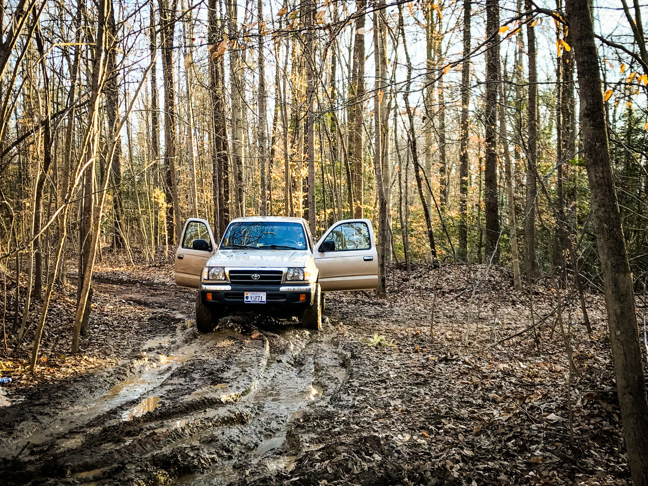

    After I throttled my way out...

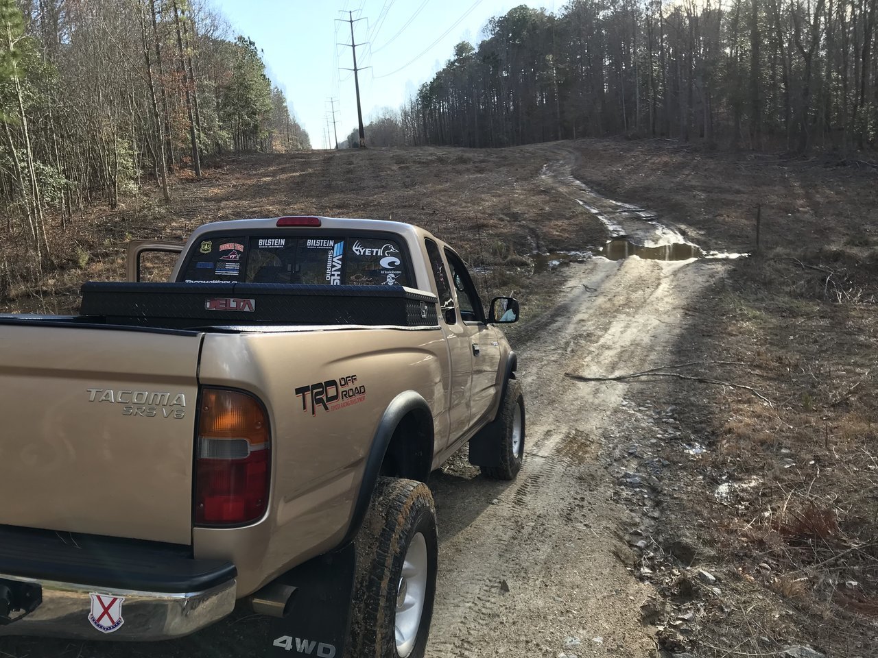

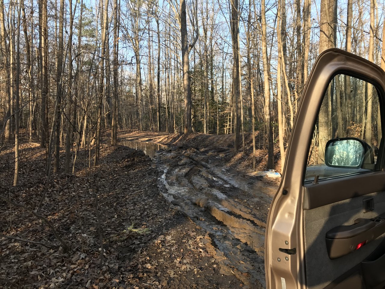

    Better look at the hole. Looks pretty tame, but that bitch is deep! I was trying to shoot up there to the right and go around, but couldn't turn due to ruts and slick mud.
    Overall it was a fun adventure making some memories and having a good story to tell. Now I gotta clean the truck again, luckily it will be another 70 degree day here tomorrow!!!

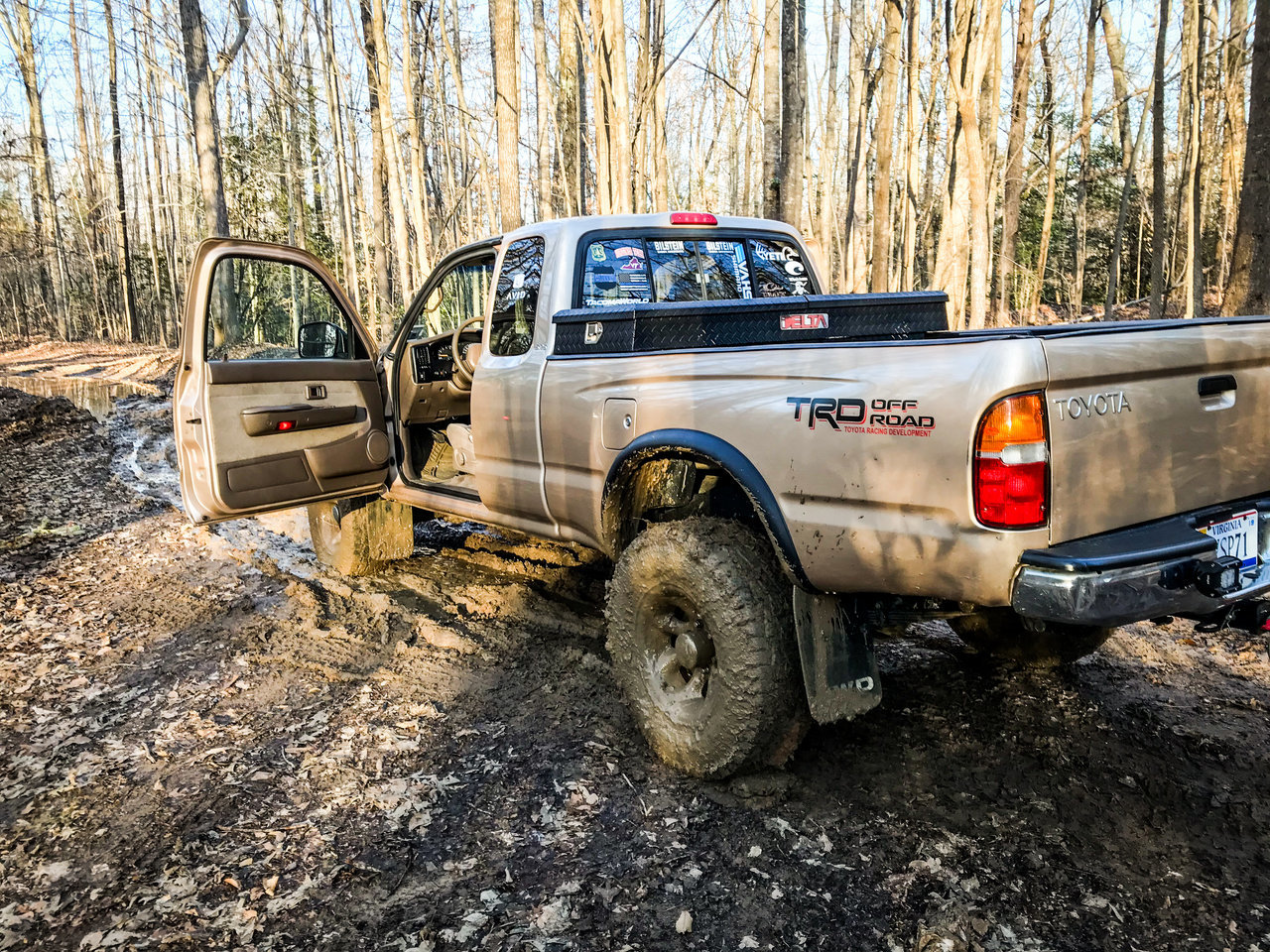

    Now that's more like it:oldglory:

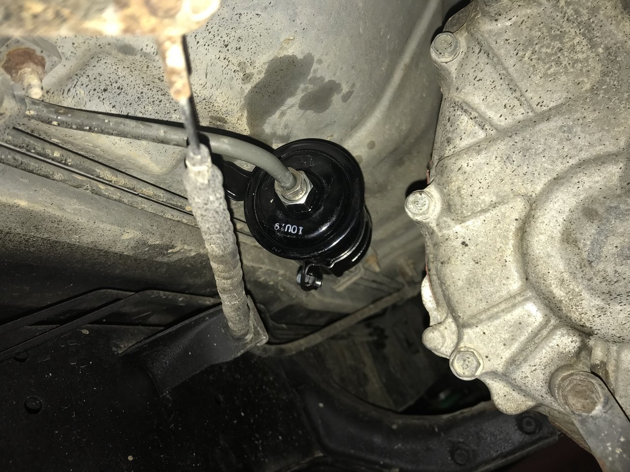

    Next up was replacing my fuel filter. I know from reading the forums that your supposed to disconnect the fuel pump wire and let the truck die to relieve pressure from the lines. After 15 minutes of trying to get the stupid plug out, I threw in the towel and just went on with taking off the filter. A little bit of Aerokroil did the trick and made the nuts nice and easy to get off. What I wasn't ready for was the blast of gasoline from the lines (I guess there is some sense to disconnecting the pump, oh well). Long story short, I got gas all over myself, but got the filter in and it works, win.

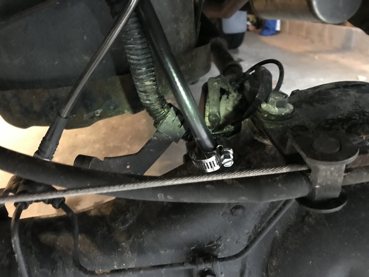

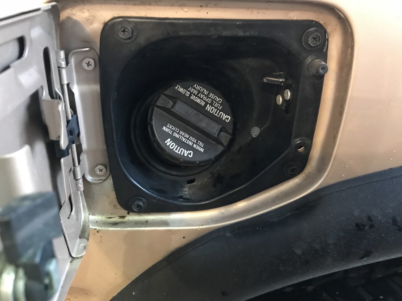

    Finally was the Differential Breather Mod. If you're not familiar you can find more information on it here. Basically the point of it is to extend the differential breather up to a higher point so if you were to drive through deep water the existing breather won't suck in water (or something like that). This was up there with the Grey Wire Mod on level of ease. I doubt I'll ever really need it, but just in case I have the peace of mind that I've done it.
    Fuel hose connecting to differential.IMG_0972.jpgFilter poking out just to the right of the gas cap.

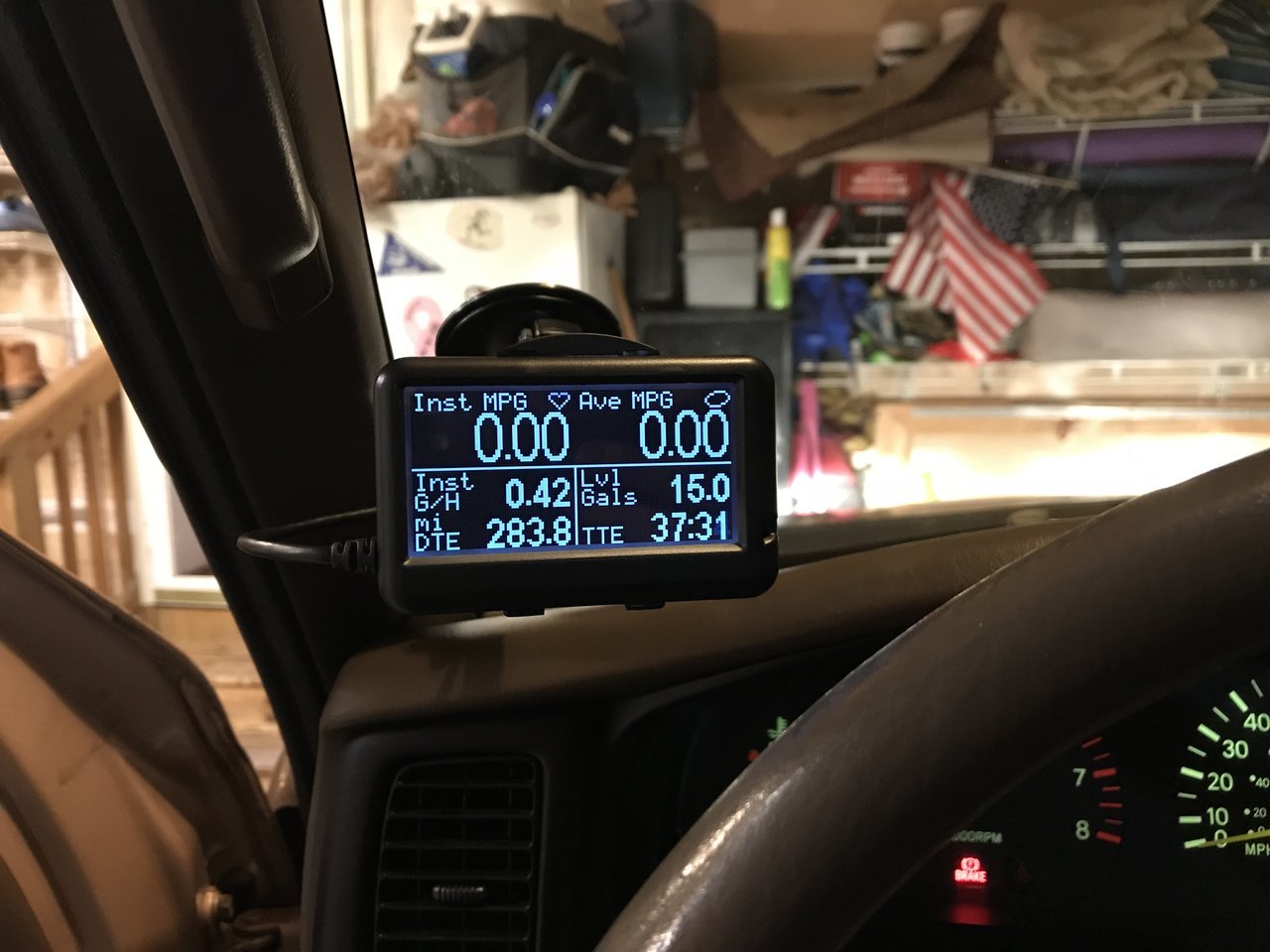

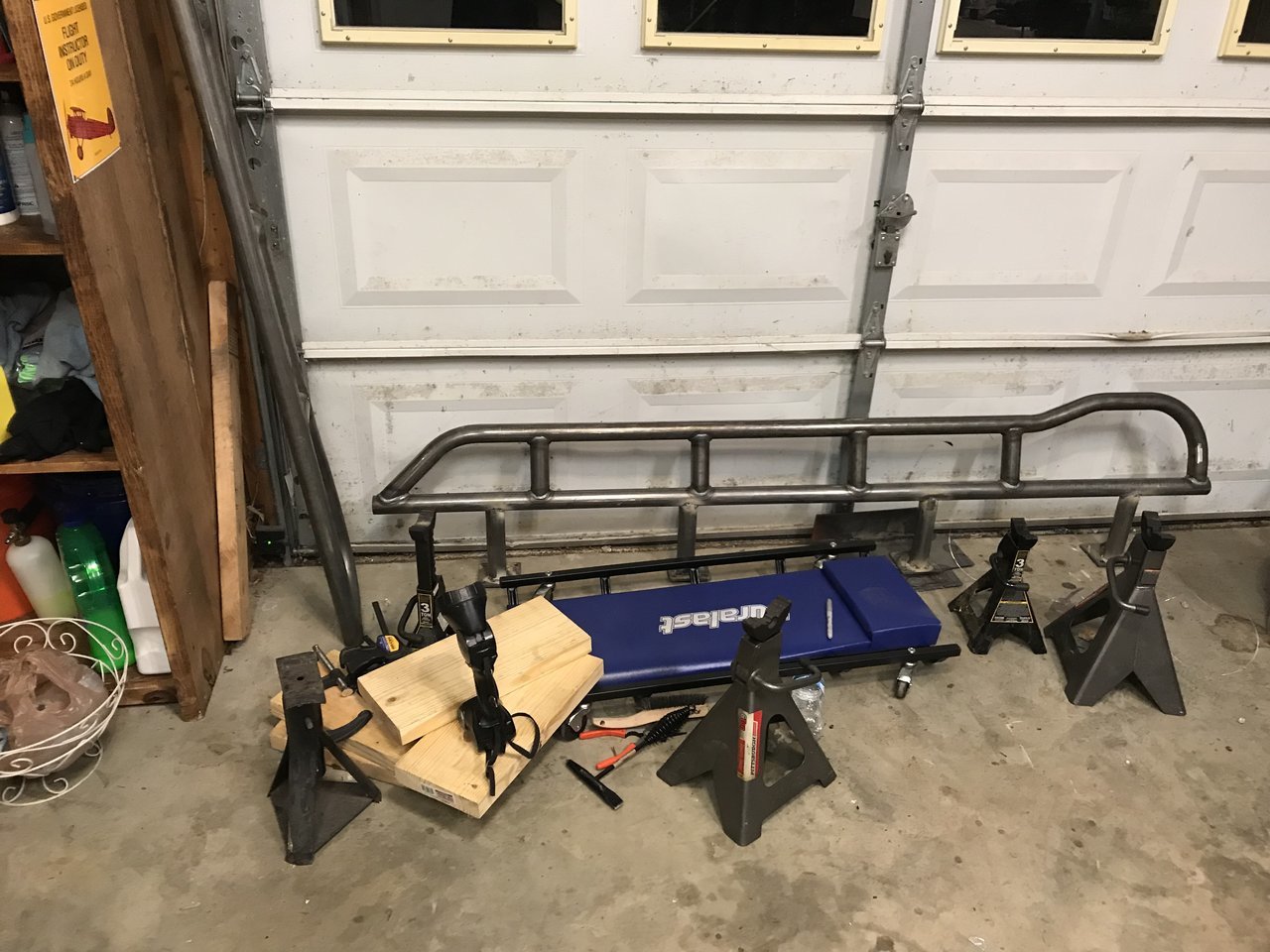

    Started my week off with a visit from the UPS man. He brought me an Ultragauge, 4x Innovations Rock Sliders, and some Greasable Suspension bolts and shackles (nice guy, I know). IMG_0984.jpg
    So far the Ultragauge is up there as one of my favorite mods. You get so much information from it, it is unbelievable. I find myself being a lot more conscious about gas mileage since it's right in front of my face. When I drive like a grandma I can get a smooth 20mpg, which will save me quite a bit of money compared to my previously calculated 16 lol.

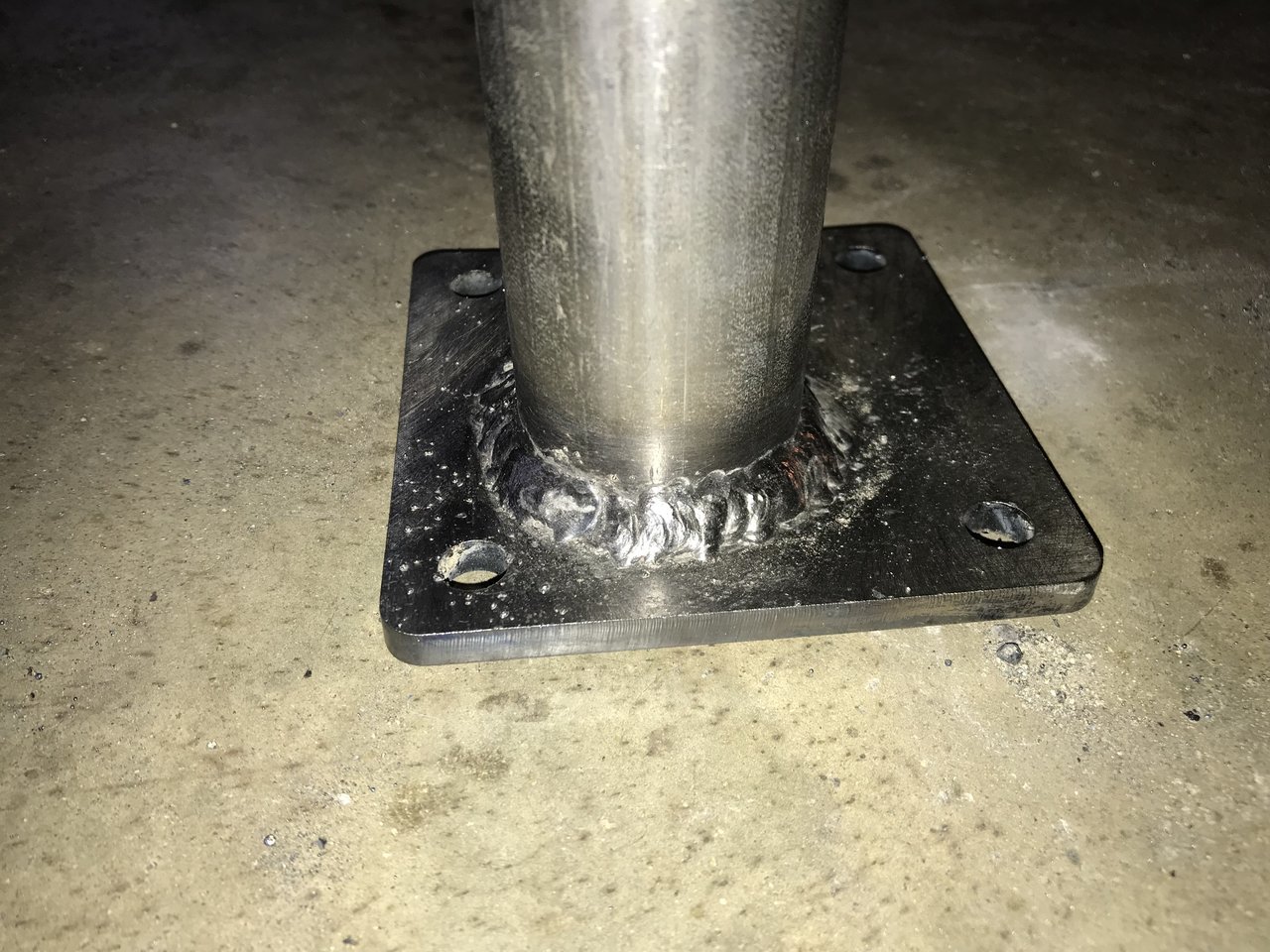

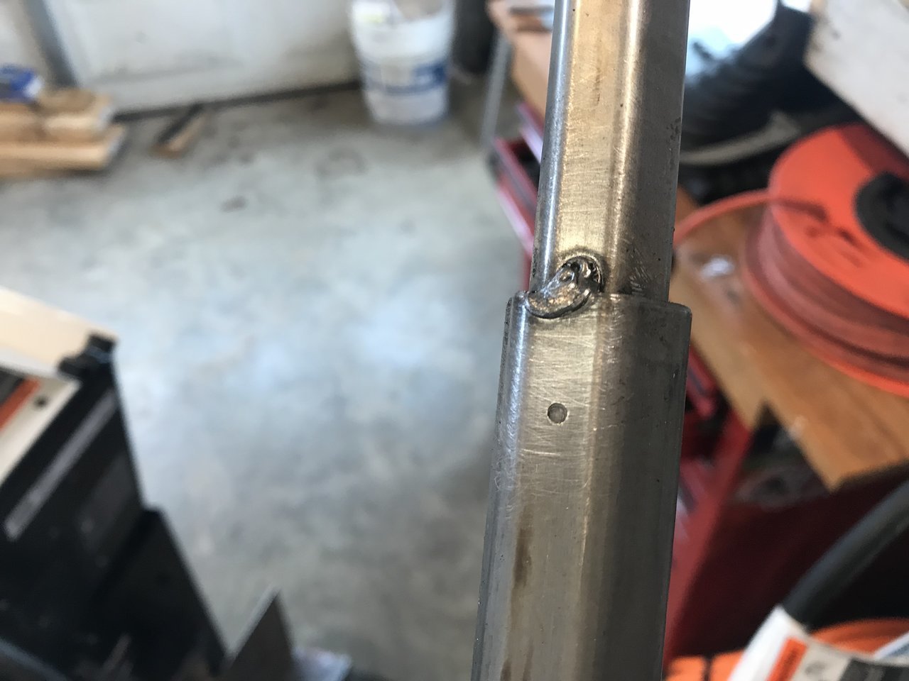

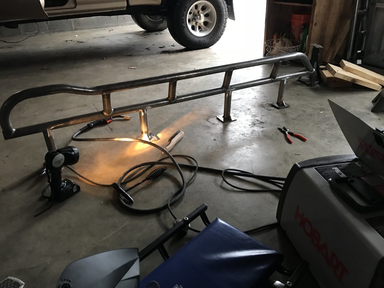

    The rock sliders required some assembly upon arrival, I saw this as an excuse to use my new welder! IMG_0989.jpg
    Turns out welding 1/4" DOM Steel draws a lot of power, I had every power source on the garage circuit turned off to in theory let me weld longer without tripping a breaker. It didn't work, I could maybe get 10 seconds of continuous welding before the breaker tripped. This put a temporary hold on the project until I could get an electrician to come and install a 230v outlet to run the welder on.
    I did complete 1 weld, yea, ugly, but whatever, I'll grind it and paint and. Plus nobody will be able to see it anyways.

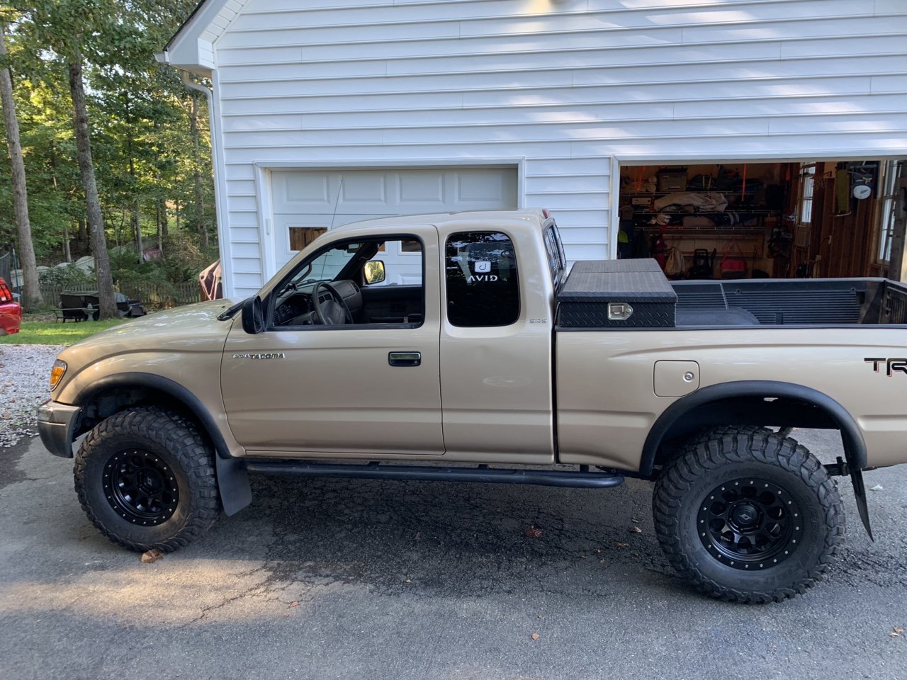

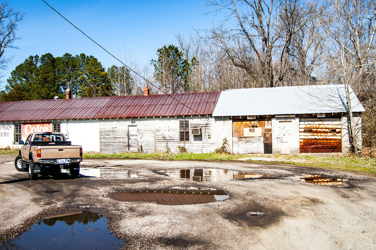

    As seen in my previous post, I have purchased some 4x Innovations rock sliders for the build. Took a little longer than expected to weld them up and get them installed, but we got 'er done. Overall I'm super happy with my purchase. Originally I was torn between Relentless Fabrication's Sliders and these, but was eventually swayed to these since they were cheaper and in stock. It was a little more working aligning the plates and welding everything, but a great learning experience. The welds may not be the prettiest, but I'm confident that they'll hold, plus 99% of the time they are for looks.
    The completion of this project prompted a mini photo shoot at the old coal miner store. Next up on the list is Diff Drop, U-Joints, Steering Rack Bushings, And greaseable suspensions bits for the rear. Sounds like a Sunday workday is in need!

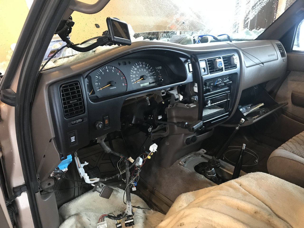

    Been a little bit since the last update, nothing that exciting has happened, but I have been working on the truck. Decided I was sick and tired of it driving like a 18 year old truck and wanted to freshen up my steering. For this I got all new inner and outer tie rod ends, Energy Suspension steering rack bushings, and performed the steering tac weld mod. In the process of doing this I went to change my Shifter seat bushing and somehow ended up buying a URD Short Throw Shifter Kit (I don't know how it happened). The Steering Rack Bushings were definitely the most aggravating part of the project, but arguably the most beneficial. After installing everything and getting an alignment, I can say my truck now handles similar to my 2004 F150, which is a huge step above the floaty and unresponsive steering I had before and the short Throw Shifter is a drastic improvement form the long throw these Tacomas have. Still on the list is my passenger CV Axle, and 2 U-Joints, I'll probably just get to those whenever.
    The process of removing the steering wheel column and assembly, then welding the tube took about an 2 hours, and I was being super careful and cleaning all the dust and grime that has accumulated in there over the years.

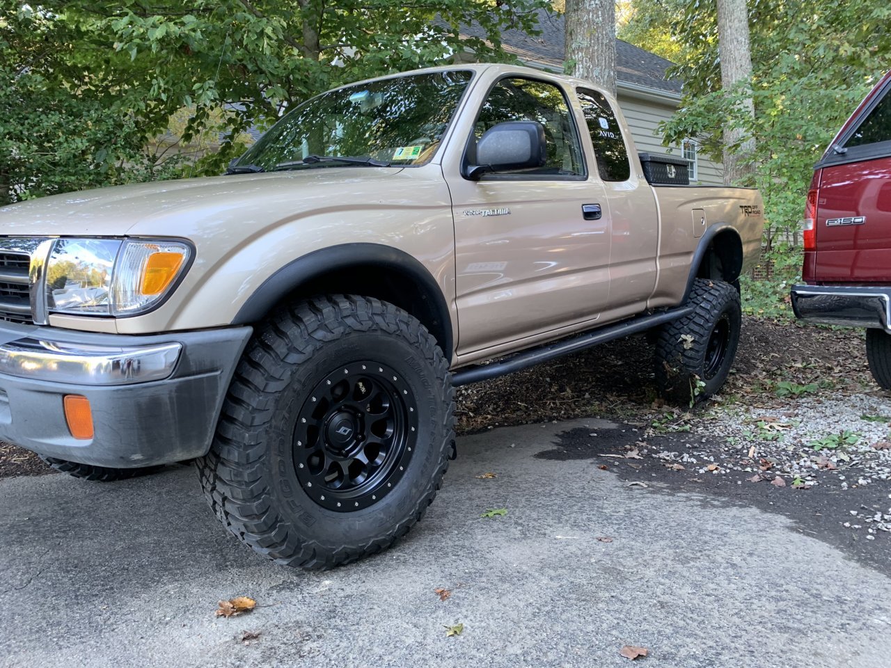

    New Shoes

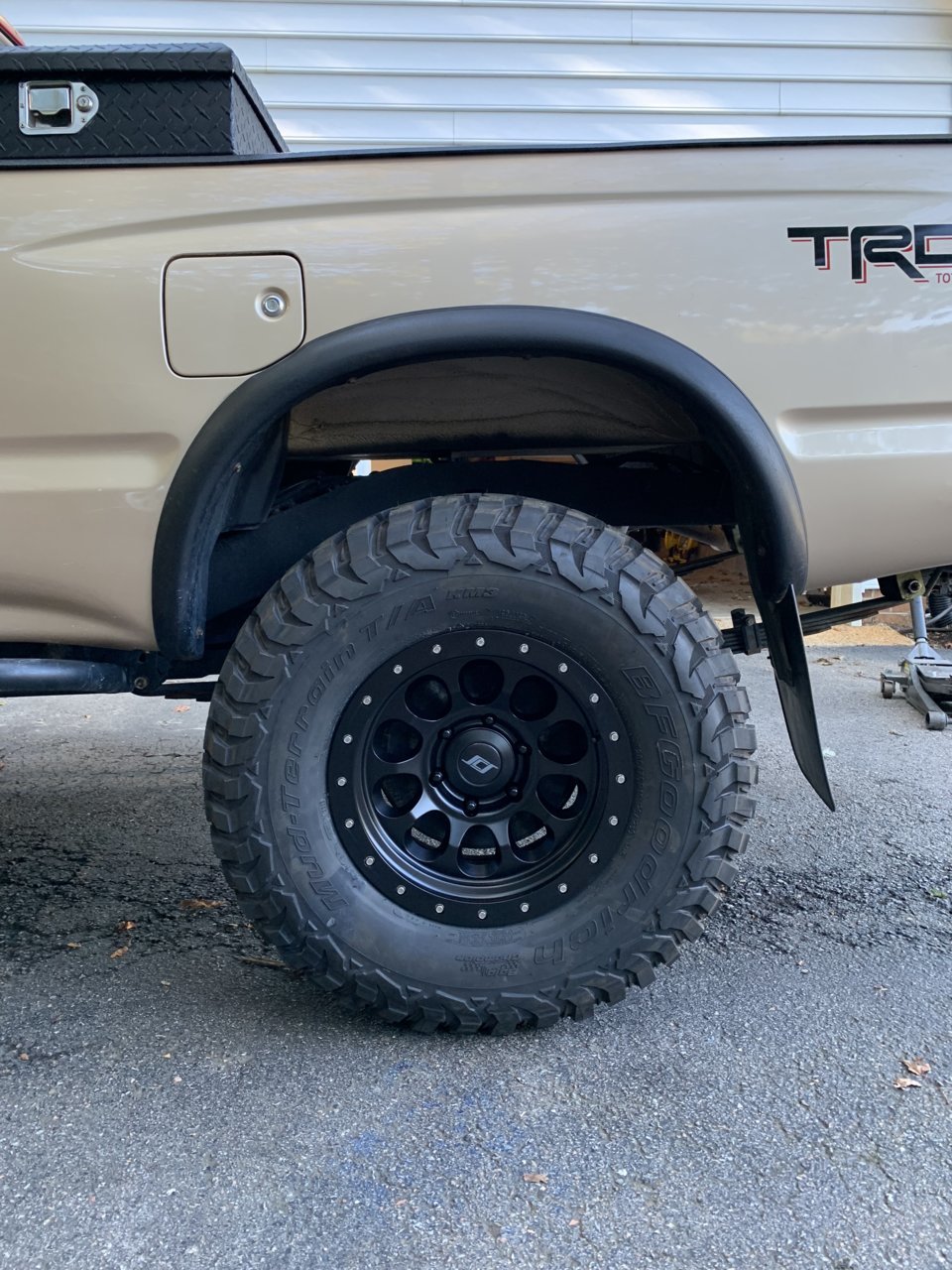

    After having been sitting in my garage for weeks while I was at school, I finally got my Ray 10s hooked up with a brand new set of BFG KM3s (285/75r16). She rubs a little on the front, but not nearly as bad as I was expecting, MCM Fab long travel should do just the trick, but that’s for next break...
    E38D22FB-D6A6-425F-A6D9-E0C8CC7817B6.jpg 9091E6CA-E4FC-40DF-88AC-CBC40A4D4698.jpg DE1C2EE5-8941-4311-BF09-A9DD14036883.jpg 76E1D543-D168-45A4-8B9E-4FA30FBE6C2B.jpg
