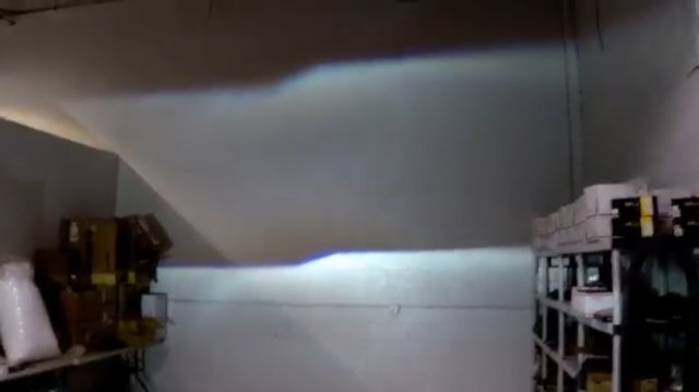

    I'm looking for feedback on my next big-ticket purchase, a RX350 HID projector retrofit for my 2015. Lightwerkz (who will be performing the work) includes a clear lens swap as part of their tuning process. Poor-quality screenshot of a video comparing performance is below:
    Stock RX350 projector on top, RX350 projector with STi-R clear lens on bottom. Bulbs and ballasts are identical between the two.
    Taken from this video (performance comparison starts at 5:22):
    https://www.youtube.com/watch?v=hPjupWFxE34
    I know what you're thinking. It's a no-brainer, right? The hotspot is way more concentrated with the clear lens, and the light cutoff is way sharper. I was blown away by the performance difference too, but then I started thinking about what these performance traits would mean during daily use.
    I have no problem with the ultra-focused hotspot. This is essential for distance projection, which is the entire purpose of having headlights. If I need to amp up the near-field lighting, I can kick on my Diode Dynamics SS3 Pro fog pods, so that's a non-issue.
    The sharp light cutoff is where I can see an issue arising. Most factory headlights have a more diffuse cutoff line, meaning they throw a bit of light upwards to illuminate stop signs and other surfaces that typically appear above headlight level. In addition, the transition from light (area illuminated by headlights) and dark (areas above headlight cutoff) is more gradual, resulting in less eye strain when trying to identify non-illuminated surfaces.
    I asked Lightwerkz for their opinion. Their reply:
    What do you guys think? Do the clear lens swap, enjoy the distance projection, and try to somehow compensate for the lack of "up-light"? Stick with the OEM Fresnel lens, deal with the less intense hot spot, and don't worry about blowing an unseen stop sign at oh-dark-hundred?

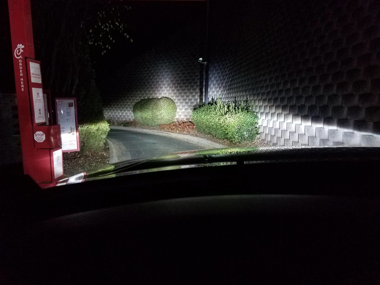

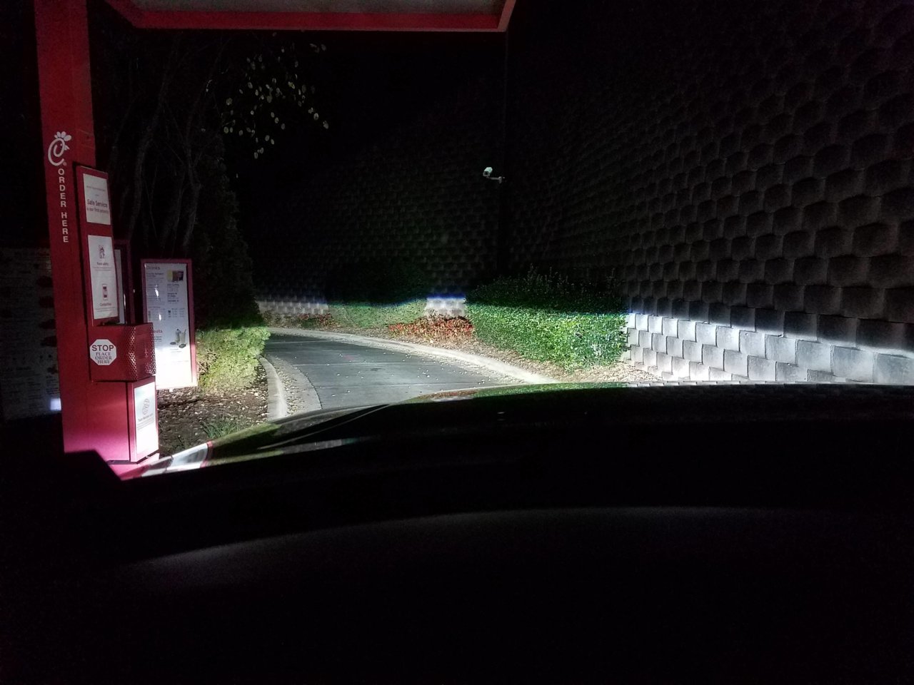

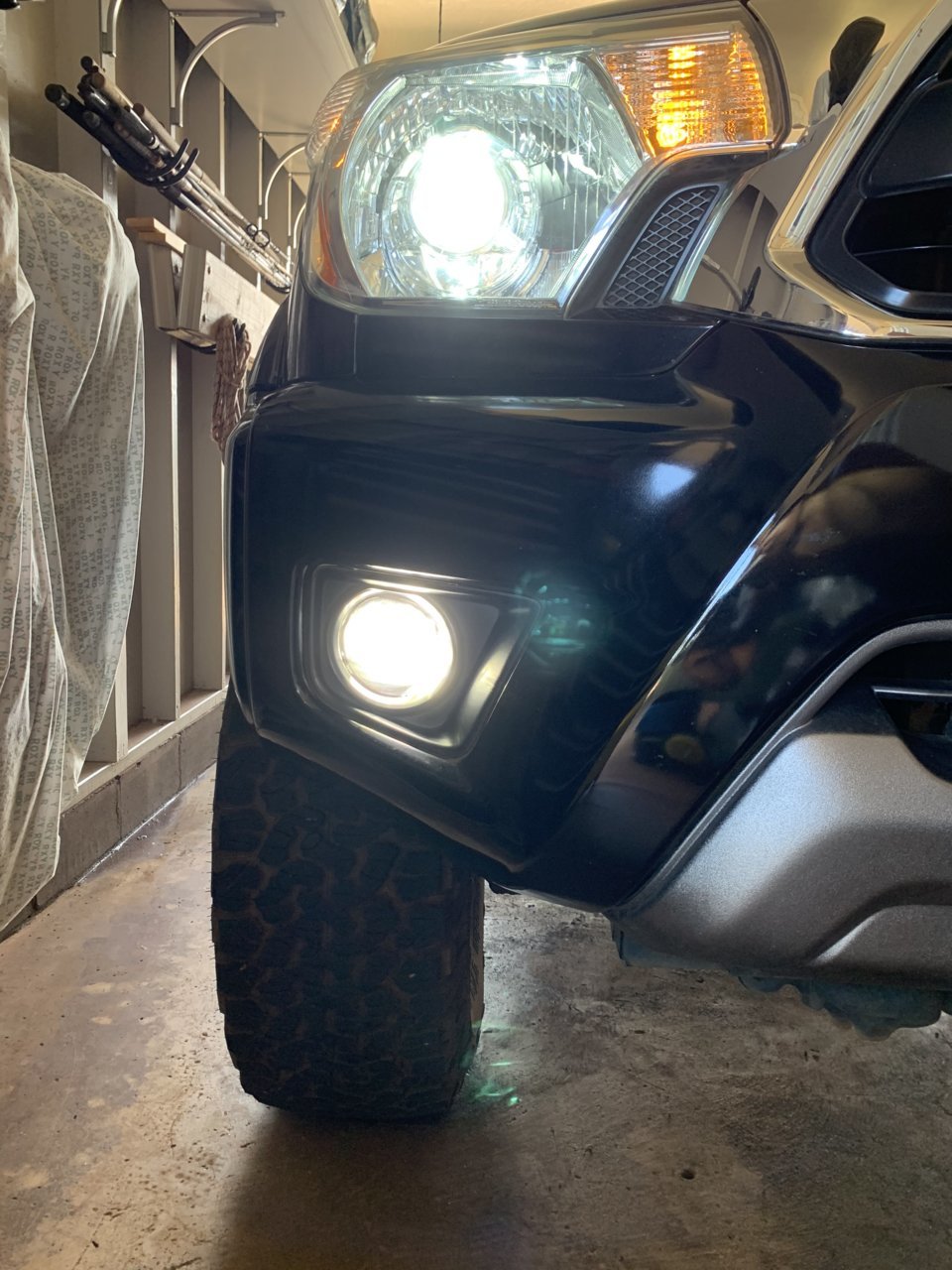

    Pic taken immediately after adjusting cutoff back in February 2015:
    The most recent pic I have while heading home from work this past March:

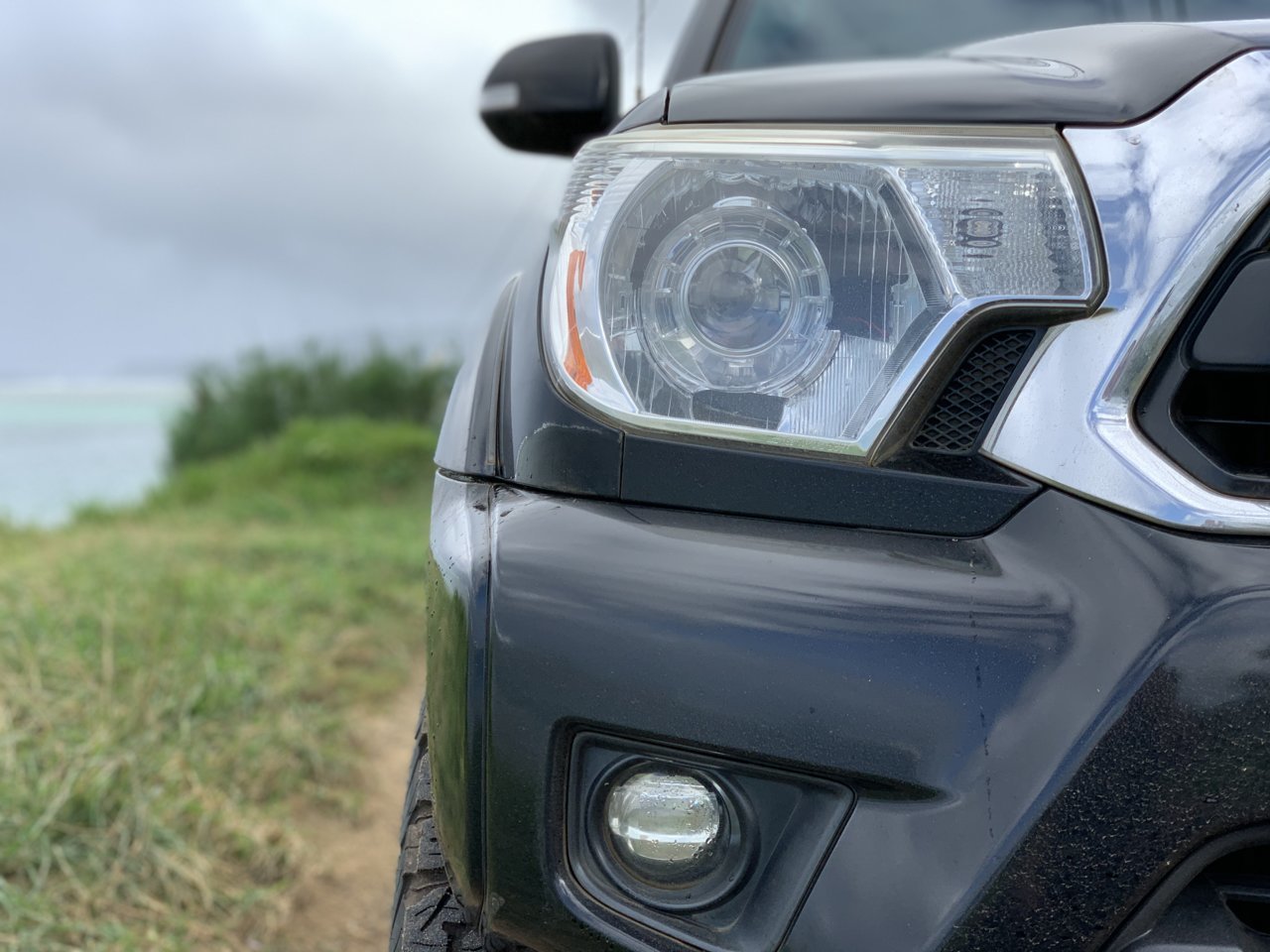

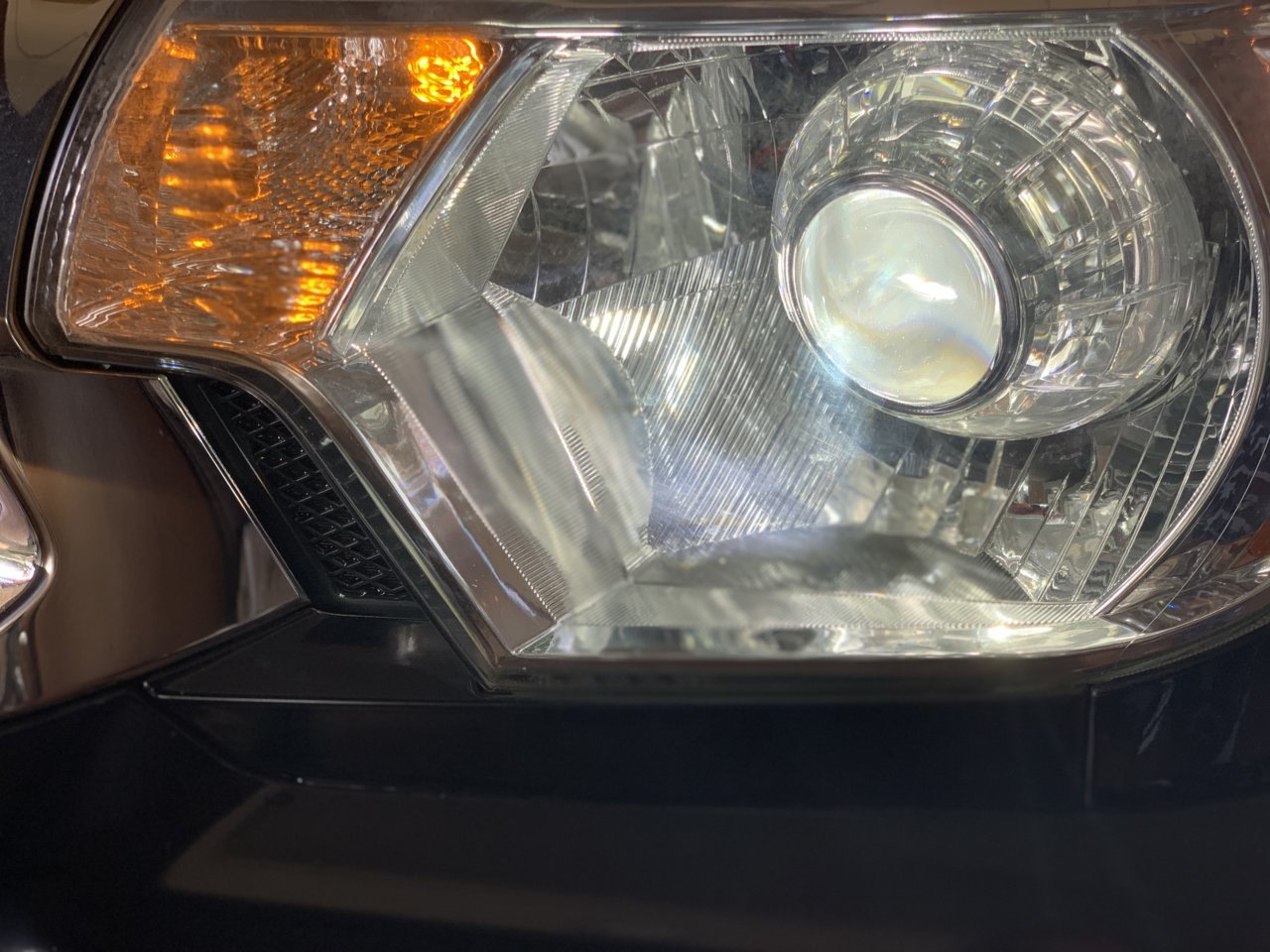

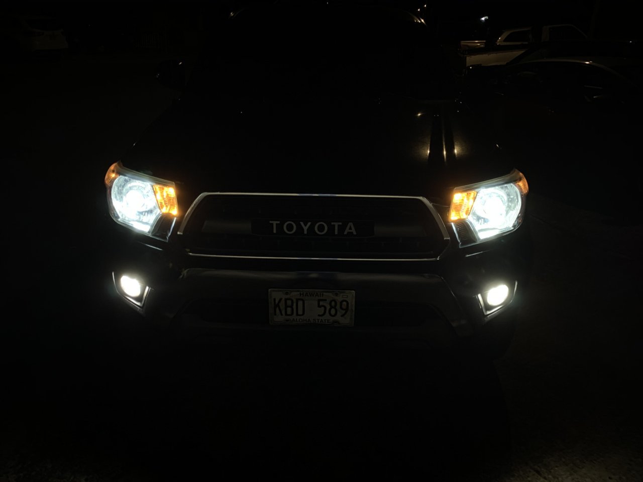

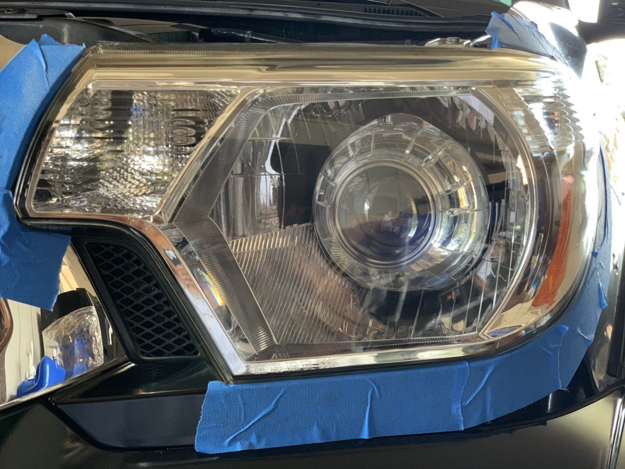

    Pics of it when off during the day, on during the day and on at night:
    (Don’t mind the tape, I was polishing it)
    All iPhone pics since I don’t own a nice camera to capture the lights properly
  7. Oct 16, 2020 at 5:18 PM
