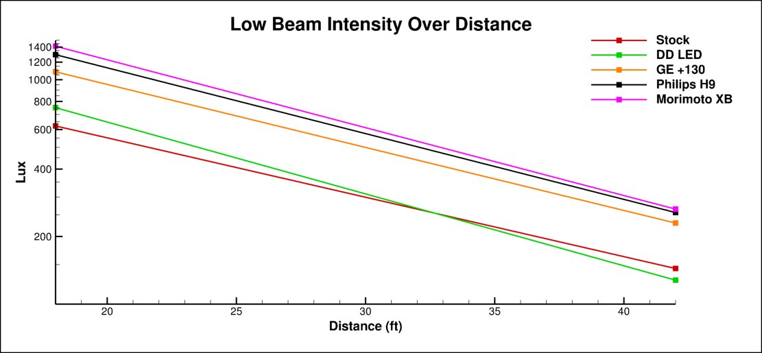

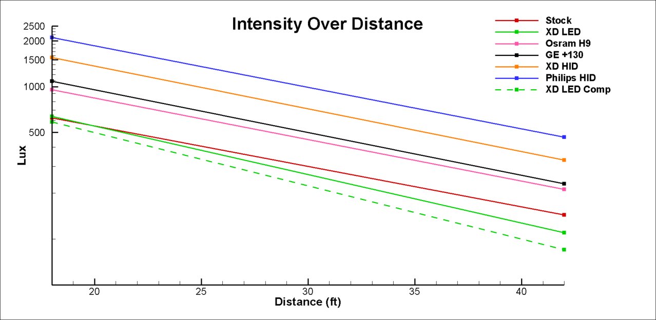

    Garab
    Garab Well-Known Member
    Dec 29, 2018
    #277398
    830
    2018 TRD Sport MT6 DCSB
    OVtune 2.0 TRD Sema wheels 265/70/17 Falken Wildpeak AT/3 SL ADM BAKflip mx4
    https://www.tacomaworld.com/threads/3rd-gen-hid-vs-led-vs-halogen-h11-projector-headlights.589465/
    [​IMG] [​IMG]
    All measurements are done by Crashnburn80 using a specroradiometer rather an these inaccurate lux meteres that bias a certain spectrum of light to make LEDs read higher.

    #26
    Garab
    Dec 29, 2018
    #277398
    830
    MorimotoXB listed in the second graph is the $1200 full enosure sealed LED housing. GE+130 are halogen replacements shown in both graphs. Phillips HID in stock housings are listed in the first chart. This covers everything ive been talking about. You can clearly see the difference. The morimotos are only marginally better than the GE+130 halogens, and the GE+130 gets blown out of the water by HID in stock housings. An HID with proper focus and beam coming out of a retrofit projector only increases the HID effeciveness.
    Everything ive read saye the morimotos are better than the stock 2020 LED set up, so until crash does a test of them we wont truely know how they compare. Either way LEDs have significantly very little return on investment compared to HID or halogen upgrades.
  7. Mar 25, 2020 at 3:06 AM
    #27
    Sasquatchian
    Sasquatchian Well-Known Member
    May 30, 2018
    #254922
    724
    Simple graphs rarely tell the whole story. As someone who has tried, and measured with higher end equipment than our buddy crash, all the high performance H11 halogens in the stock projector housing, and then swapped out to the new Tacoma LED assemblies, the difference is night and day. What you notice immediately, the first time you drive them after proper aiming (which is crucial) is having a broader, brighter, far more even beam with none of the shadows that the stock projectors have, but it's really that it puts so much light down in areas where the stock lamps are just missing. Yes, the LED's have a higher color temperature and a lower CRI, but that doesn't seem to affect how well these lights let you actually see, which is the most important factor. And who gives a fuck about the little TRD and PRO lights. That doesn't affect the functionality and you can't see it while your driving anyway. The 2020 Tacoma LEDs are also the only legal way to put an LED light in your truck, regardless of what some of those companies claim. Morimoto is just an American marketing company that came up with a Japanese sounding name to pawn cheap Chinese crap on to uneducated and unsuspecting people who are dazzled by their ads. When you're dealing with something as important as your night time lighting, you really don't want to take any chances. Now if you could only put the Subaru Forester LED's in our trucks. Those are even better than the Tacoma's.
