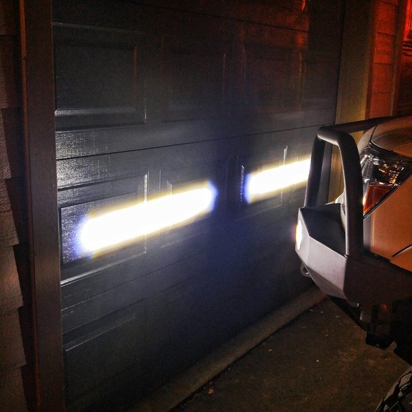

    Rigid SAE fog lights

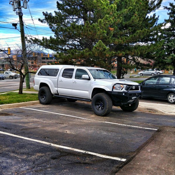

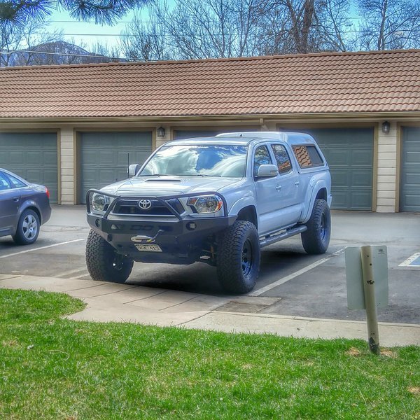

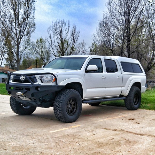

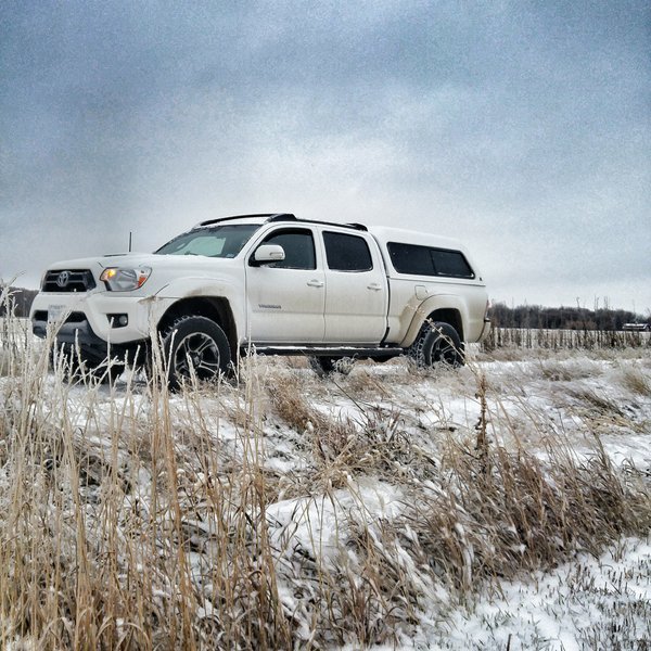

    How the truck sits today:

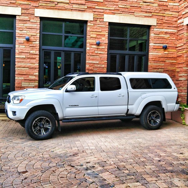

    The first day I got her:

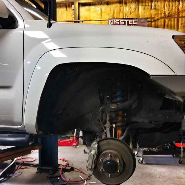

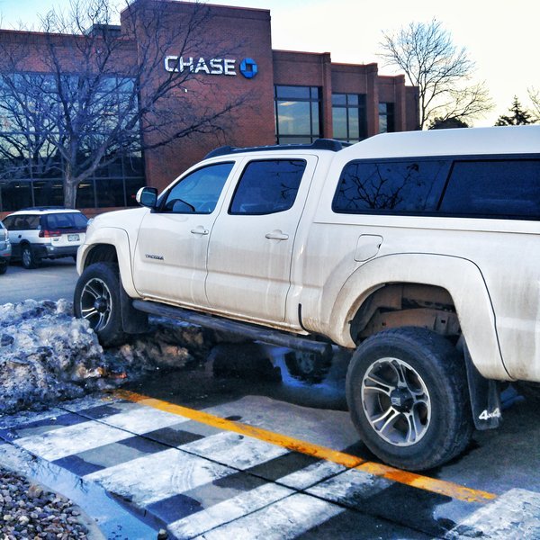

    Mall Crawler..

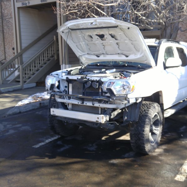

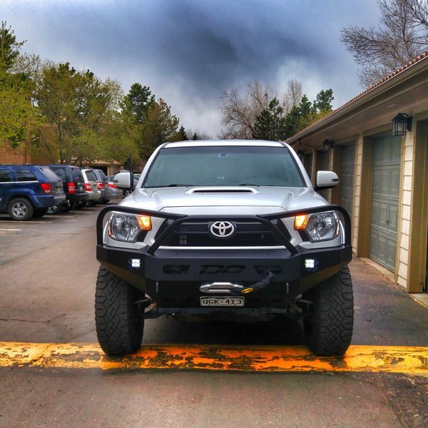

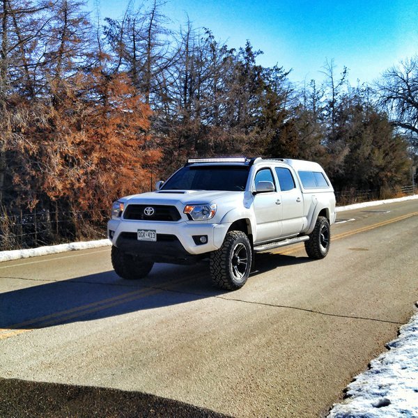

    Time for a new front Bumper

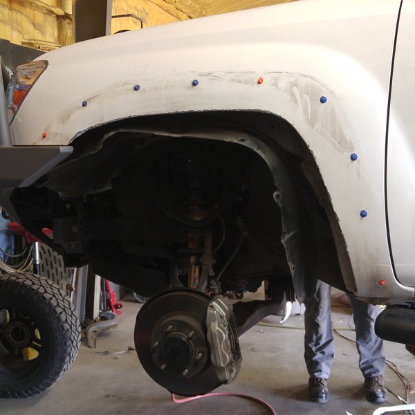

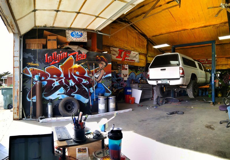

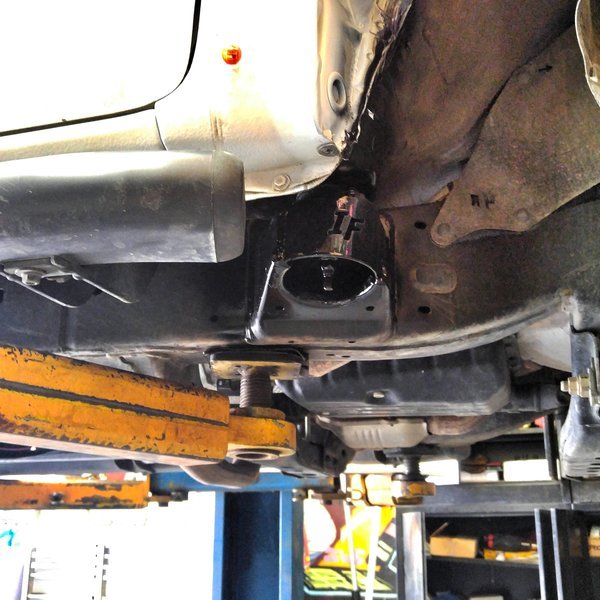

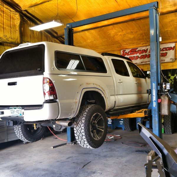

    Trimming 2.5" off the fenders, beat back the pinch weld, and installed the new Insain fab body mount to clear 35's
    Demello bumper getting a makeover

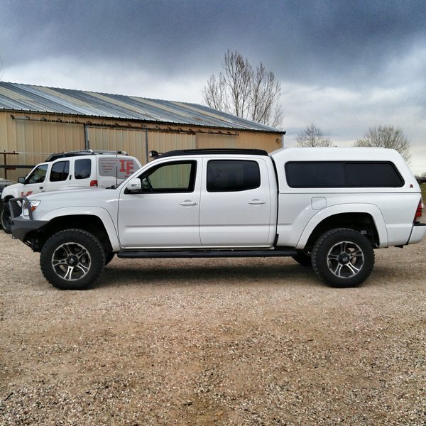

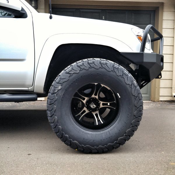

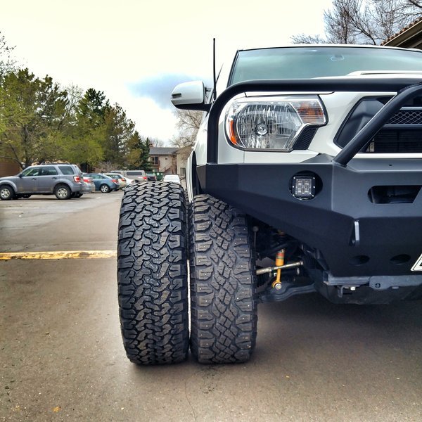

    And its time for the 35's

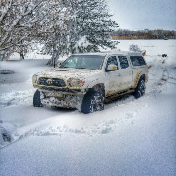

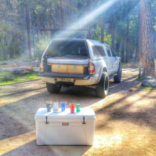

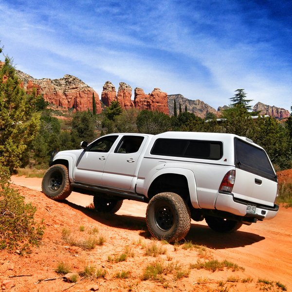

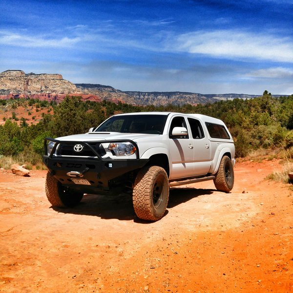

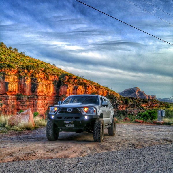

    Some fun in the sun in AZ

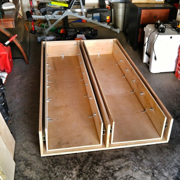

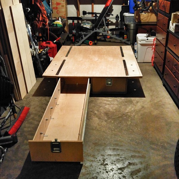

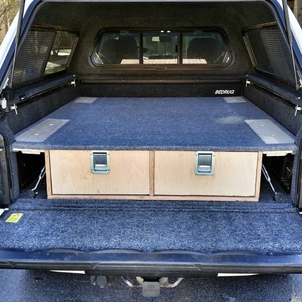

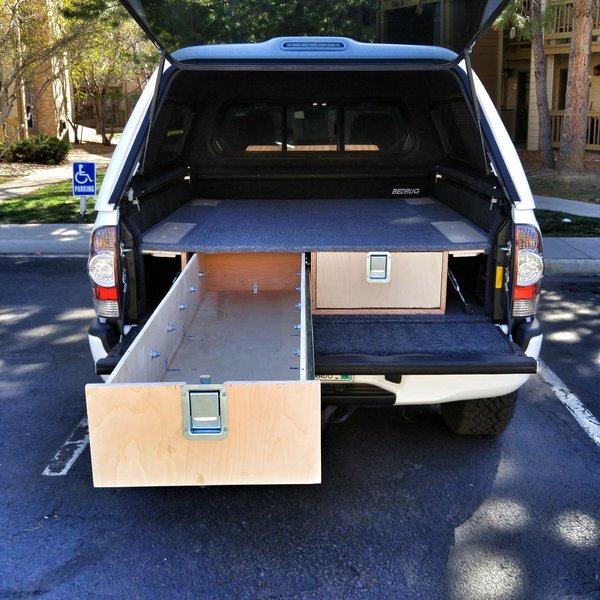

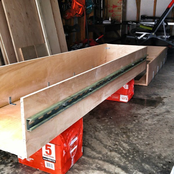

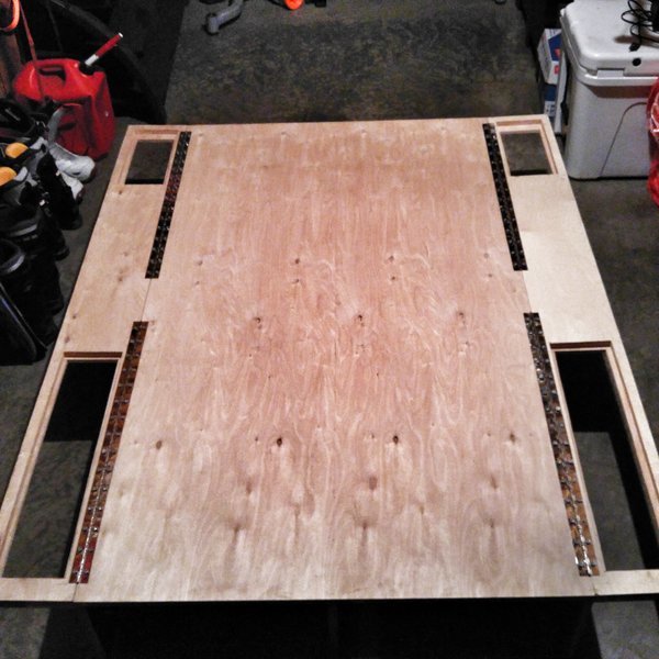

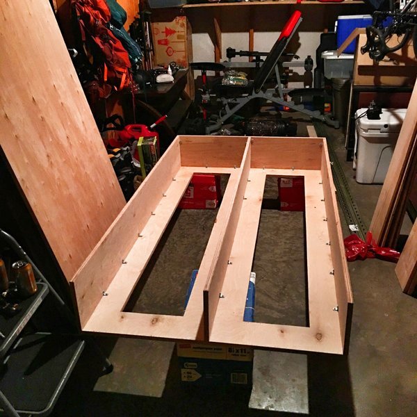

    The drawer/sleeping platform took some time to design but came out great. I knew the conventional drawer siding wouldn't cut it so I used 1.5" sliders and a 100 pack of skateboard bearings that were aligned on the top and bottom of the sliders. Yes, its overkill but they can hold 200lbs when fully extended. I still want to add a few things but here it is:

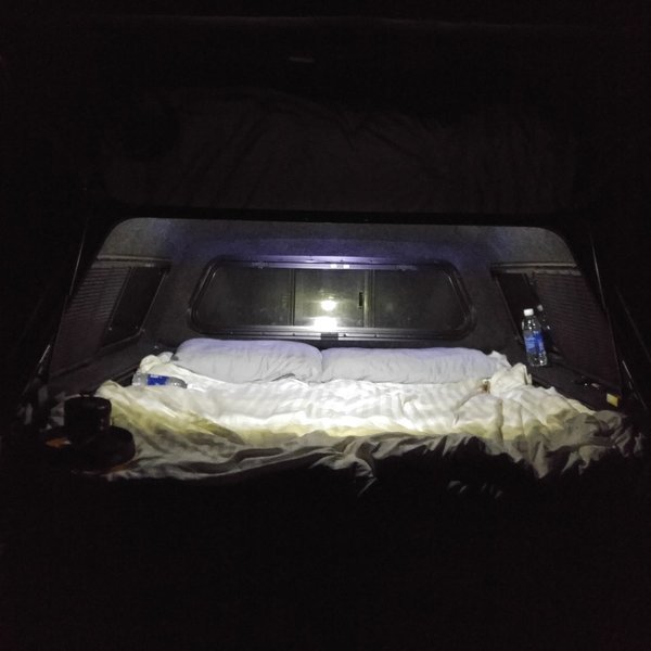

    I used a 3" queen foam mattress and had a cut a few inches off from each side but it fits like a glove.

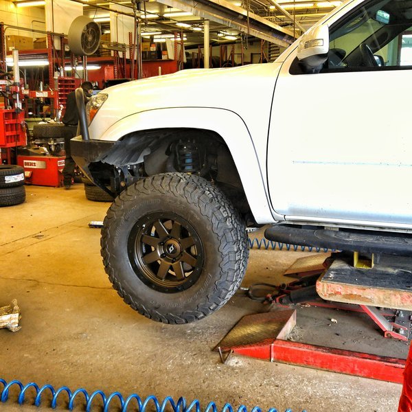

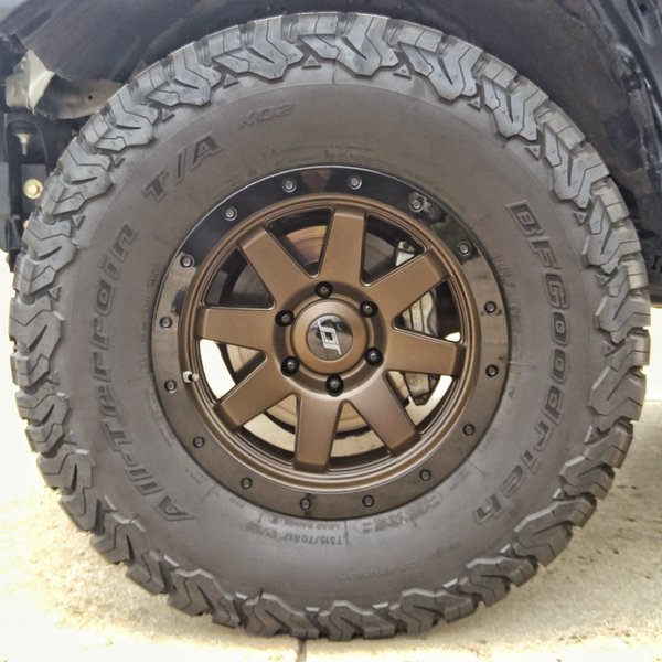

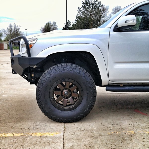

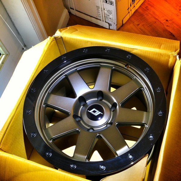

    SR8s have arrived!!!

    I love how Tacoma's look on 35's.
    Nice build so far and great job on the sleeping/drawer platform.
    Are you running spacer lift at the momment?

    Thanks. The 35s definitely beef it up. I do have a 1" spacers up front. But I should have my kings in about 1.5 months =]

    How did you fit the 35's with a 3 inch lift? Do you scrub pretty badly?
  9. May 7, 2016 at 4:09 PM
    Tacoma14DCLB
    Tacoma14DCLB [OP] Member
    Nov 9, 2015
    #169098
    21
    2014 White Tacoma TRD Sport DCLB
    Leveling kit Leer camper top
    I explain it in the thread.. But trimmed my fenders, beat the pinch weld back, and a new body mount.

    Nice work, like the rims and bed setup!

    Sweet build! Nice work on that sleeping platform.

    Did you buy different flares to put on it as well?
  14. May 7, 2016 at 9:36 PM
    Tacoma14DCLB
    Nov 9, 2015
    #169098
    21
    Nope! Stock fenders trimmed 2.5 inches

    You have a sweet rig, looks like you do nice work, love the set up on the drawers.
