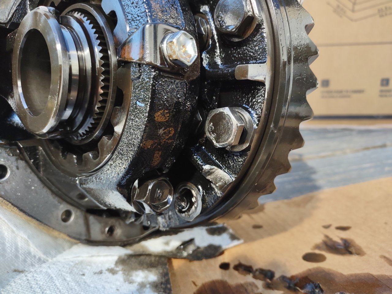

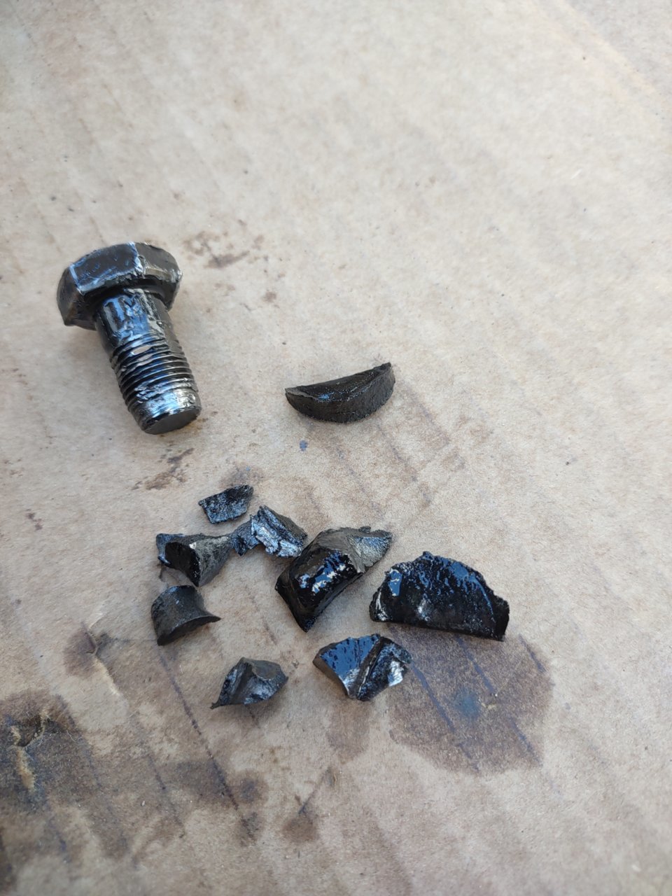

    So after my last post, I parked my truck til the following Friday. Wanted to unload the camper to take it in for an oil change so hopped in to move it... Nope. Rear end was locked up. Week later, I finally pulled it apart with some help from Mike. Multiple bolts backed outta the ring gear. One found loose along with hunks of metal. Another is loose jamming up the carrier from rotating. Hopefully not to $$$ a failure... But not looking good, that's for sure.

    Ooof…that sucks.
    I had a ring gear bolt come loose and punch a hole in the rearward part of the rear diff.
    I was super luckily that was all the damage.

    I'm just glad it gave up where it did, and not on a trail or miles from home with a trailer behind me.

    didn't you just get those rear gears less than a year ago? Any luck with warranty?

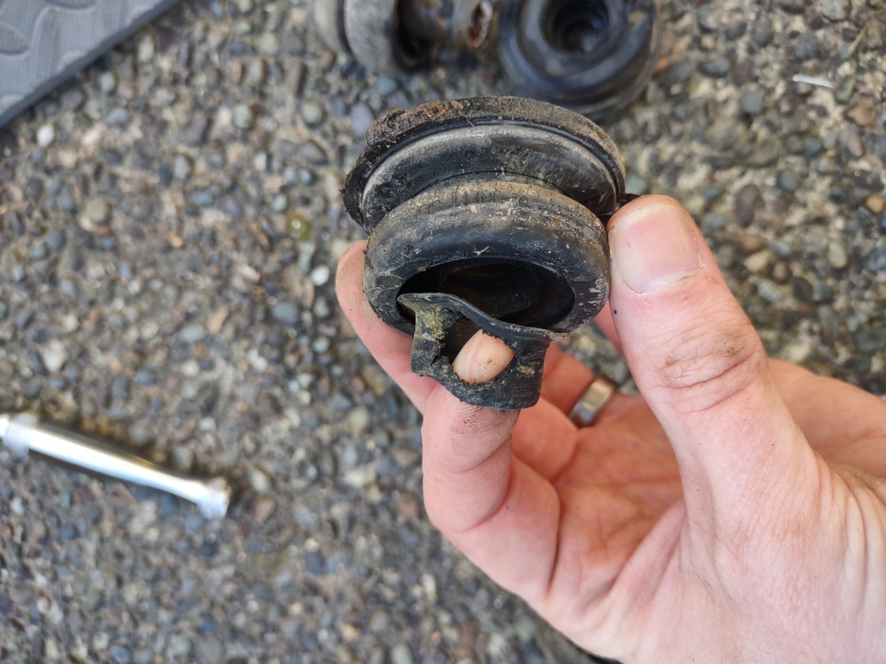

    After the Avants Offroad event the other day I had to look into the intermittent clunk that became a full time clunk in the front passenger suspension.
    Pushed and pried on everything on the suspension and seemed tight. Noticed the front body mount bushing looked sad and after watching some vids it sounded like that might be it. Bought and installed the 9.4101g bushings. Super easy install. Sadly, that wasn't my clunk. But after installing those I found my sway bar linkage was loose. Was parked just right and it was unloaded and could push and pull it through the spindle. Threads were destroyed for about 1/4 inch. Bought a couple washers and tightened it down and NO MORE CLUNK!
    My Buy-Nothing antique Handyman Harrah hi-lift jack came in handy, too.
    Those bushings were shot...

    Glad you found the clunk!
    I had one that took forever to locate. It turned out it was my driver side fender hitting my ARB bumper. At some point I tore the ends of the frame off.
    After welding new frame ends on and adjusting the bumper's position no more clunk.

    My arb just rubs on my fender when I articulate a bit. Just enough to keep the paint rubbed off and no rust on the bumper since it's always polishing it. No noticeable sound there, but will keep it in mind next time I have a new sound to dig into!
