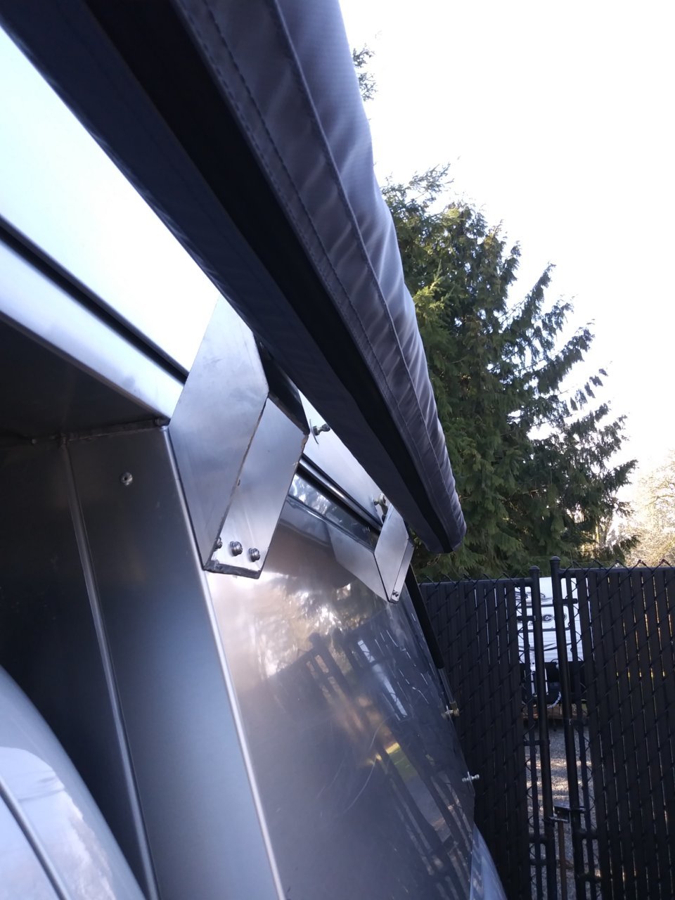

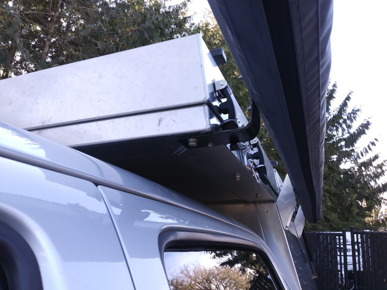

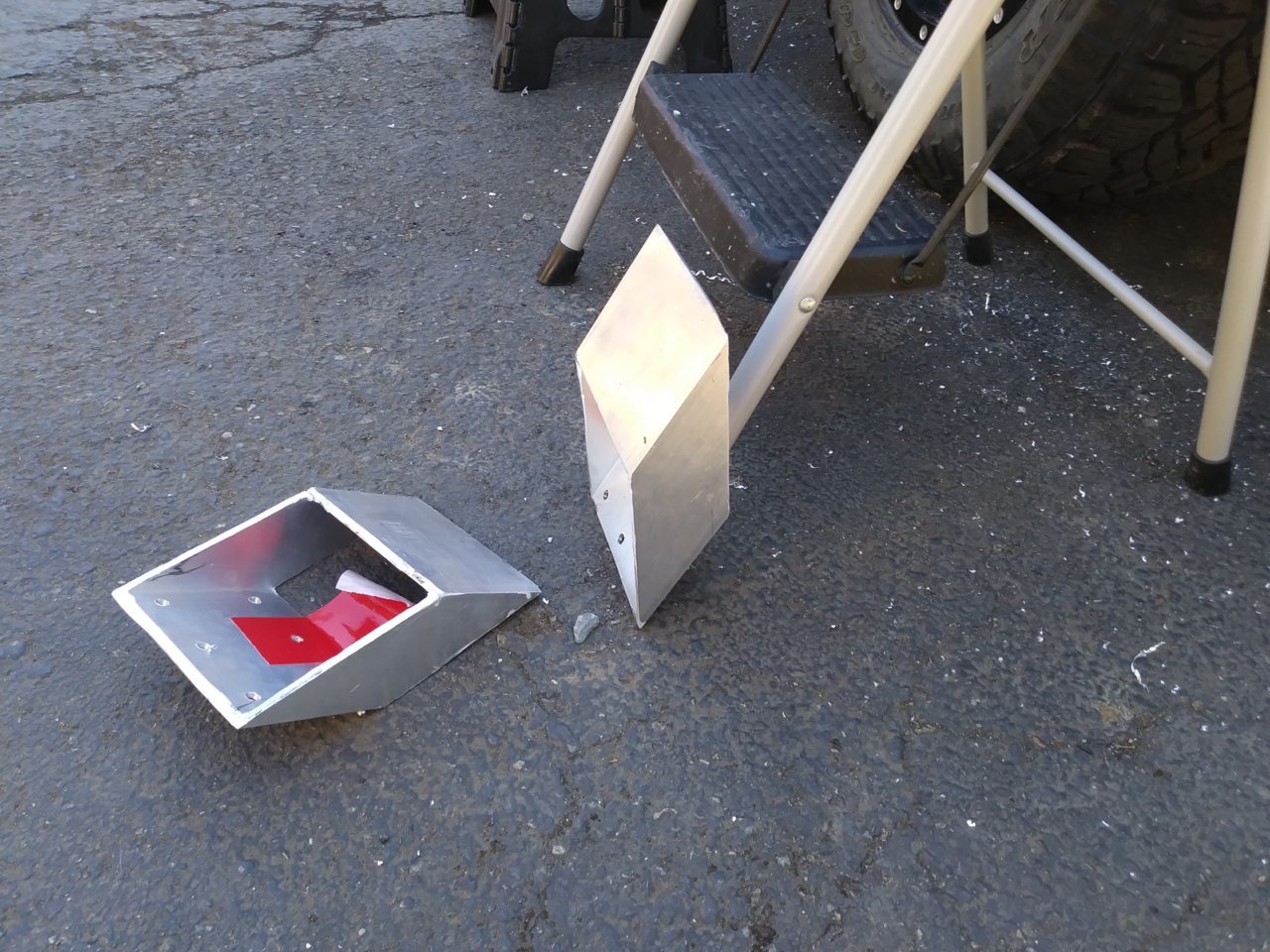

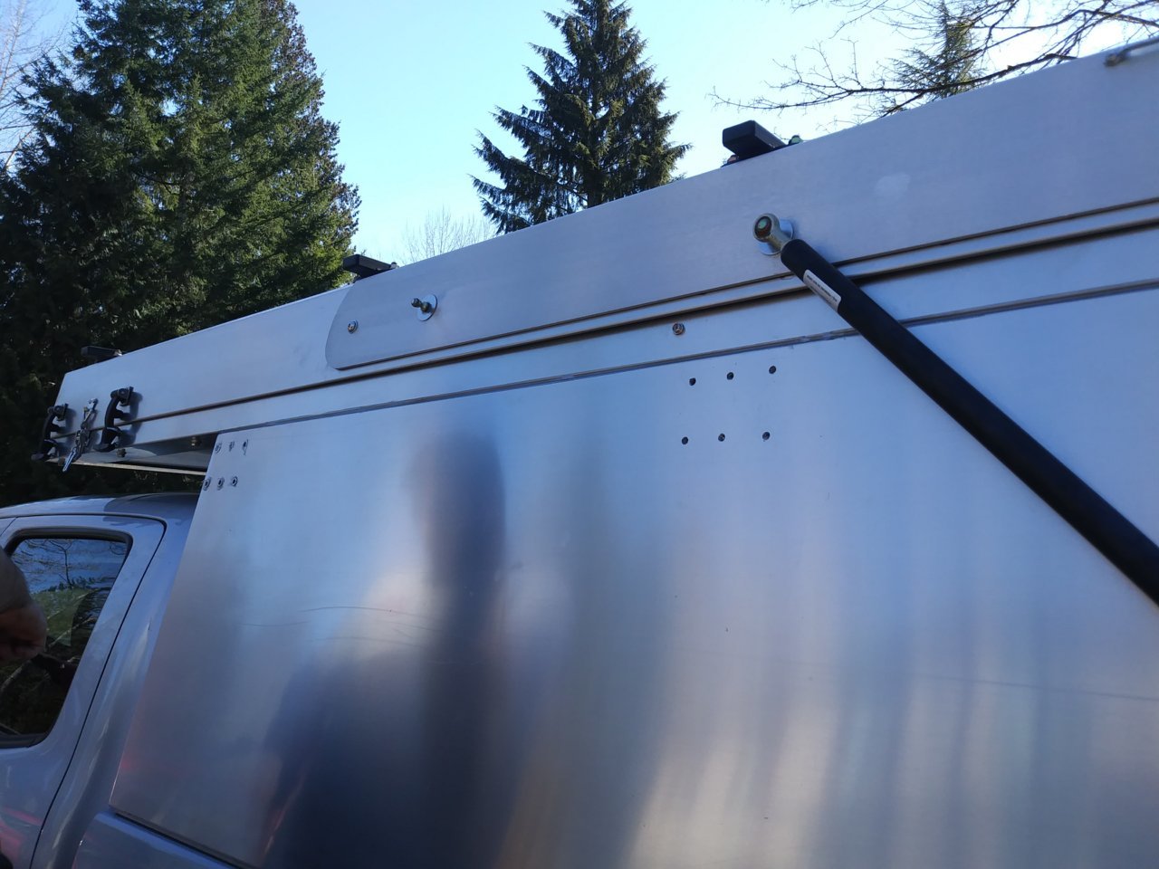

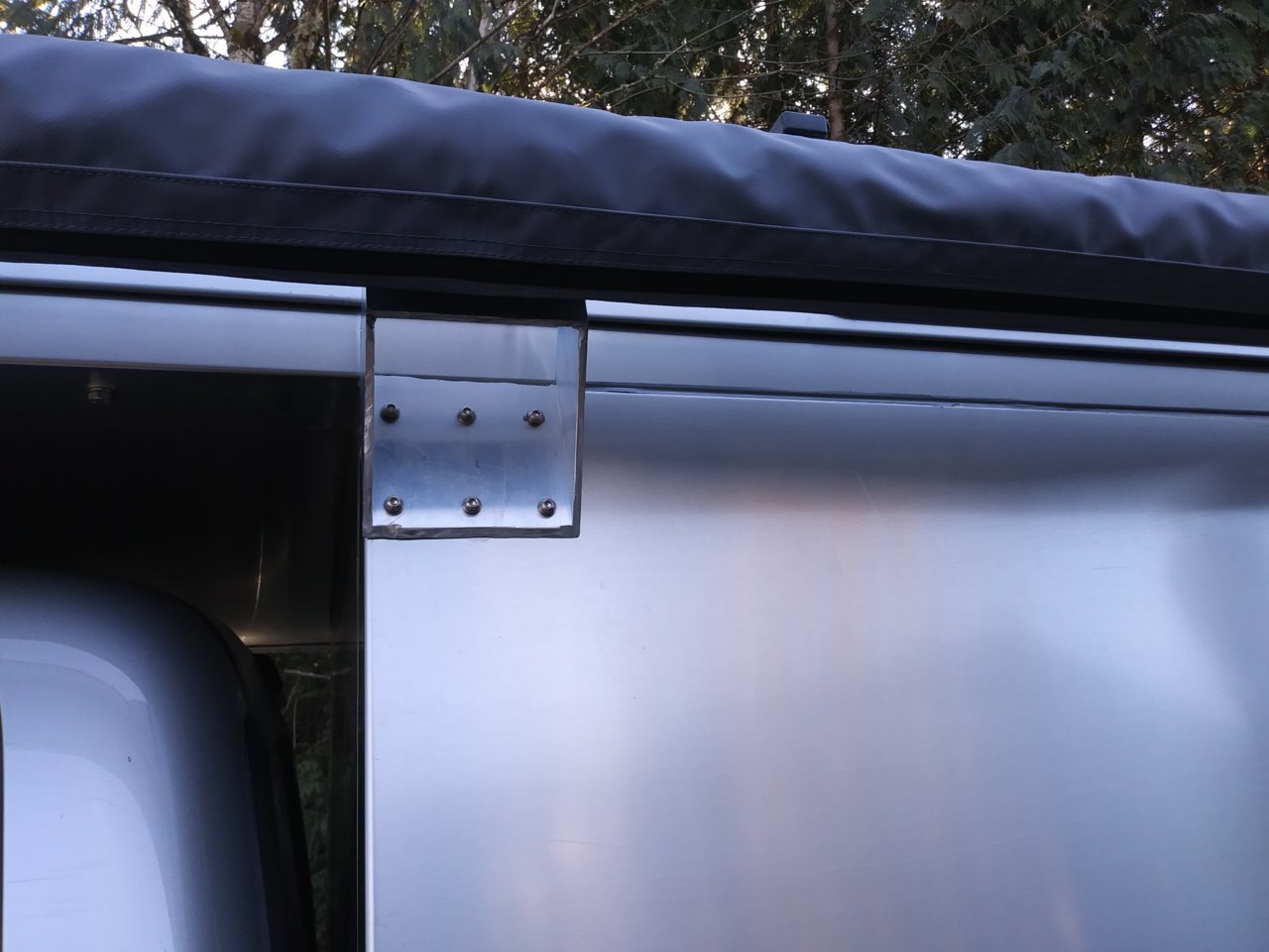

    A dozen holes were drilled in the side of the Habitat and nutserts installed.
    I purchased 12 inches of 3x5 aluminum tube, I think .1875in? Cut it into 2x 4 inch long sections at about a 45 degree angle. My cuts were pretty crappy with a cutoff wheel. A nice chop saw woulda made it much cleaner, but o well!
    The standoffs coulda been another 1/4 inch further out to help clear the Habitat's gas strut, but a couple washers did the trick between the awning and the mounts.
    These things are stout!
    Used a piece of flat steel to make a simple bracket up front. Used the existing bolt as well as one more nutsert to hold it in place.

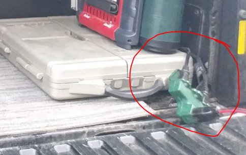

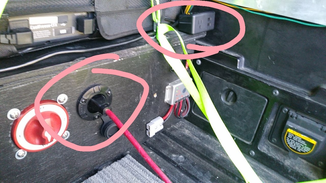

    I've been wanting to get rid of this mess of cords coming from fridge and battery charger...
    So I added a NOCO shore power plug to my battery box to clean up the cords. I also added a single outlet 110 with dual USB outlets for when I'm hooked up to shore power. I did contemplate running the NOCO plug on the outside of the vehicle, but it was MUCH easier to just do this. And the cord easily fits through with the Habitat closed up against it's rubber seal.

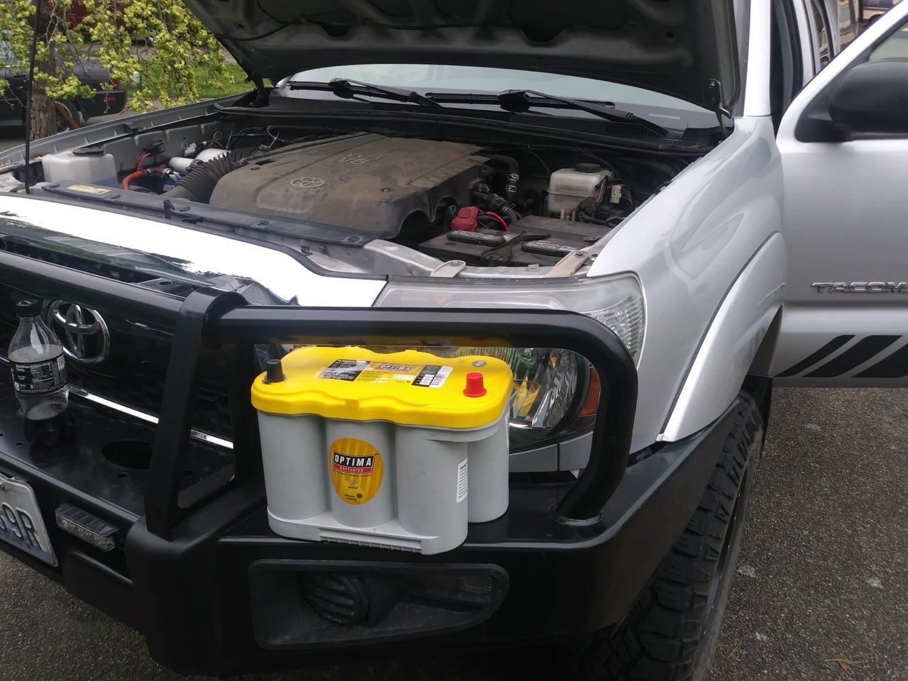

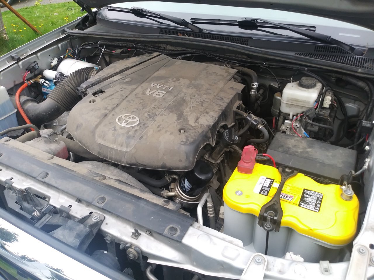

    Swapped out my original battery. Got tired of self-jumping off my house batteries.
    So here it is, my third Optima. Went with yellowtop since didn't need the extra terminals the bluetop house batteries have.

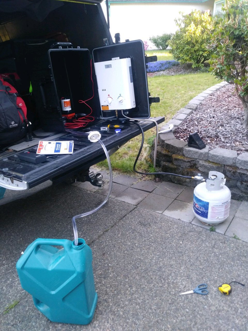

    So I tested out my water heater last night. Almost works too well. This thing can go through water FAST.
    The build was actually relatively simple. As I didn't want to drill the case I decided I'd mount 4 wood blocks, probably about 2x10 inches or so each, to the water pump and the water heater. For the water heater, it is screwed into the blocks which run horizontally, one at the top, one at the bottom. The water pump is attached similarly, with the blocks running vertically. I then used JB Weld to adhere them to the case. I did the water heater a day earlier so it had time to fully cure before I sat it upright.
    I added a 12v plug to the pump for any standard cigarette style port. I didn't add a switch, but I could see that as being handy.
    The water and shower hoses easily fit in the case without having to disconnect them. The propane hose was too rigid to leave attached. With a 90 degree elbow, it probably would have been fine, but I just used what came with the water heater. It's easy enough to screw on that hose when setting it up. If you wonder why the heater is attached so low on the door, it's because I left space for the heat shield to be left mounted, but I forgot to put it on in the pic below.
    I'm planning to buy a velcro pouch and attach it above the water pump to hold a couple small crescent wrenches and possibly roll the 12v cord into. I think that will help keep things organized. Ultimately, the plan is to mount this to a rear swingout (Brute Force Fab, I hope) in place of a spare tire. Next to it will be the propane tank and water cans, making everything easy to setup.

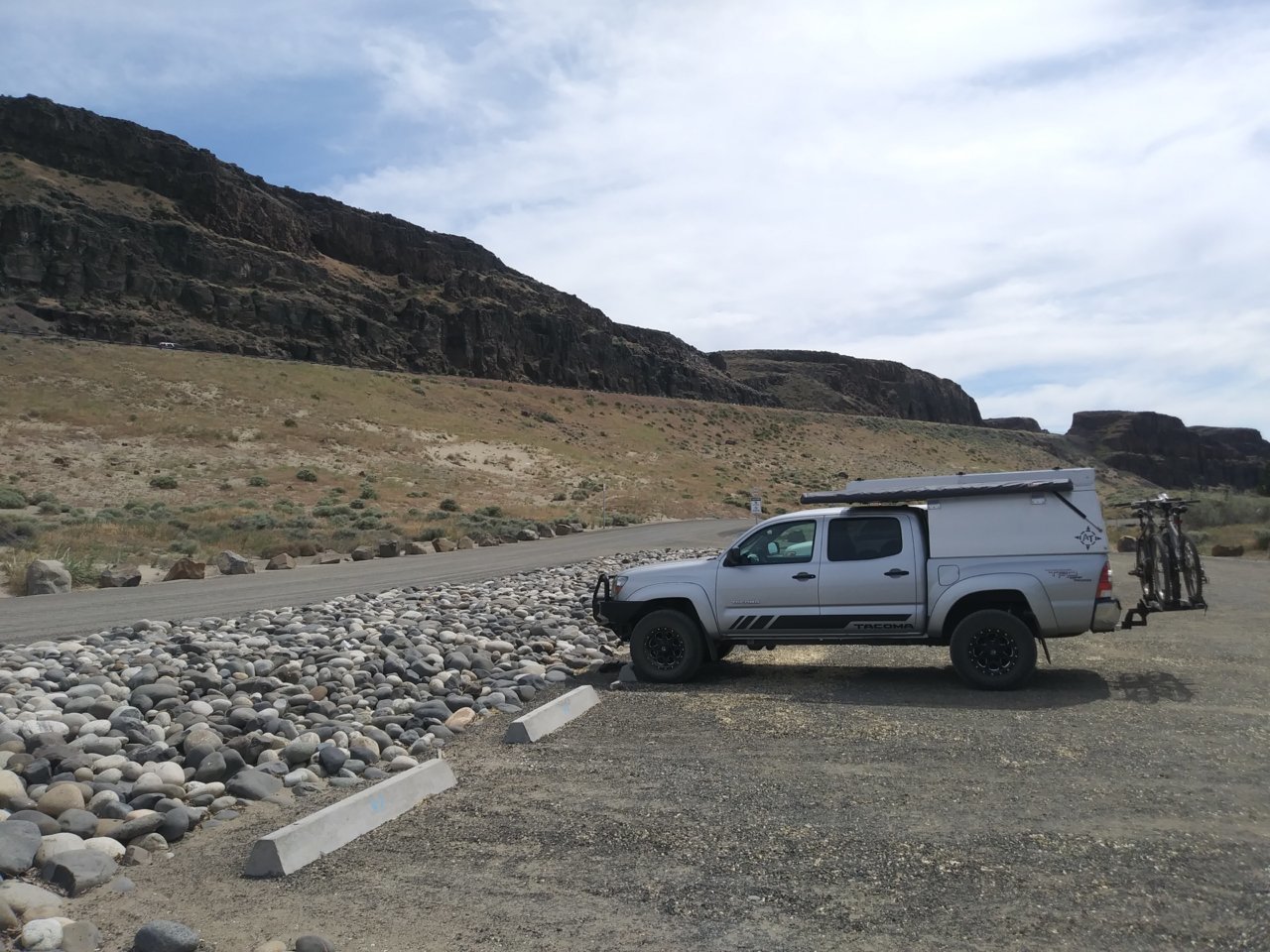

    Nights 22 and 23, this time out at Sun Lakes-Dry Falls State Park, WA. First time staying at a proper campground. Wasn't too bad. I'd do it again for sure.
    Was the first time using the ARB Awning Room. Loved it. Sadly though, raccoons did a number on the screen. Gonna need to patch that. Just about a 2 inch hole and a couple other lil snags.
    I need to do a better job of taking pics... Got one of the truck, but not of the beautiful canyon walls or the lake we floated around in for a bit to escape the heat after a bicycle ride.
    This will prolly be our last camping trip before our Habitat's 1st birthday. 23 nights doesn't sound too low. Hopefully can do better in the coming year!
