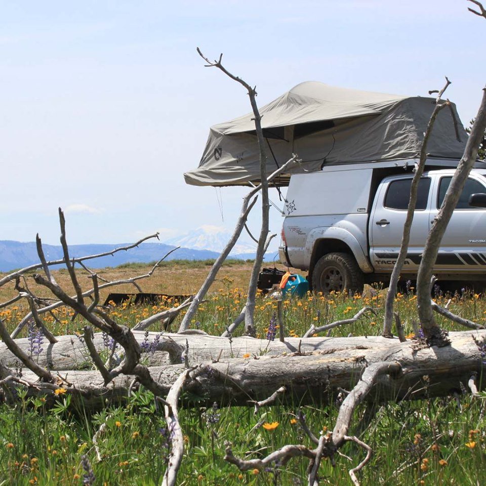

    My wife and I headed back to Bethel Ridge on Wednesday night. Got to our camping spot around 10:30PM thanks to a 30 minute wrong trail detour that shoulda ended at a downed tree... Which instead I thought was a great opportunity to try out my new Ego Electric Chainsaw for the first time (amazing btw). Finally came to a bit of a soft meadow and didn't want stuck, and at that point I knew I was off the correct trail.
    This is the second time we've camped up here, and have loved it both times. Surprisingly little traffic, especially being right on the Washington Backcountry Discovery Route (WABDR).
    On Friday afternoon the rest of the troop showed up. Had 2 other rigs and 9 adventure bikes in all. The plan was to take off Saturday morning on the BDR and head up through Ellensburg and on to the Lion Rock area to camp.
    Rim Rock Lake and dam in the distance, and farther out is Mt. Adams.
    I'm actually pretty glad we only hiked out this trail, as it had a very steep, rocky section on it.

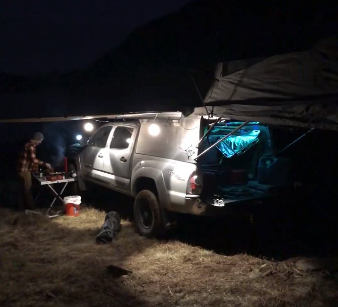

    So it looks like I finally got my 30th night in the Habitat. My wife didn't come out for this one, though. We had a quick overnighter guys only camping trip. Called it a work team building trip, since we all work together. Although I was the odd man out, an accountant among four engineers.
    Luckily I had the Habitat 95% loaded. Others didn't necessarily come quite as prepared. Steak knives? yeah, i got em. Water? yup 6 gallons. salt, pepper? Yeah, and Lawry's and dried garlic. Tongs? yup, two sets. Paper towels? yes... I'm sure I could go on! O yeah, and I'd like to add I had the fridge on all weekend... I don't think it came on once. Sure helps efficiency when the temperatures are so low this time of year.

    I managed to blow 2 fuses with the goal zero lights before I figured out what was happening. One of the linkable Goal Zero Light-A-Life 350s must have an internal short. Bummer, but the other three were still great. Now I just need to remember to replace those fuses in my battery box.

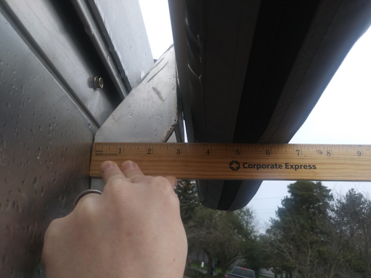

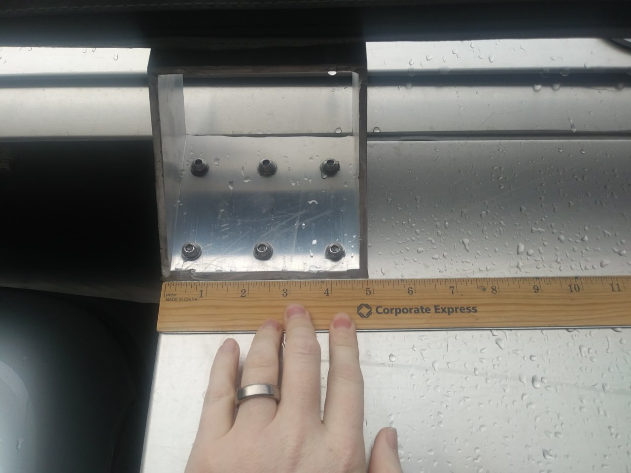

    Your awning brackets look like a great solution. Any tips, I'm planning on copying your idea.

    Only tip is to use a miter type saw if you are as crappy as me with a cutoff wheel. And make sure to post up some pics when you've got it finished!

    Did you put the 5 inch against the camper or the 3 inch side? (How far away from the camper is the awning? Thanks

    5 inch side is against the camper. The awning is somewhere between 3 and an 1/8, and 3 and 1/4 inches out from the side of the Habitat since I had to add a few washers between the bracket and the awning to clear the gas strut when the Habitat is vertical when opening (otherwise it hits, but just barely). This distance out from the side of the Habitat is good though, if you ask me, as the side of the awning room closest to the truck is resting against the truck (you can see this in some of my earlier pics).

    Last question, I hope:annoyed:. I called ARB to find out the height of the extrusion, he couldn't help me. How much face do you need on your bracket to fit the awning. I was thinking of ordering the 5X3 tubing, 1 12" inch piece (cut in 2), but when cutting the angle to to raise it up, I may loose some mounting surface. Do you think I need more than 2, 6 inch pieces. Thanks again.

    That is exactly how I did it, one section of 5x3 rectangle tubing 12 inches long, 0.1875 thick. It is plenty. I just marked at 4 and 8 inches and drew lines to cut along. Something like the below drawing I just threw together (view is of the 12 inch tall, 3 inch wide section). The triangles with the Red X are just waste material.

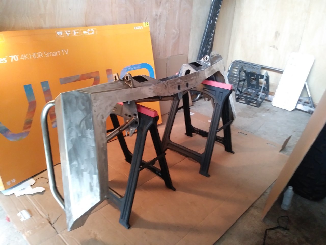

    Before and after polishing it up with the handy-dandy Harbor Freight angle grinder.0229201112.jpg 0229201249.jpg

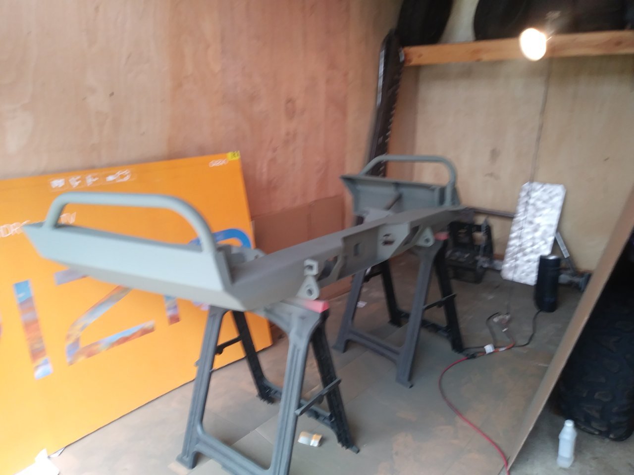

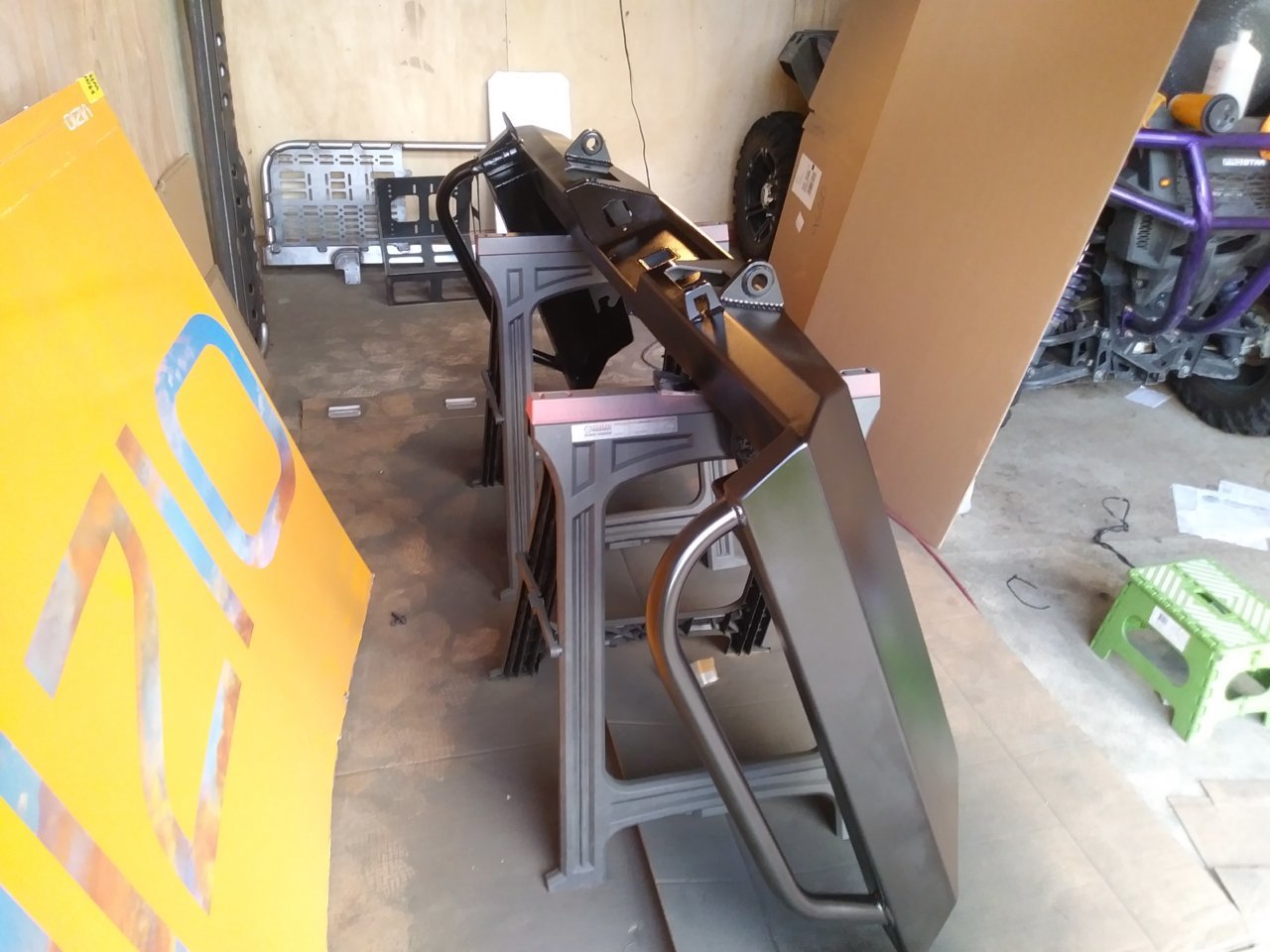

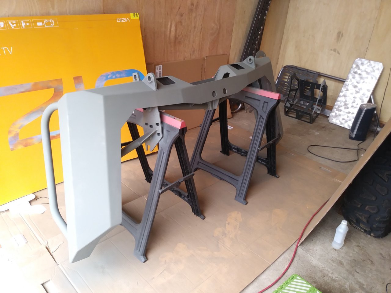

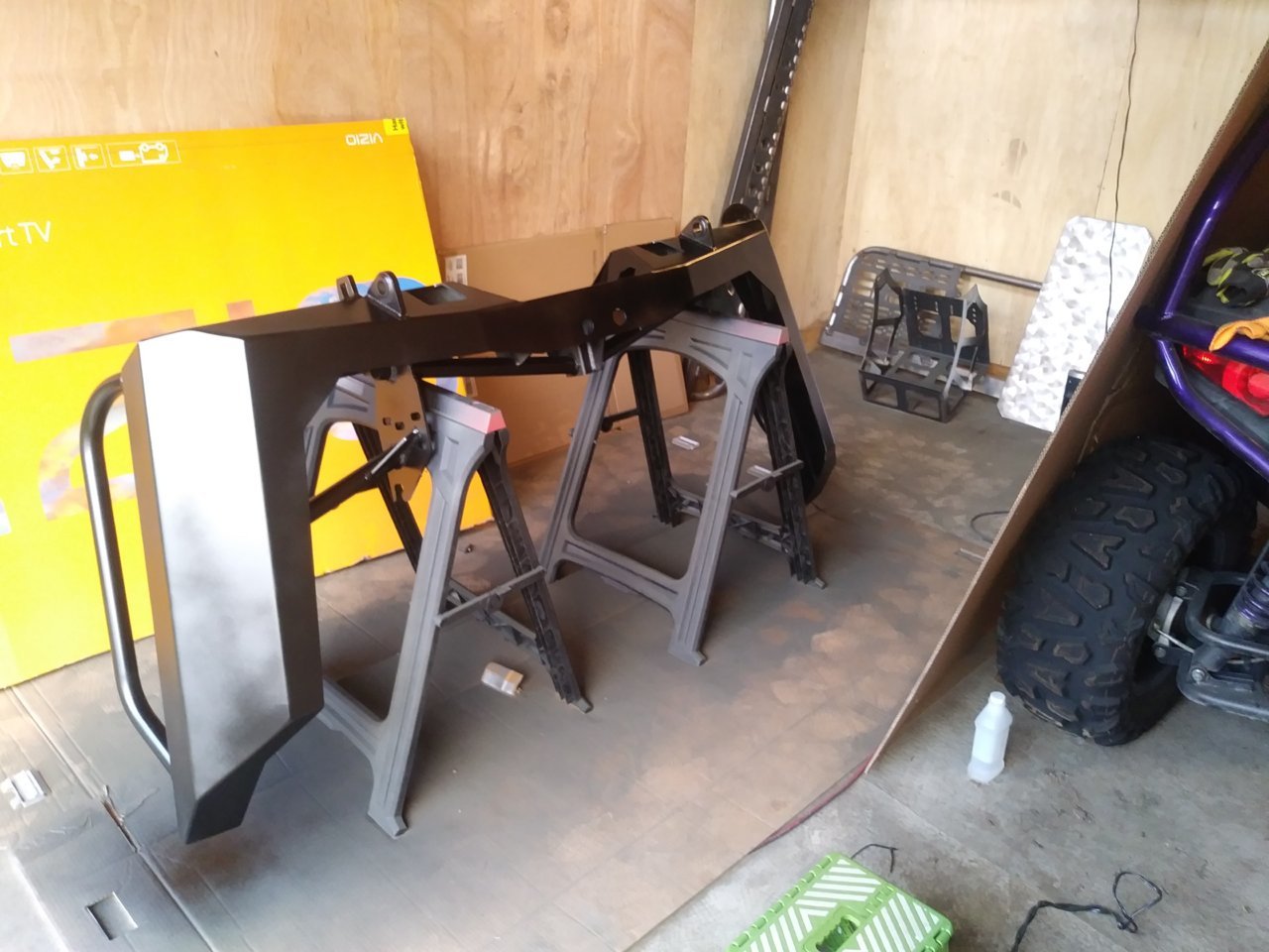

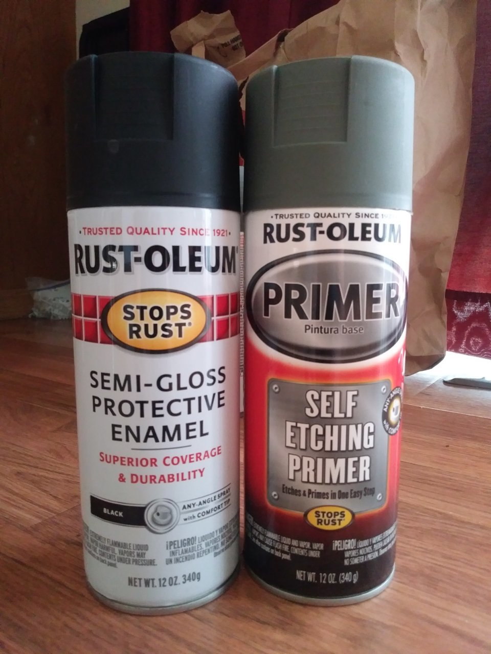

    Used three cans of primer. And oh yeah... Harbor Freight saw horses picked up for the job this morning.

    Two cans of black down. Tomorrow will swing it upright for a couple more cans at another angle.
    Still need to polish up the swingout and sliders but I'm a bit limited on space. Will take care of those after the main bumper is finished up.

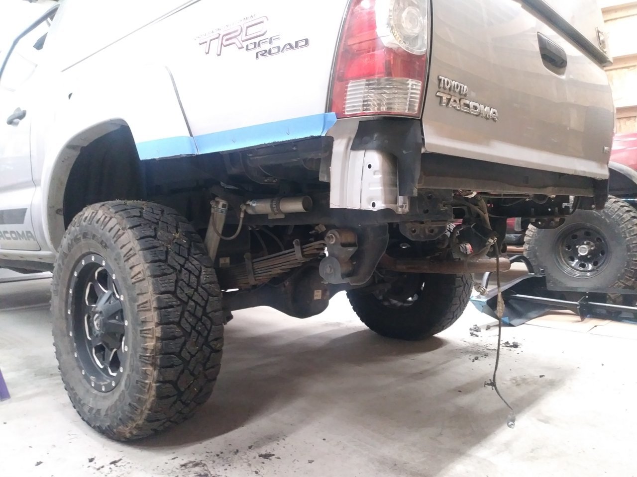

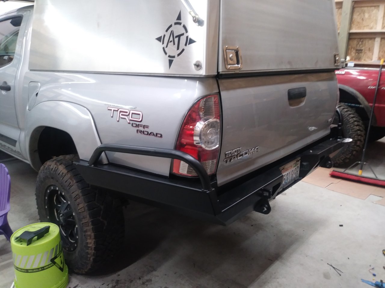

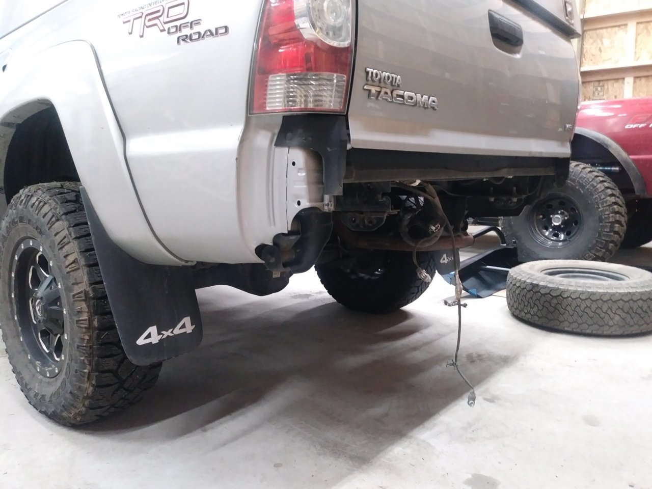

    Finally time to install the Bruteforce Fab high clearance rear bumper!
    I was hiding behind my buddy Mike trying to focus on taking pictures instead of the fact he was cutting larges pieces off my truck... I've had it since new and only started modding it in the last couple years.
    And here she is with the bumper! Still gotta finish painting the swingout and get it installed, but at least we are getting closer!

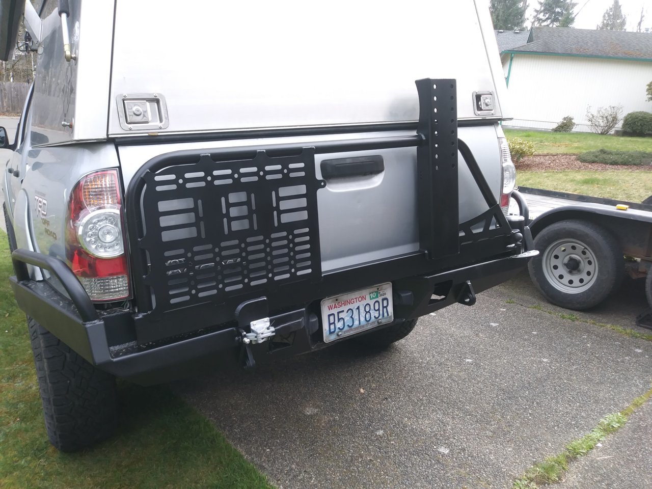

    One step closer to done. Got the swingout on, but still need to mount the camera, table, basket, etc... Got a trip planned in a few weeks, so I better get it finished up!
