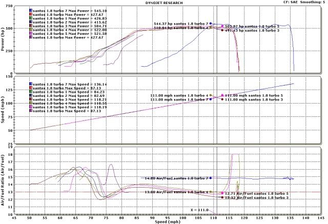

    I feel its time to show what others are claiming but have nothing to show for their efforts.
    here i will be documenting what the 2RZ will do from dead bone STOCK to mild and build turbo set ups.
    my Taco is currently stocker then stock under the hood and will make baseline dyno pulls this coming monday on the same dyno our drag 2RZ dyno'd at.
    so as of right now here is the dyno sheet for the 2RZ Corolla
    Block
    Arias pistons
    Pauter rods
    stock bore
    Head
    spings/retainers
    stainless valves
    stock ports ( no port n polish NO clean up. STOCK CASTING )
    STOCK CAMS
    Set up
    Turbonetics T76 @ 30psi on C16
    Gato intake
    Mustang TB
    Haltech 2000 Platium ECU
    545whp on a dynojet
    add the 8.5% drivetrain loss
    thats about
    691HP at the crank
    this is continue to be a dyno document for otheres to refer to and there can be less guessing.
