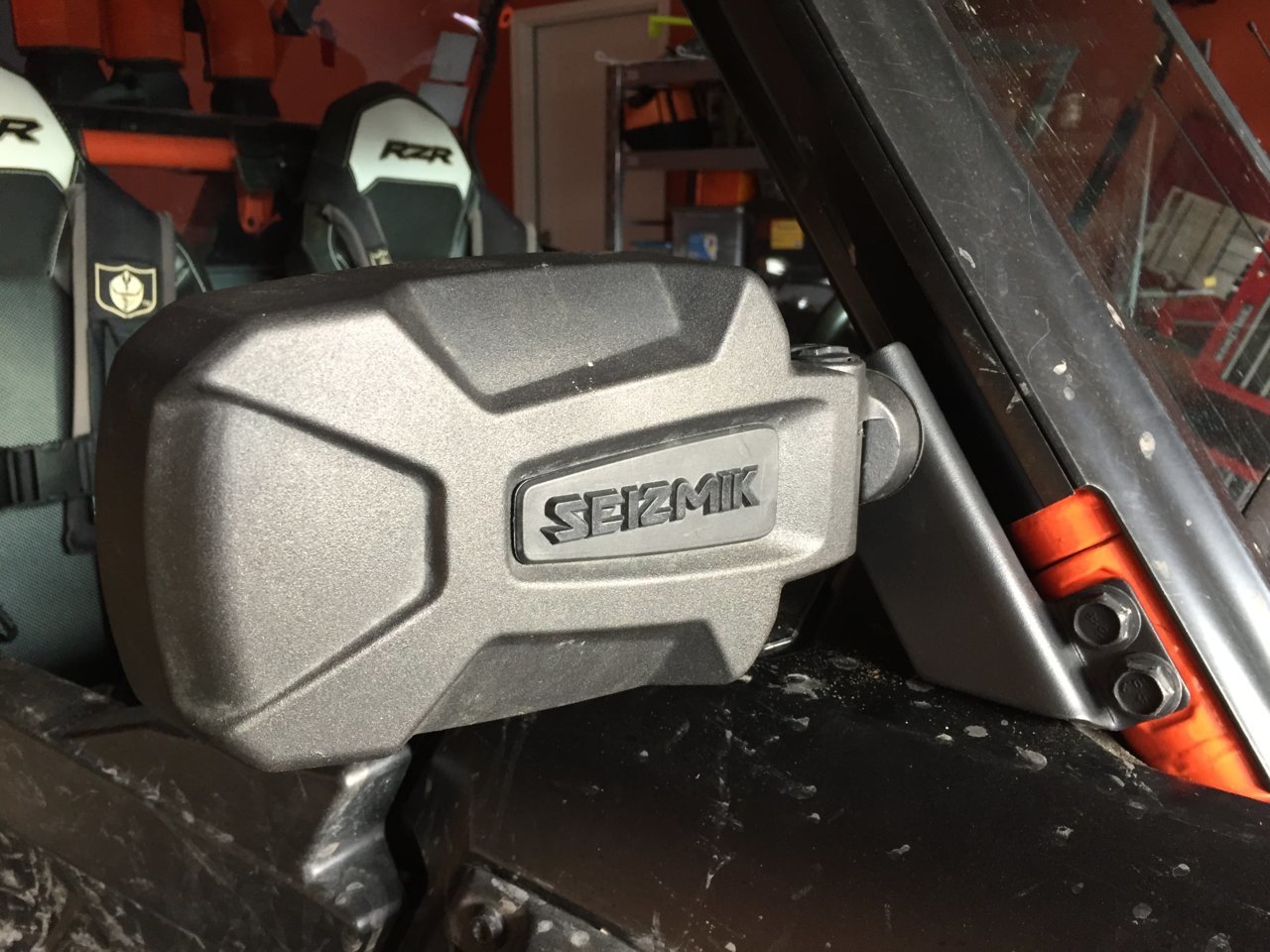

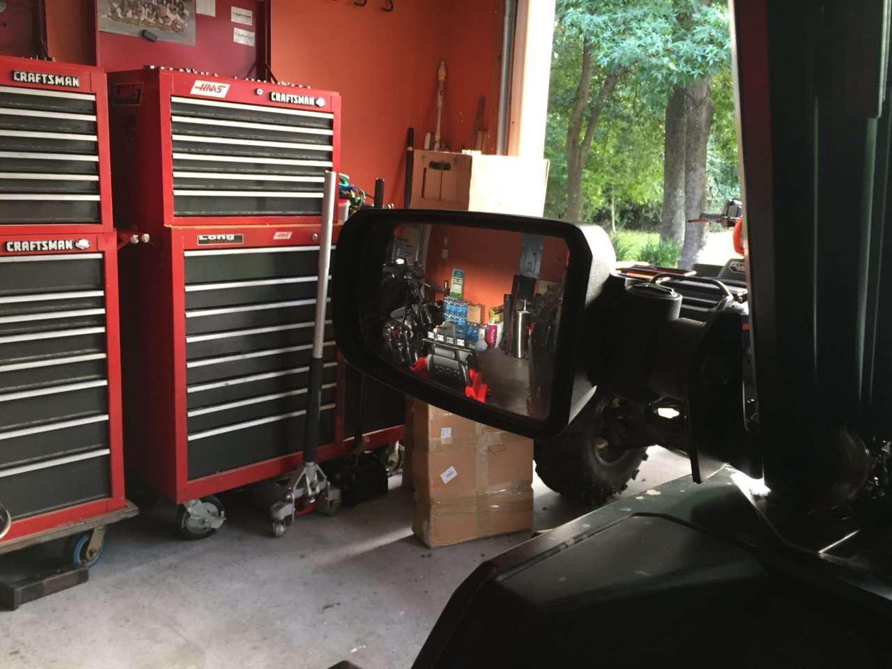

    Seizmik side mirrors installed...a definite must!

    Now we can see! I centered the rear view mirror too...my OCD was not letting that alone. :oops:

    Where did you get those from?

    These are the mirrors...they’re the full aluminum break-aways.
    https://www.amazon.com/Seizmik-Pursuit-Alum-Mirrors-18071/dp/B00T6JOS4K
    These are the optional mounts that use the rollcage bolts instead of the standard mounts that wrap around the cage. Needed these due to the full front glass windshield.
    https://www.amazon.com/Seizmik-Pursuit-Mirror-extension-brackets/dp/B01CF9R5LK

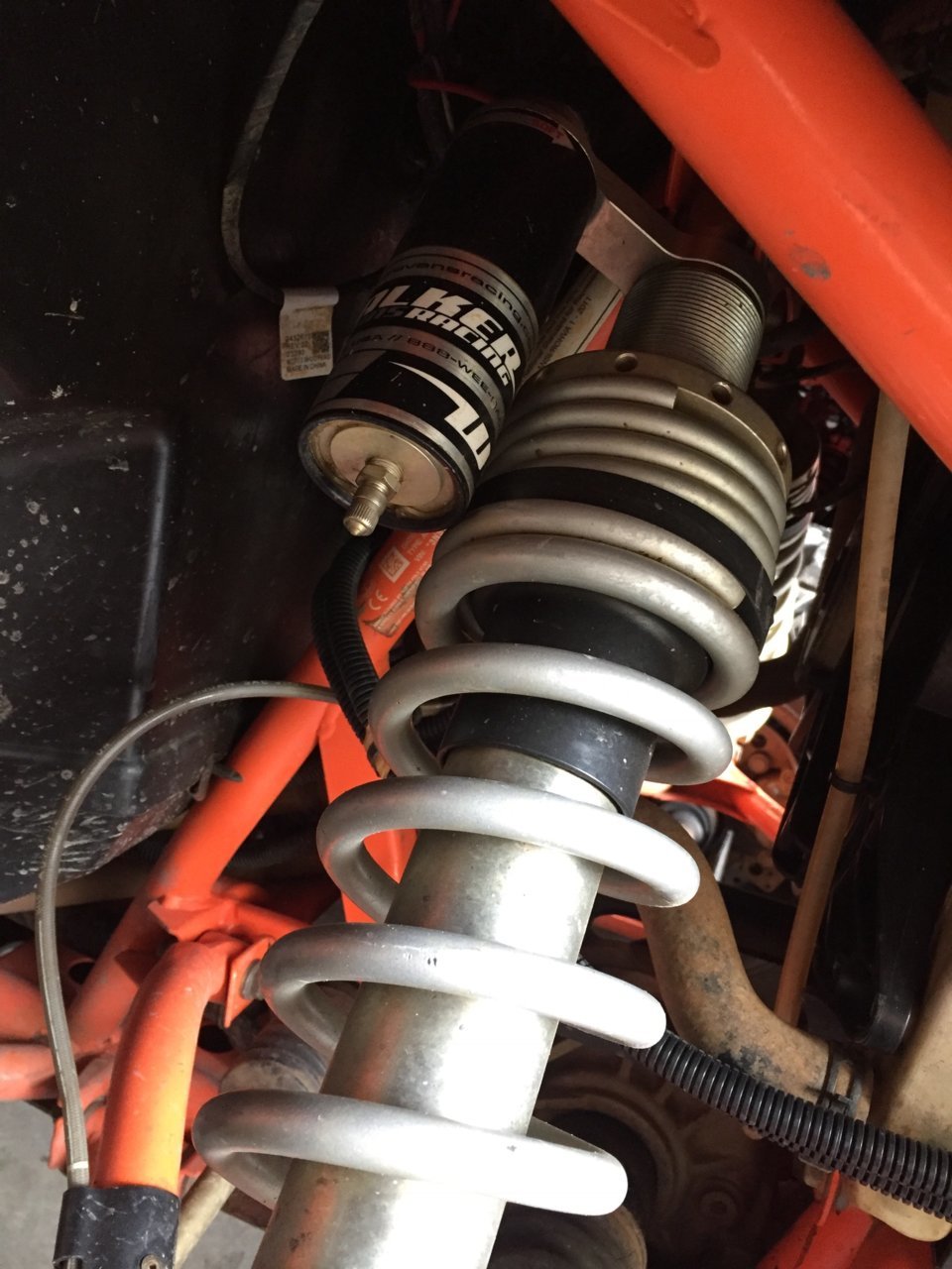

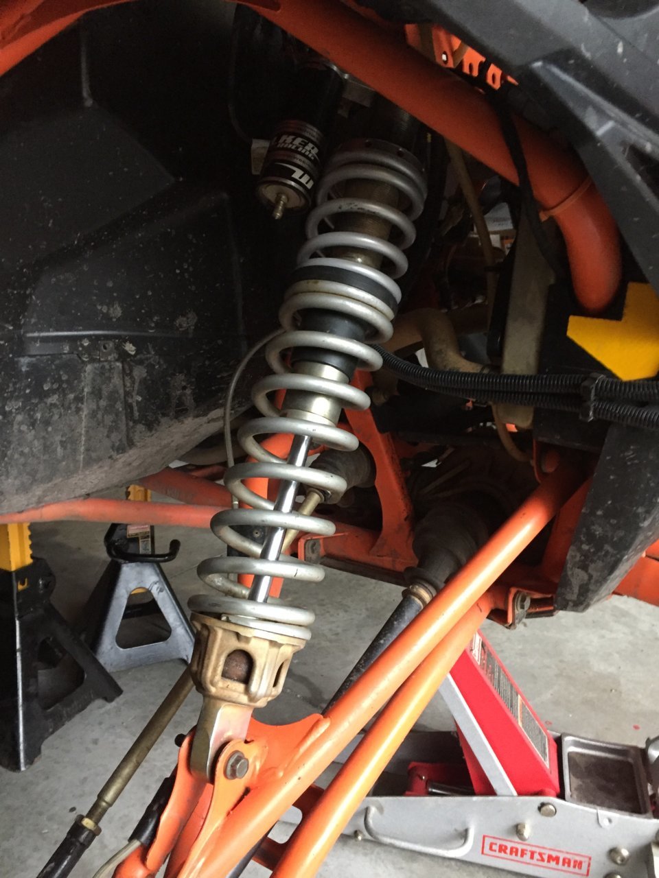

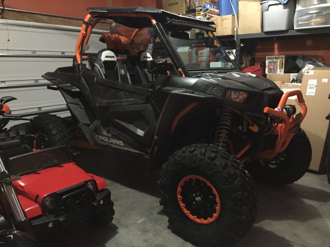

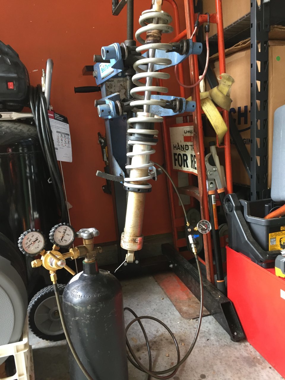

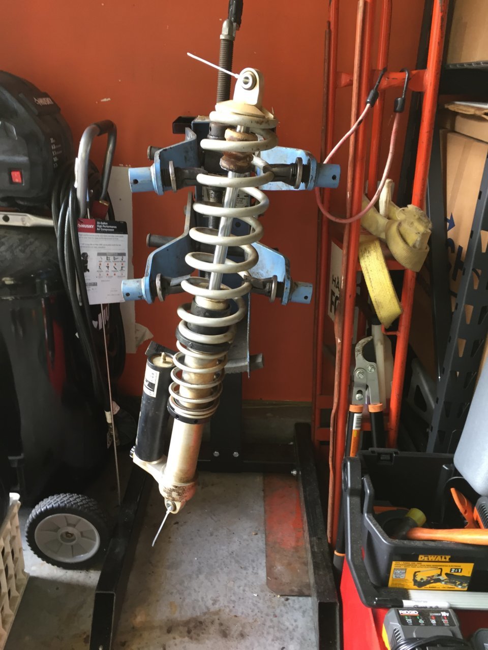

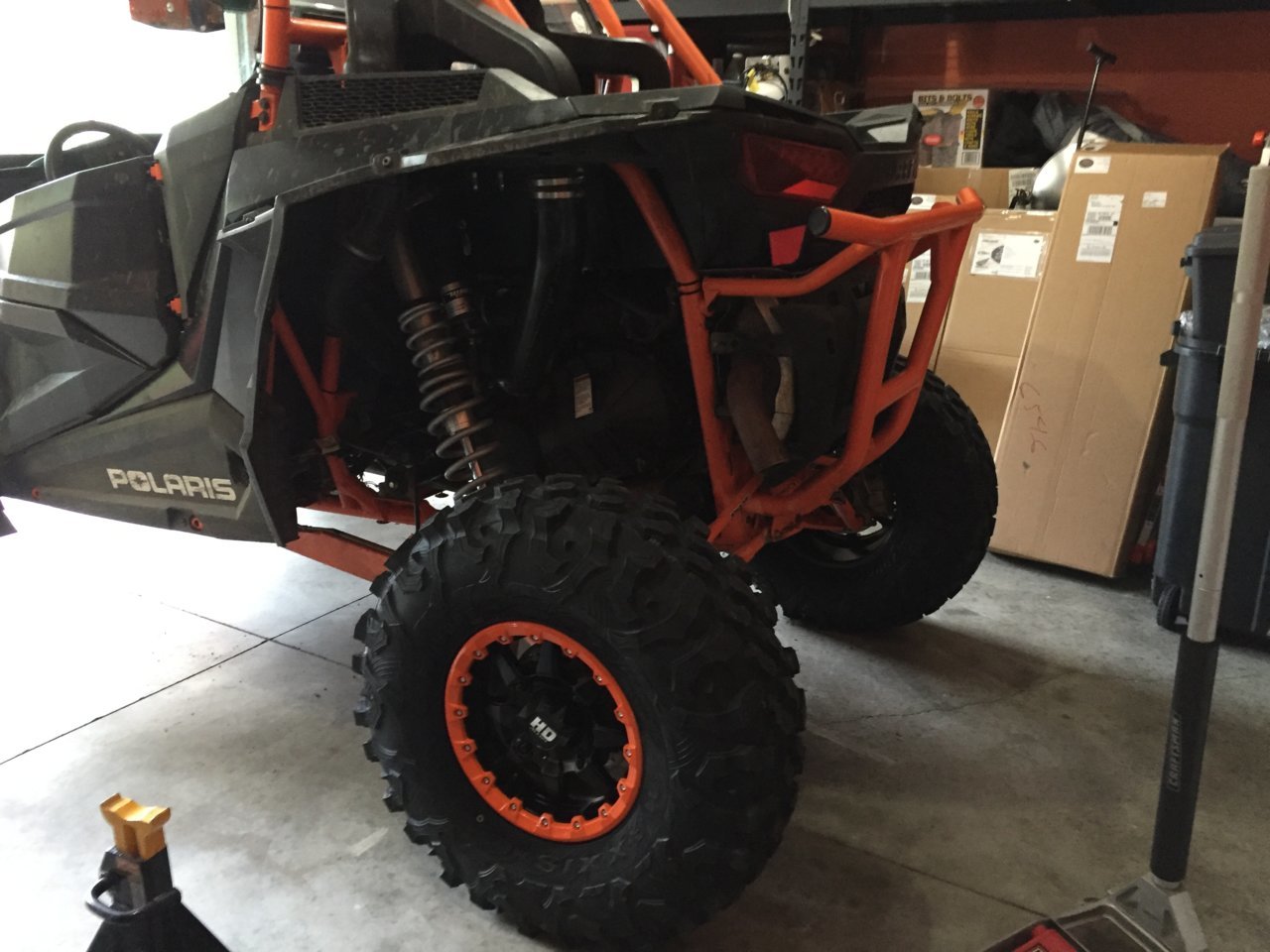

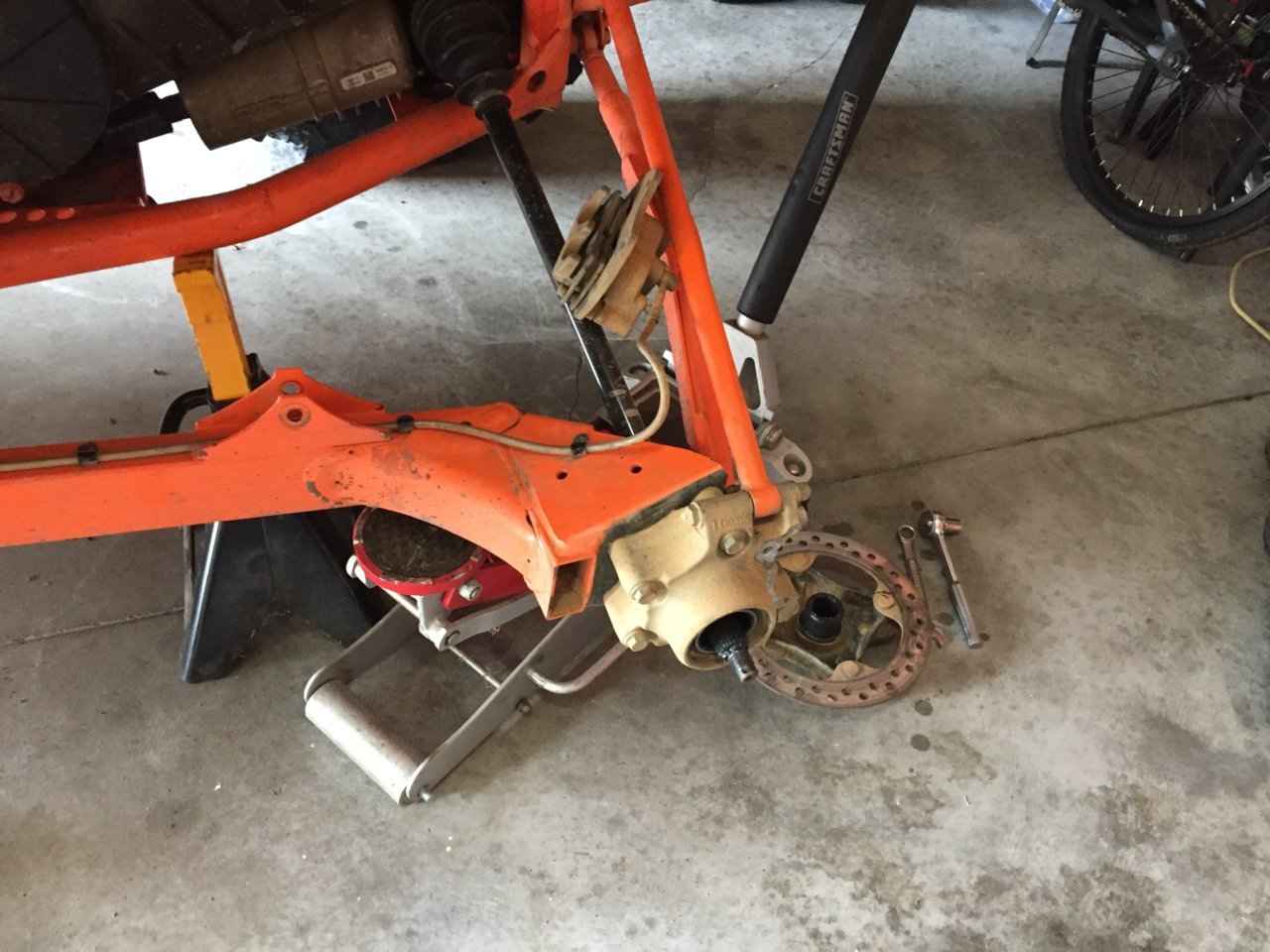

    Long day turning wrenches on the RZR with @OCD 08...the help was very much appreciated!
    Pulled all the suspension and put the new springs on. Spring compressor once again proves its worth.
    Topped off the nitrogen on all four while we were at it...nice having my own nitrogen on hand.
    From this...
    To this...
    Greased all the wheel bearings while we had it apart but found that new bearings are in order. Will have new ones pressed in along with new ball joints since it’ll be apart.

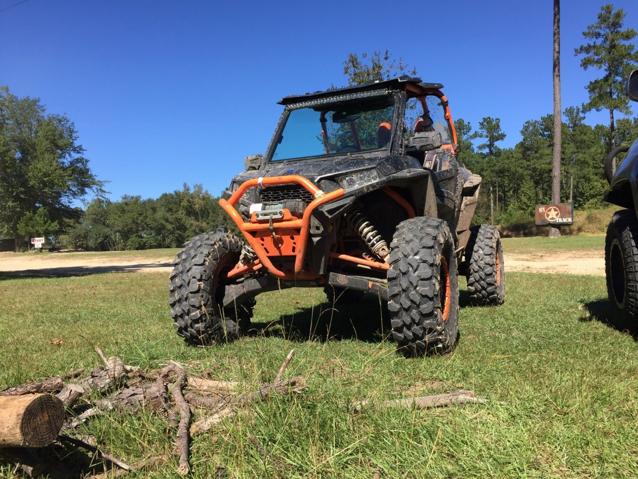

    Had to turn down the collars because 7” more lift was crazy...plus lost almost all the down travel.
    Dropped it down 4” to where it is now as pictured below but I think I’m going to drop it down another inch tomorrow morning. That’ll give it a net lift of 3” with 2” of it being from the suspension and 1” of it from the larger tires.
    Still to do: electrical cleanup with the new fuse & relay box and dual battery and new skid plates.

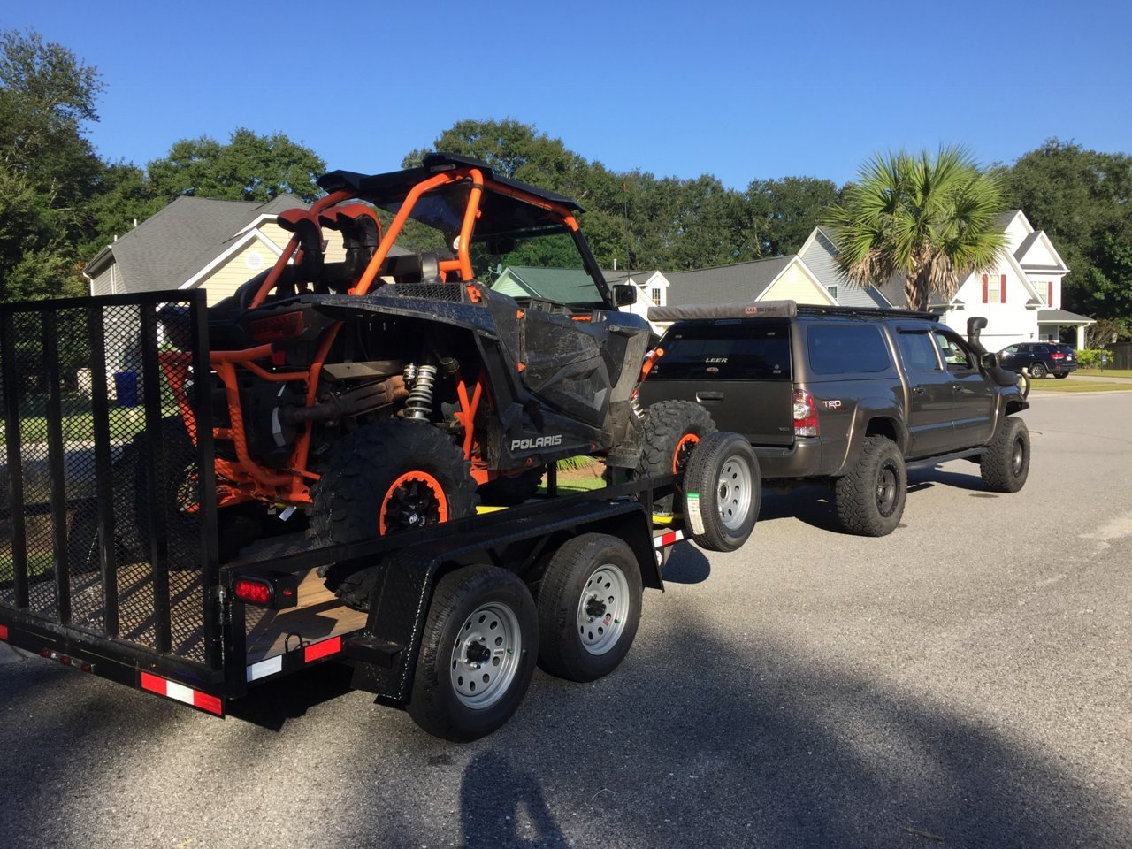

    New trailer tows like a dream...and the RZR fits with plenty of room to spare!

    @OCD 08 helped me install the new skids yesterday than came with me on a shakedown run today to test the suspension changes. :headbang:
    So ready for a weekend trip...

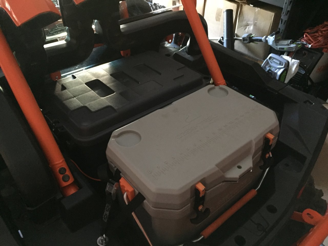

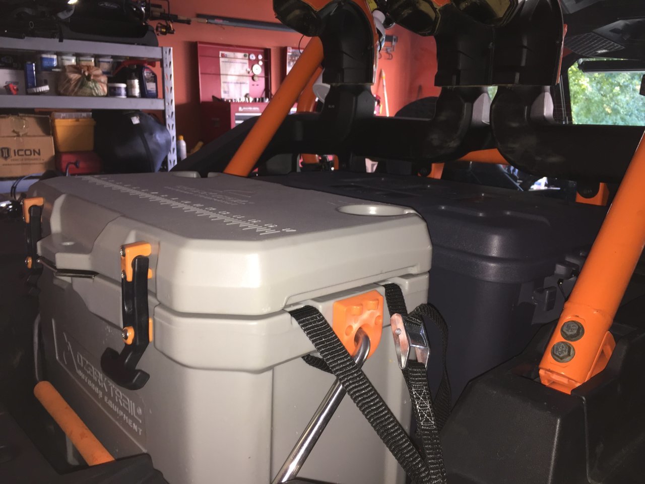

    Got the cargo area figured out. Plano box and cooler strapped down tight. Don’t have to loosen any straps to get into anything and the Plano box will keep tools, parts, etc dry and in one spot.
