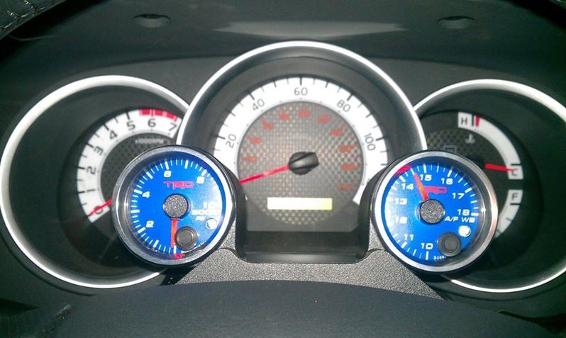

    Do you feel the flex pod covers the stock cluster to much??

    I'll try to remember to take a picture tonight. The one i have isn't obtrusive in the dark, and I haven't added it to a dimmer.
    The blue innovate AFR gauge, on the other hand....damn near needed glasses on in the dark, if it wasn't on a dimmer. Wow that thing was bright!
