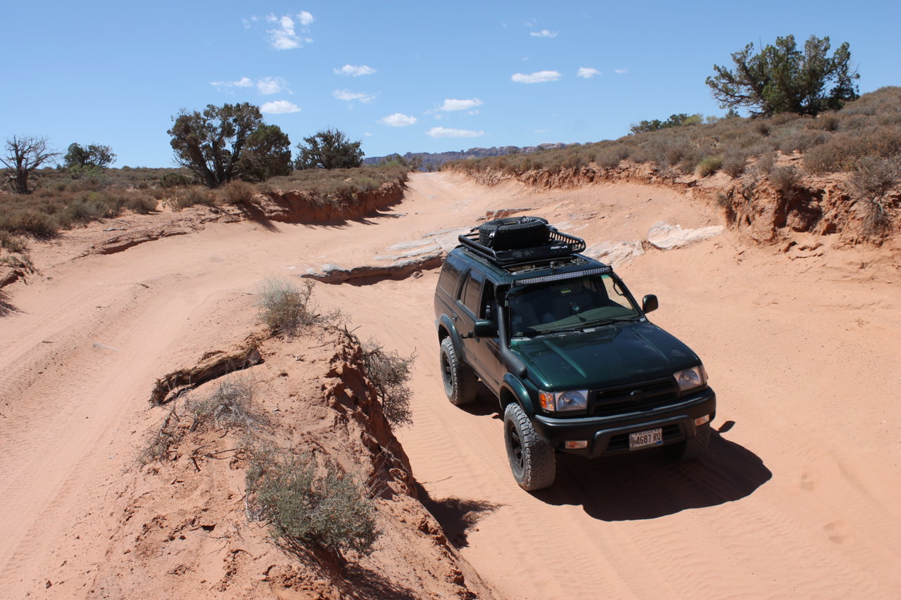

    Hahahah is it the Hilux snorkle?? I had that one on my 3rd gen 4runner and it worked flawlessly for about the same price!IMG_4718.jpg

    No it's a new one that just came out a few months ago, the Hilux was the other cheap one though. The one I've got goes directly into the fender closer to the passenger door, doesn't run along the side of it. Slightly different design
