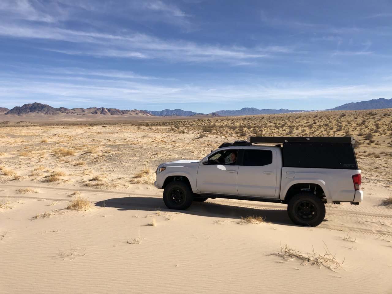

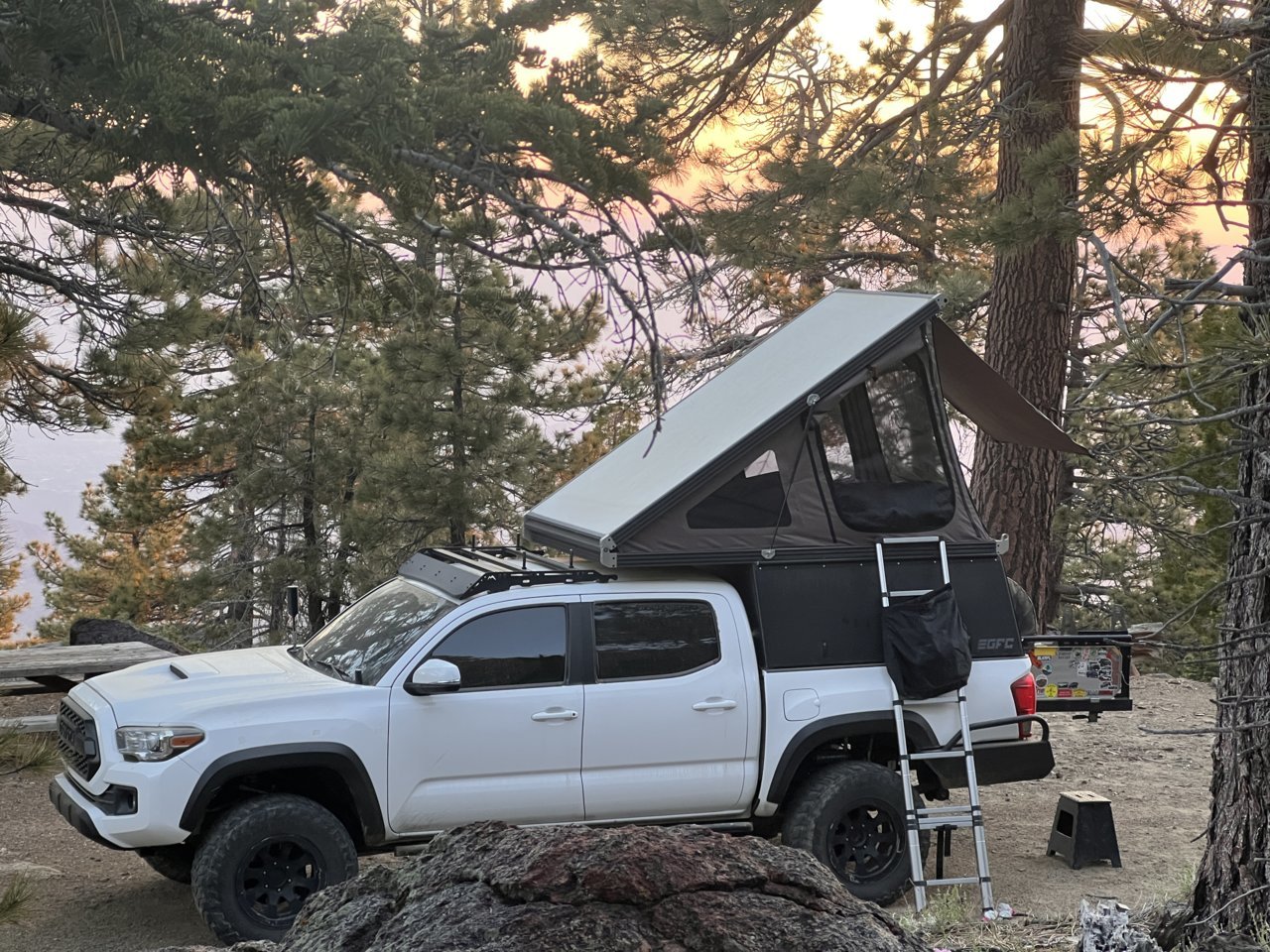

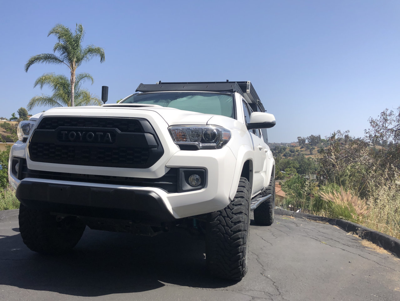

    2017 tacoma TRD sport DCSB
    Purchased new.
    King 2.5 remote reservoir 700lb 14in coilovers
    Built Right UCA
    CMC - the Truck Shop San Diego
    Spindle gusseted - the Truck Shop San Diego
    Cam pocket gusseted - the Truck Shop San Diego
    RCI Offroad engine skid plate aluminium
    RCI Offroad transmission skid aluminium
    Exhaust reroute - the Truck Shop San Diego
    Pelfreybilt weld on sliders with kickout @desertjunkie760
    OME Dakar HD leafpack
    King 2.5 remote reservoir with adjusters rear shocks
    17 inch AE wheels
    285/70-17 toyo open country MT tires
    Total Chaos bed stiffeners
    Timbren-Industries active offroad rear bump stops with Ubolt flip kit
    Bruteforce Fab HC rear bumper, single swing out, table, dual gas can holder, bedside protection tubes, Baja Designs S2 sports - brought second hand
    GFC #422 V1 embassy hinge, single side door, ladder
    Replaced GFC tent to new style dual side door (version 2)
    Mountain hatch tailgate insert
    Shittco 'Shitblox' awning hack
    Vrnclrsewnstorage frame bags, boot bag, top shelf
    Martin Off Road camper roof rack
    Josh Edgar Design step up, mag spots
    Overland Softgoods mattress topper and sheets
    Aeronaut Hoverquilt
    Sound deadened under rear seats to cab rear wall, all doors - Kilmat 80mil
    Rear differential breather relocate
    AC drain mod
    Viair 400p automatic air compressor
    @olecoot seat risers driver and passenger
    Hood flat clearcoated @d.shaw
    Ceramic window tint front / rear / windshield
    Hondo garage phone mount
    Weboost drive reach OTR
    Swapped drivers headrest with 2nd gen rear
    Weathertech floor mats
    Installed switch panel in rear cubby
    Factory bed mat
    Removed front swaybar
    Fullsize spare 285/70-17 toyo open country AT on fuel rim
    Recovery gear - smittybilt tow strap, ARB snatch strap, Maxtrax soft shackles, tuff stuff 4x4 soft shackles, D rings, rear hitch shackle
    Midland MTX115 Radio with ghost antenna
    Assortment of tools
    Painted fender flares and part of the front bumper
    Truck is built to use camping - and to be light weight as a daily driver

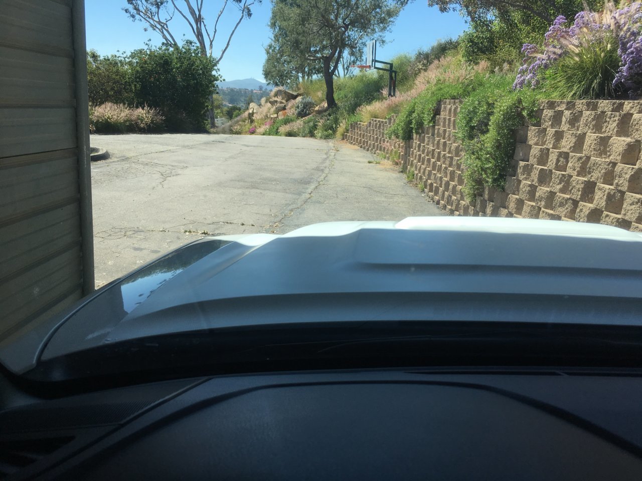

    2012 Silver TRD-OR
    Vagabond Drifter, King 2.5 coilovers, King 2.5 rear, Pelfreybilt front / rear bumpers and skids, rock sliders, Safari snorkel, Smitybilt winch, Baja designs 20in, wide cornering spots, S2 rear. Deaver expedition series stage 3 rear leaf.

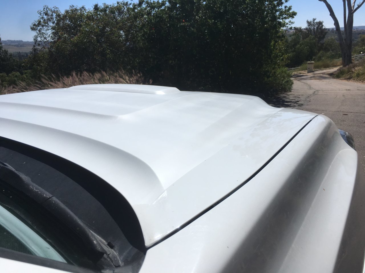

    flat clear coated hood, used a wheel paint, masked it off - def cuts down the glare

    Thats a pretty sweet idea. I was thinking of using some matte clearbra I had for a similar exercise, but you went full send :thumbsup:

    we went to a place to ask about clear bra and they told me it was going to be super expensive, which i found strange to be honest - so we decided to just spray it. i had sprayed my second gen before this and figured we would just go for it....... plus already had the paint - i like that it keeps it 'stock looking'

    d.shaw, my tacoma sport reflects lots of light from the hood, do you have more information on how to spray the hood?

    i lined up some tape (i left the sides with a stripe) then removed it, and used a flat clear wheel paint, i used a 2-3000 grit wet sand at the end, its not perfect i think had i wet sanded between the couple coats it would have been better - but you can't tell unless you are standing there looking for the imperfections. i think a clear flat wrap would be a better surface, or a paint shop.
    on my second gen i left the hood on the truck and just went for it, and sanded with the 2-3000 grit wet sand - again not perfect but is very effective in reducing the glare and cost like $10

    Thanks! Yeah, I'm not worried about perfection...its gonna get scratched. I've also looked at some 3M wrap, haven't made up my mind.

    not sure if my directions were clear, i lined up some tape and then took the hood off, was easier to spray it that way (than leaving it on the truck like i did with my 2nd gen)

    Your instructions were clear. The glare off the purely ornamental scoop is quite bad at times (especially at 45-46 degrees latitude in the winter), and is the only thing about a toyota truck I have ever disliked. I was going to ask if you liked those tents, but since you have two of them, I assume you do.

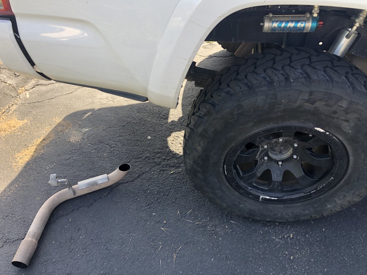

    after scraping off the front license plate on a trail a while back i finally got started on fixing it, which means paint. first....
    then cut the exhaust
