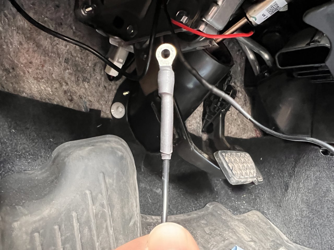

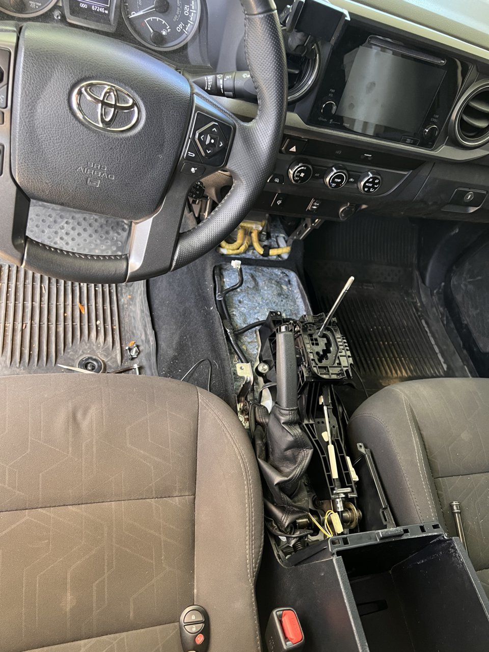

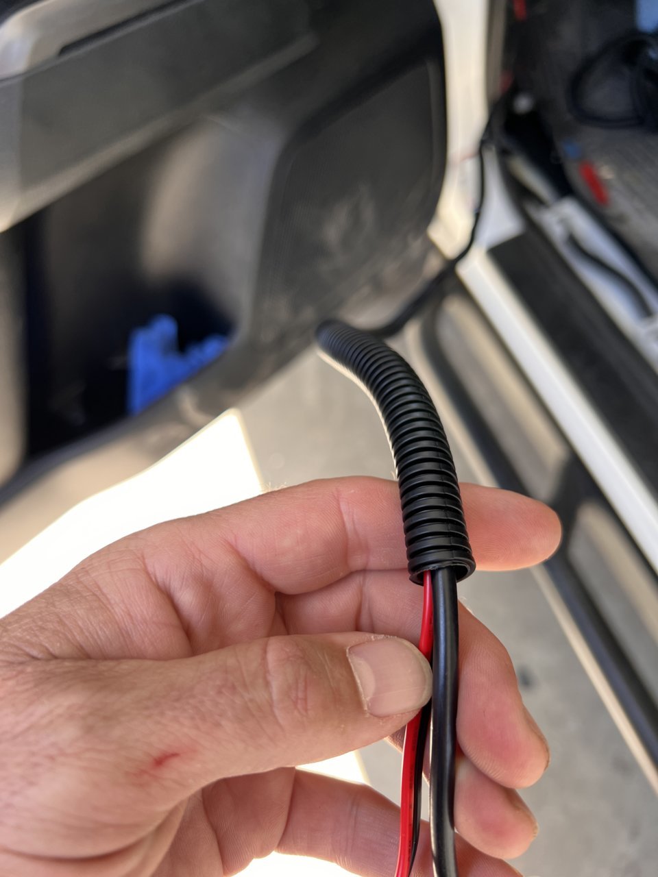

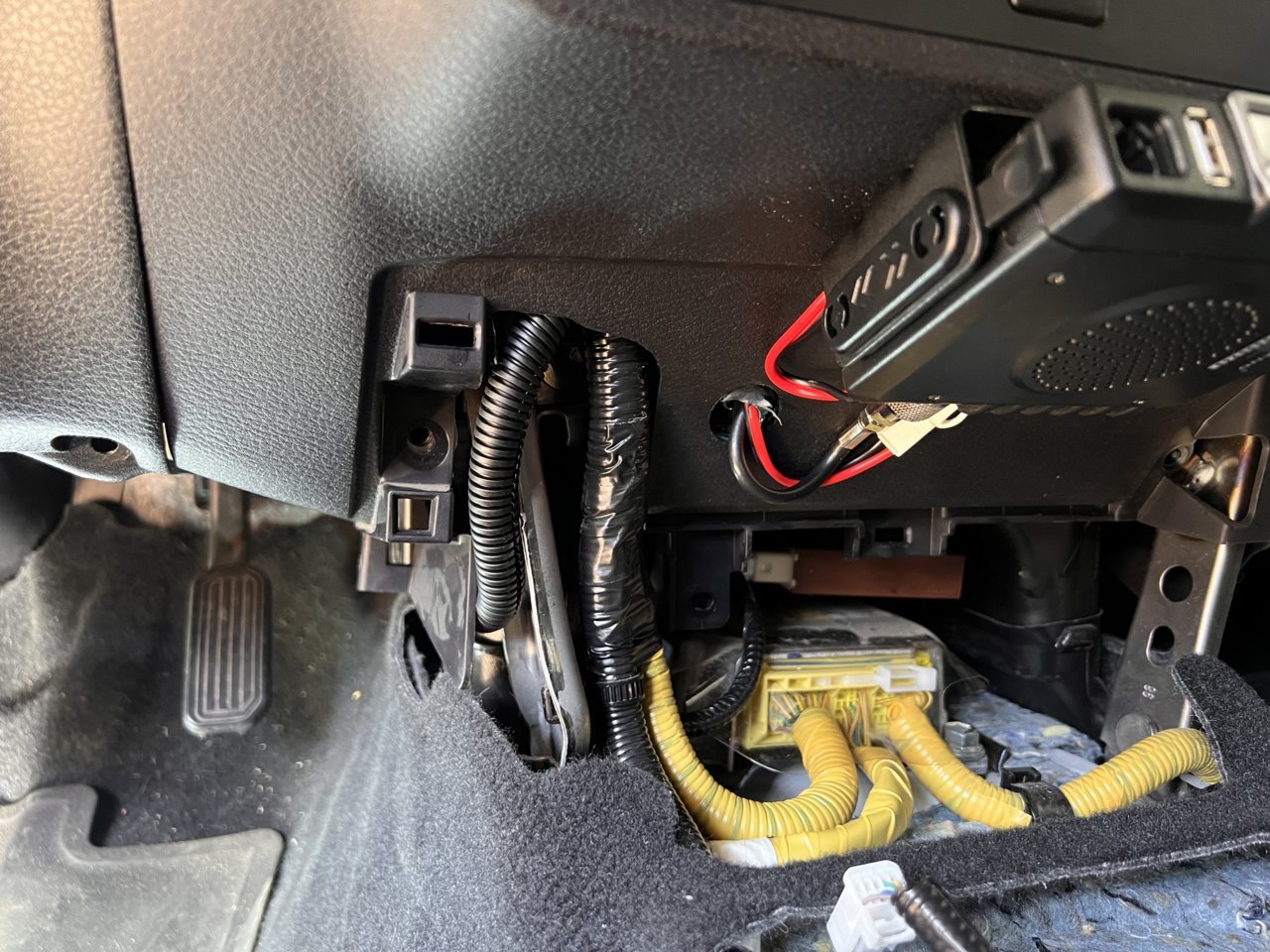

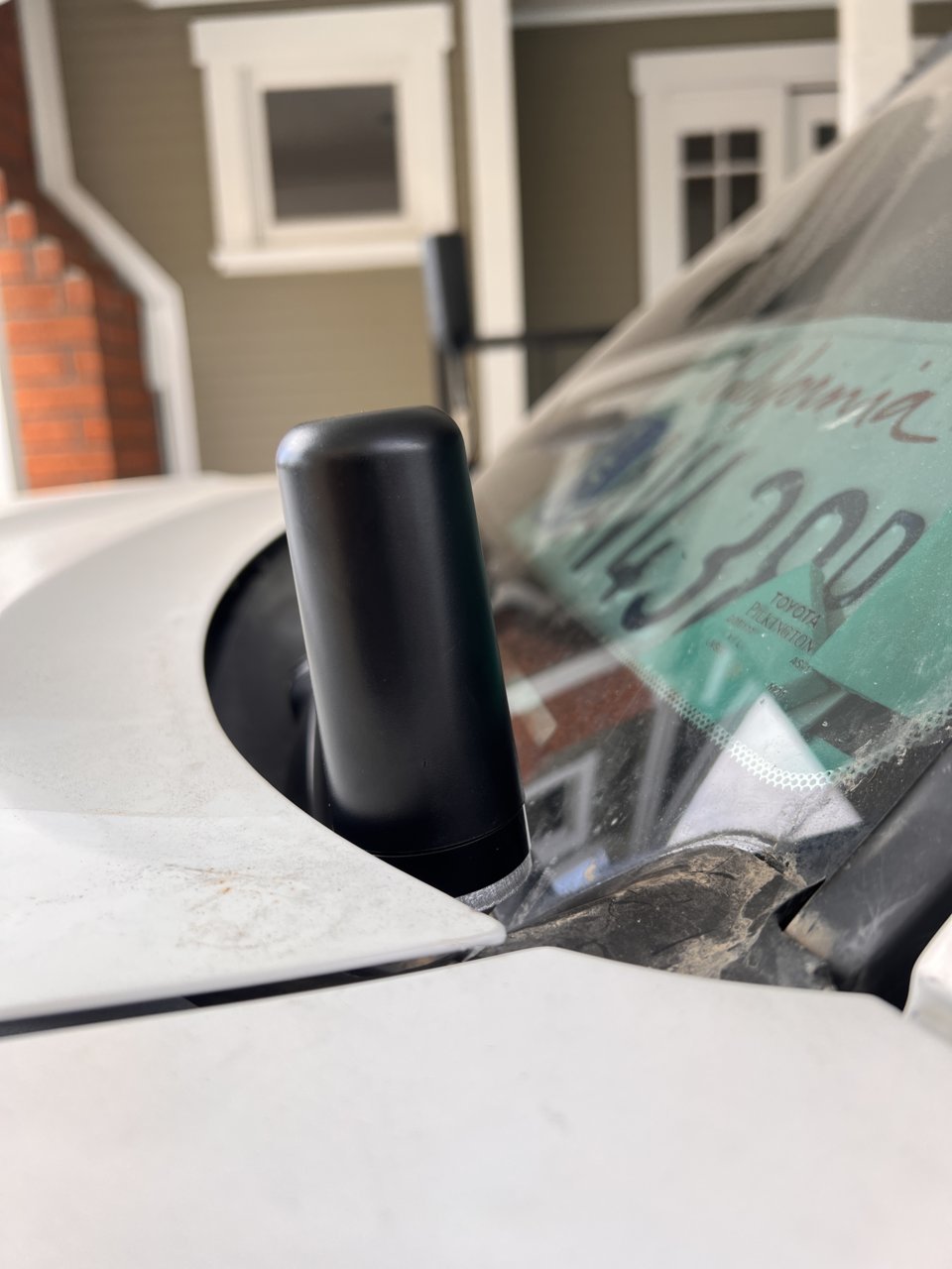

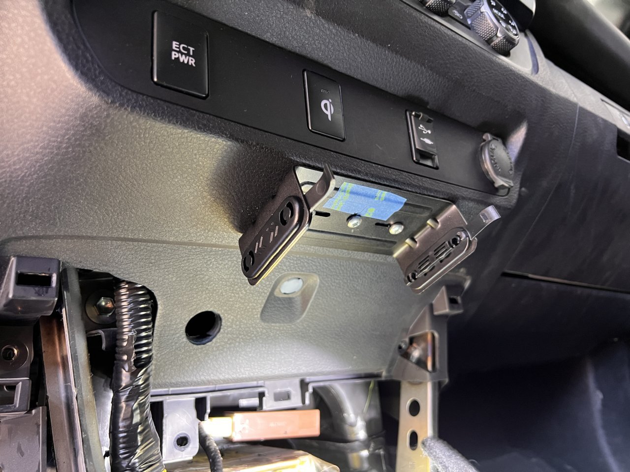

    installed a Midland MTX115 radio into @prof.jones 3rd gen this week, a good radio for us to use between trucks when out on trips. I have the same installed in mine with the 3db gain antenna and Sally has been using a handheld in the past which is annoying - as much as anything else. I thought this would be as easy as the 2nd gen, but nothing about hers was simple, the area in the center console is hardly flat, and its textured (mine is installed just with VHB tape) so VHB tape alone didn't work, access to that area is limited - with no real access out the side (between center console and footwell) anyway - it sticks out a bit further than on my truck due to the only flat area - but will def make like easier in the future for chatting on trips (I didn't like any of the install's ive seen where people have them on the side of the center console etc)
    https://www.amazon.com/dp/B07P92Z2BB?ref=ppx_yo2ov_dt_b_product_details
    https://www.victory4x4.com/product/VT3CB-BARE.html

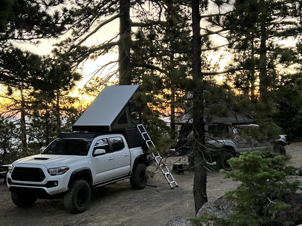

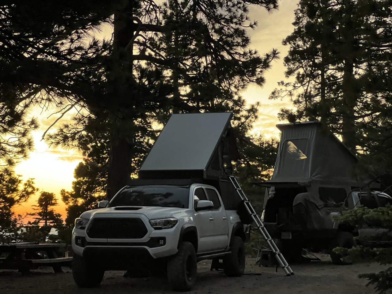

  5. Jun 4, 2023 at 2:33 PM
    #25
    prof.jones
    prof.jones [OP] Member
    Mar 11, 2019
    #286285
    18

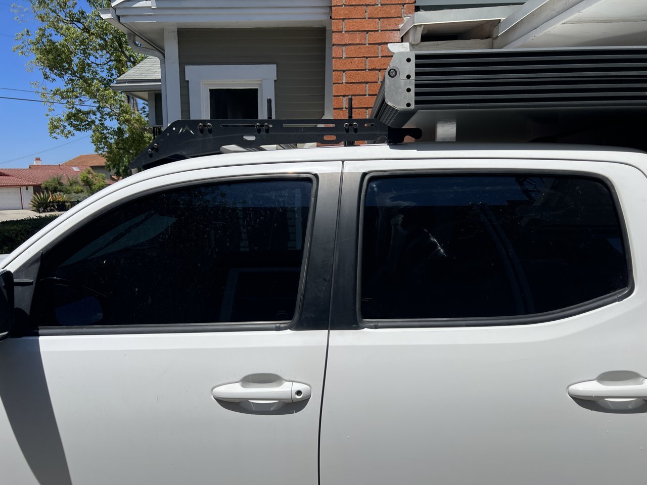

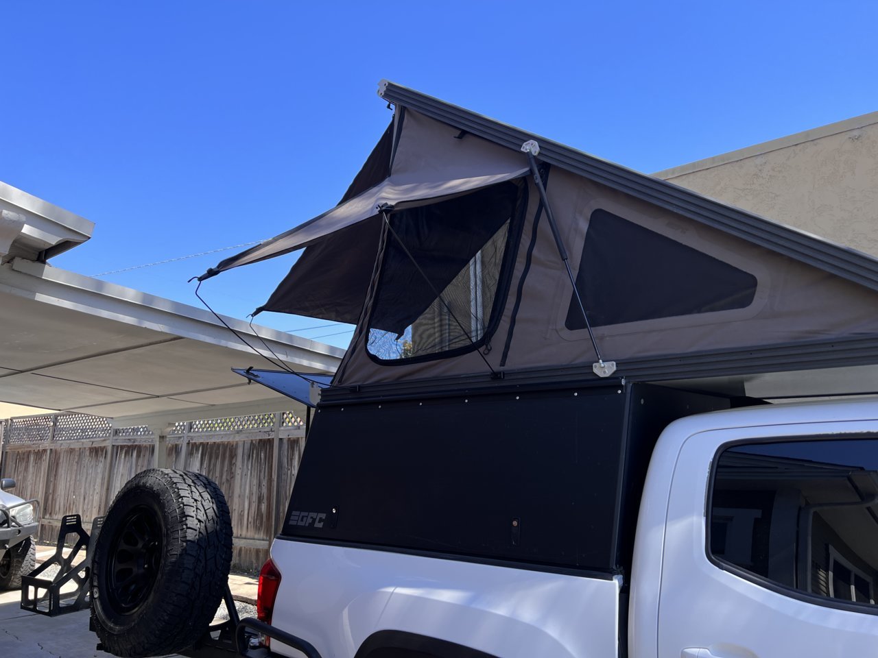

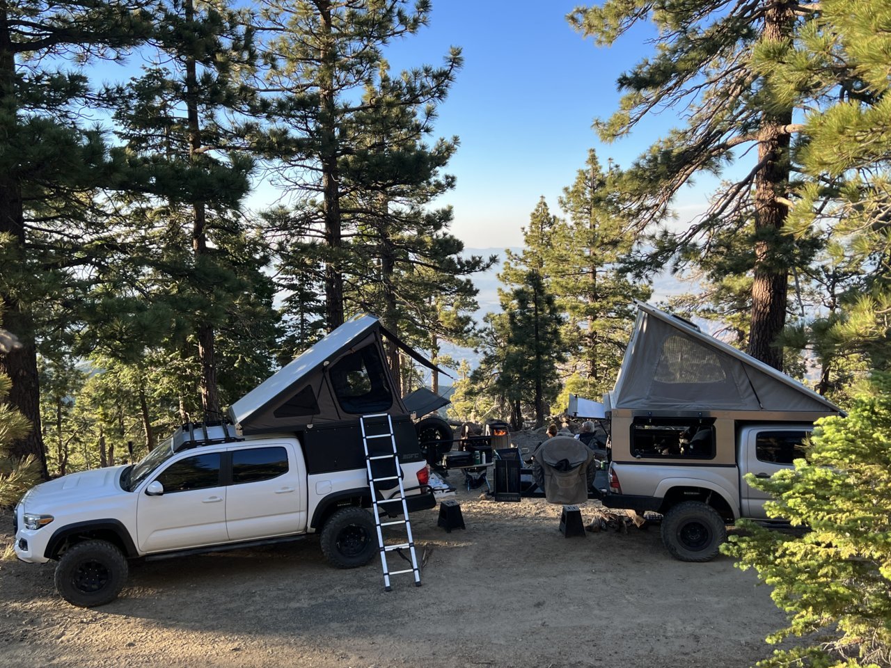

    Testing out some of the new parts
    Bruteforce Fab HC rear bumper (second hand)
    New GFC V2 style tent
    Overland Softgoods mattress topper and sheets
  6. Jun 4, 2023 at 7:10 PM
    #26
    sawbladeduller
    sawbladeduller semi-realist
    Oct 3, 2014
    #139583
    1,167
    North Cal
    '15 DCSB '98 2.7L
    fully zip tied
    like the 'awning' over rear tent. that is part of V2, or always been there? definit vents
  7. Jun 4, 2023 at 9:50 PM
    #27
    d.shaw
    d.shaw Well-Known Member
    Aug 15, 2016
    #194653
    1,080
    2012 Silver TRD-OR
    Vagabond Drifter, King 2.5 coilovers, King 2.5 rear, Pelfreybilt front / rear bumpers and skids, rock sliders, Safari snorkel, Smitybilt winch, Baja designs 20in, wide cornering spots, S2 rear. Deaver expedition series stage 3 rear leaf.

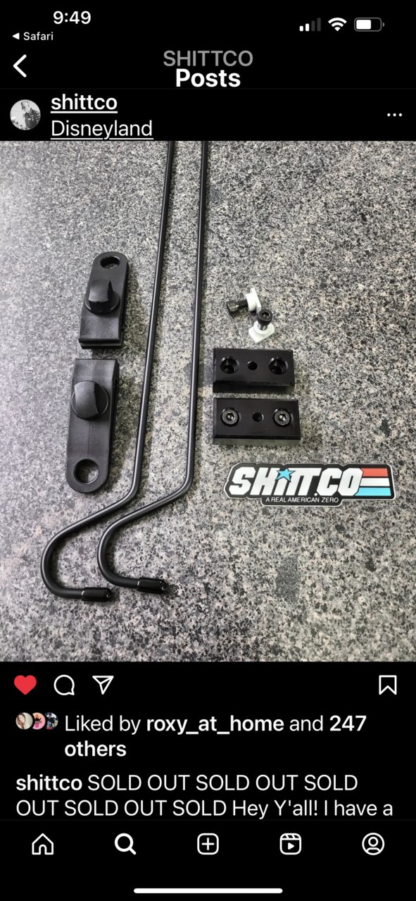

    thats the rear door with “shittco” shitblox and poles to make the “awning” - available thru his instagram
    He makes a few other parts too

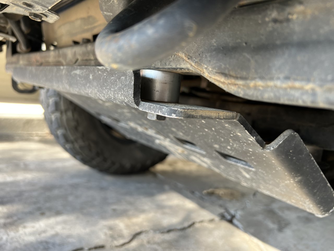

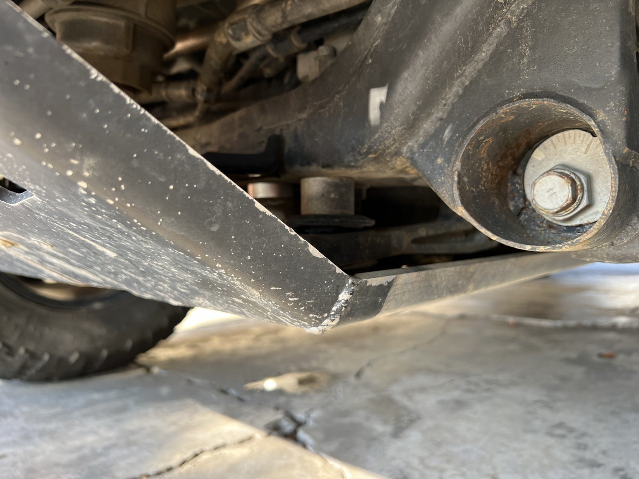

    This truck has for a long time had a metallic creaking noise out of the front end, I always thought it was the RCI skid plates, somehow moving against each other - so I have tightened and removed and reinstalled the skids over the last couple years. The noise was never consistent - it would almost disappear at times.... well today I took it to the Truck Shop thinking there was something very bad happening - and it required some major surgery to repair...(rebuild the shocks..wheelbearings, lower ball joints)? James called and said he figured it out. Skid plates. He added a couple spacers - noise is gone.
    Magic

    Do you have any core support issues such as cracks? It's a huge bummer that Toyota uses tin metal for such an important structural piece.

    None that we have seen, did have some in my truck, which ive had repaired. Sally's truck is basically all stock up front so it keeps it lighter for sure, but I do try to keep a watch. Yes Toyota does a great job in certain areas and total blah in others, the Super White 040 paint issue being one of them...

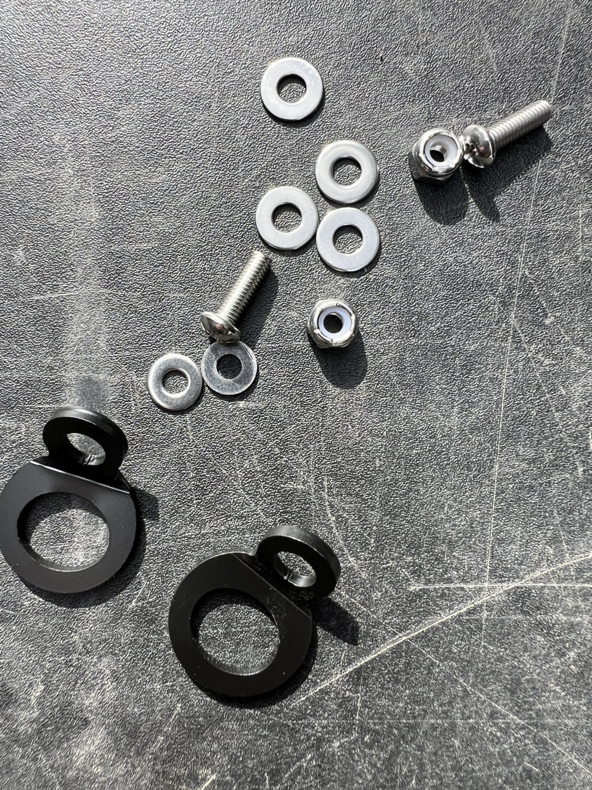

  17. Jan 15, 2024 at 1:59 PM
    #37
    d.shaw
    Aug 15, 2016
    #194653
    1,080
    2012 Silver TRD-OR

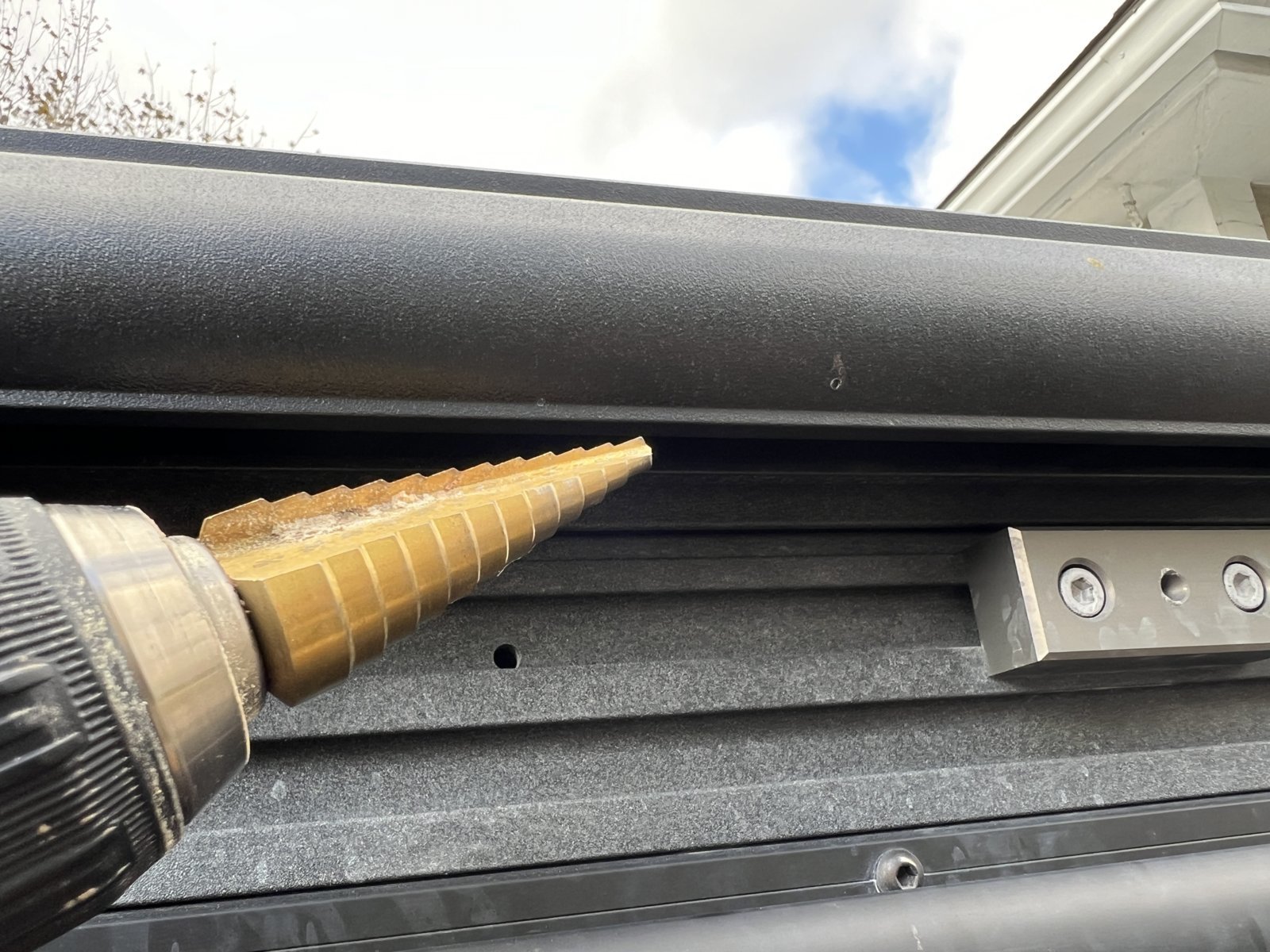

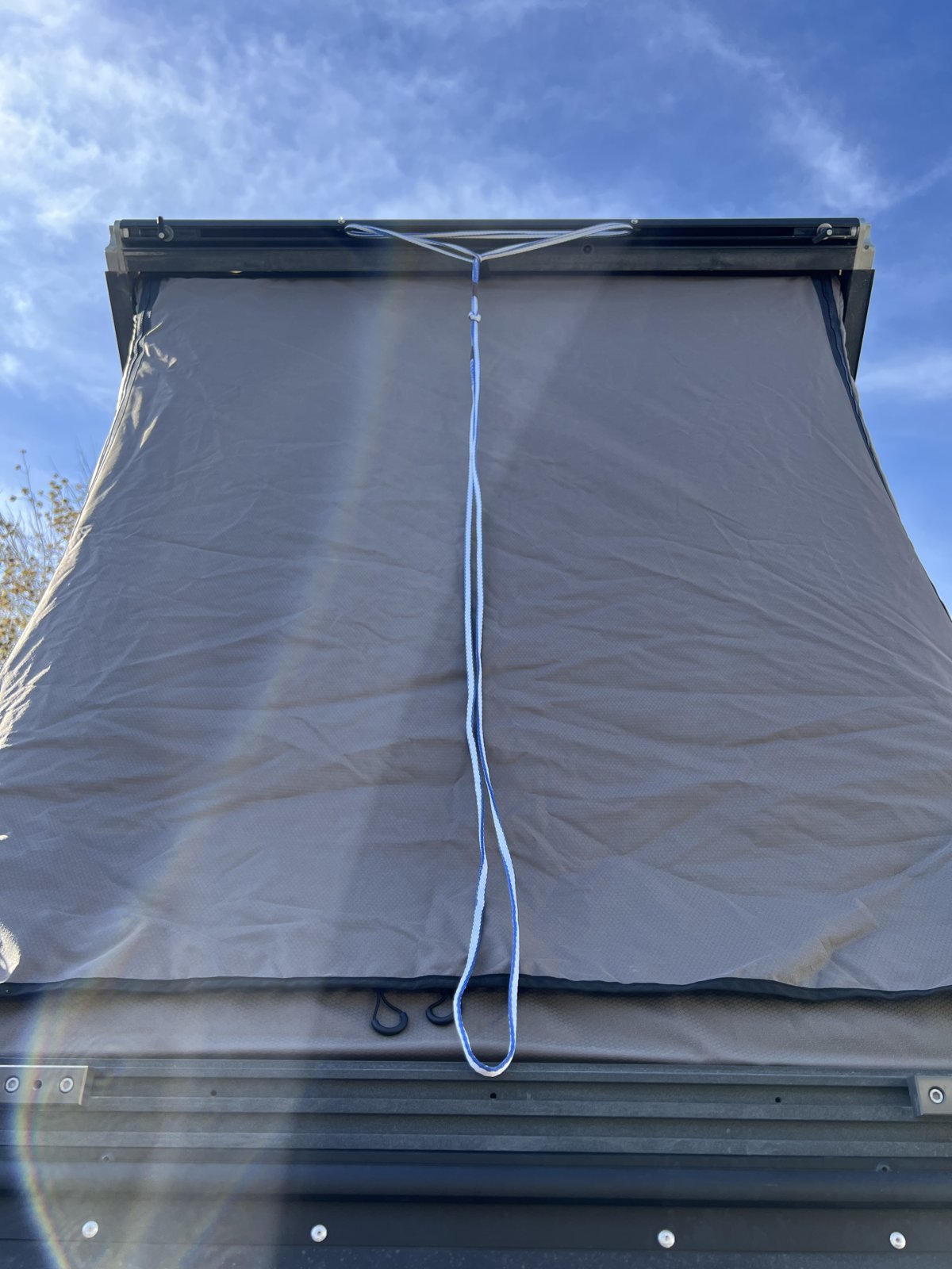

    Since buying the GFC I have longed for an idea to help close the wedge. with Lumbering Bear (the Ursus and the Ripley) making a sweet pull-down for the V2 - and having some left over anchors from my seat delete, I came up with a plan.
    Step 1 - Assemble parts which includes these anchors I purchased off Amazon and assorted hardware I had laying around
    Step 2 - Drill into GFC handle / slide - I used a step drill bit and made mine about 15 inches in from the sides, for no real reason - wider might be better yet but this so far seems fine
    Step 3 - This was for sure a bit more tricky as there is like zero room for my hand (at least) so I used painters tape to firstly hold the washer to the anchor whilst I got the bolt through, and then used it on the back side of the spanner to hold the nut in place, then blindly held out for a miracle to get the nut started (didnt take too long) - my only worry is whether the thread lock part of the nut has actually caught - time will tell pretty quickly thou I guess
    Step 4 - I started using some gutted 550 cord - including some wiring heat shrink to protect around the hardware but wasn't too happy with that, the 550 has some stretch to it - so I pivoted and decided on a couple ready made Mammut Dyneema 120cm slings, thin enough to pass through the anchors, thick enough they are likely not to break too soon and long enough to give some options
