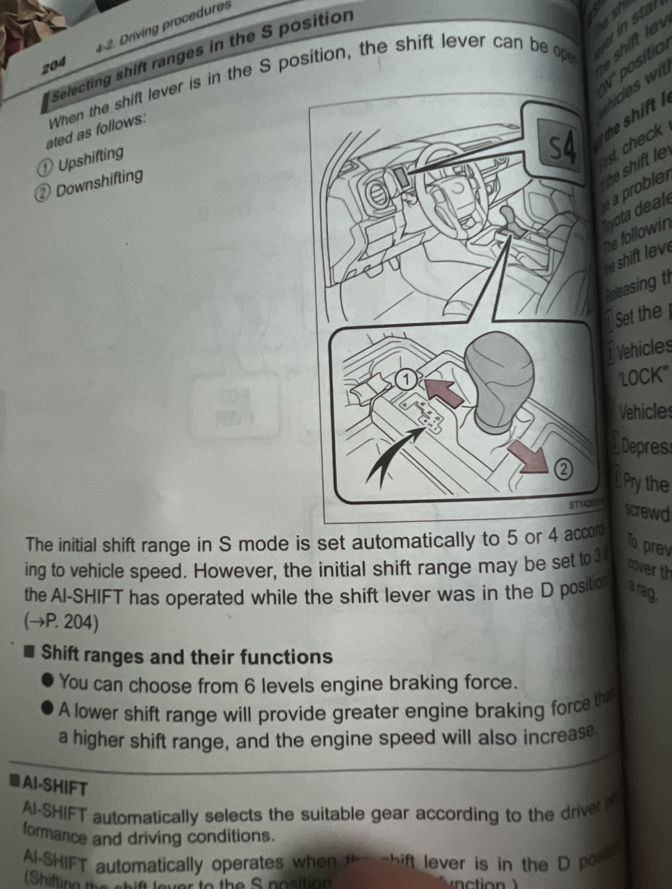

    It reads different though, and almost contradicts itself when it mentions AI shift. Some things I’ve read say it shifts for you to stay in the appropriate gear. But the manual says I can select the gear and the Lower numbers are better for engine braking, so that’s why I’m curious about how to best use when going downhill bc it seems like I’d move it to S then have to hit the minus at least twice to get to 2 - but wouldn’t I likely be rolling faster speed wise than what 2 would be for? I guess I’ll just have to try it and hope I don’t blow anything up.

    Yeah I thought S mode was like "manual mode" when I first got mine too (because it was in my Volvo that I had previously).
    In our trucks, if you put it in S - it still shifts on its own, but won't go into the highest gear (I think - or maybe the highest two gears)...may depend on how fast you're going.
    If i were towing, though, I'd definitely put it in S, and try to keep it below 70mph.

    You won't blow anything up. If you try to drop to 2 or 1 and the computer thinks it's too harsh, it will refuse the command and give you a quiet double-beep. The double beep is Toyota-speak for "you're rolling too fast for that action holmes."
    And for clarity, S mode means it locks out n+1 gears. If you are in S4 for example it will shift the transmission like normal at points 1-4, but will not upshift to points 5 and 6.

    it will not go past whenever gear you have selected in S Mode. if you select 2 it will not go past 2,etc.
    when you move over to S mode it defaults to 4 and you then adjust to whatever gear you desire. if i am going up a hill i select 3 then when i am at the top of the hill i put it back to D.

    There aren’t hard mph limits. It will kick up your rpms, but as rock lobster said you won’t even be close to redline at 65mph.
    To echo what’s been said; it isn’t complicated and you’re overthinking it. Just practice and you’ll get the hang of it in a few miles. There’s not really a way to mess it up. Worst thing that’s going to happen is your mpgs will drop from higher rpms.
    No need to use it going uphill unless you’re towing.
    “AI-SHIFT” is D. S-mode disables it
