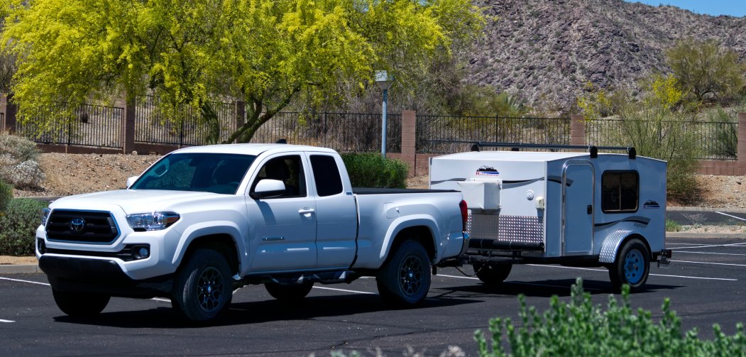

    This is an item of thought for me as well.
    Typically when just towing my little camper here or there without and gear in the bed or the camper I just use ECT
    around town on flat surfaces and limited freeway driving.
    When the truck bed has camping gear, coolers, the works I use ECT and slip to S4.
    Should I be slipping to S5 or just use ECT. Or is ECT and S4 the best starting point.
    Or should I fogettaboutit and just use S4 or S5.
    Seems I remember having to drop so S3 on steep inclines on some occasions.
    Camper only weight about 1,000 pounds or so - might be 1,200 tops with stuff in it.

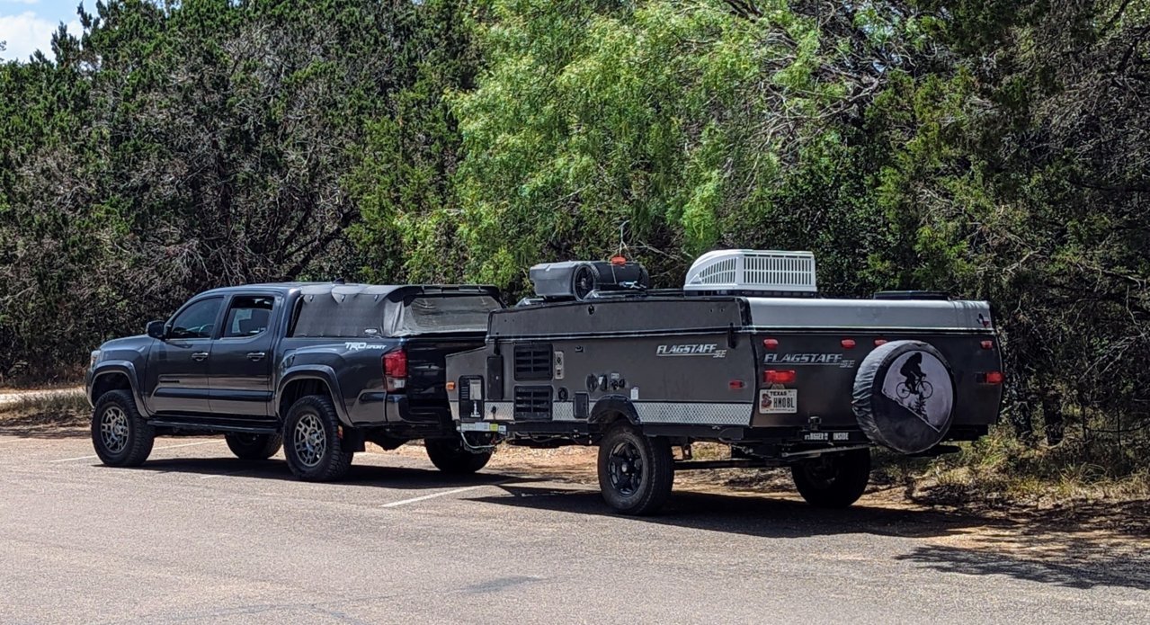

    Towing little campers has different rules for a different reason.
    90% of the time I put ECT on, S4 and forget about it. The reason being is that frequent shifting in and out of the two overdrive gears (5 and 6) when towing can generate a lot of heat and is generally harsh on the transmission.
    If it's a long flat stretch above 60mph I'll sometimes bump it up to S5 and gain about 2 mpg from the higher gear. But I also watch it to make sure it can hold 5th (at 65 mph 5 is under 2k rpm, 4 is around 3k). If its frequently hunting between 4 and 5 like it would in wind or rolling hills, knock it back down to 4 and leave it.
    You won't hurt it in S4 even driving all day on the interstate. The only reason to bump up to 5 (if the truck can hold it) is for fuel savings.
