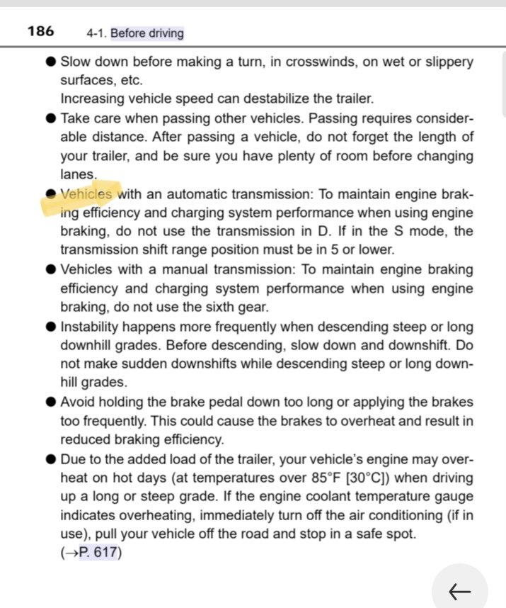

    The engine brake feature is accessed in S mode. Owners’ Manual, pg 186:
    Chew likes this.

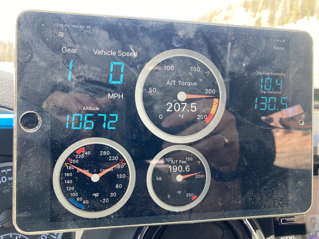

    I tow a 5,000lb trailer a lot. The only time I’ve used S2 for engine braking was descending Wolf Creek pass in CO, it was a 25mph speedlimit on a 7% grade.
    Generally I tow in S5 and only use ECT for engine braking.
    Another thing to pay attention to is transmission temps, the pan temp and torque converter temps. The torque converter only locks up in 4th, 5th & 6th so if you’re climbing a hill on 3rd your temps will rise quickly…
    Photo of my OBD fusion app dashboard as I summited Wolf creek pass showing various info.

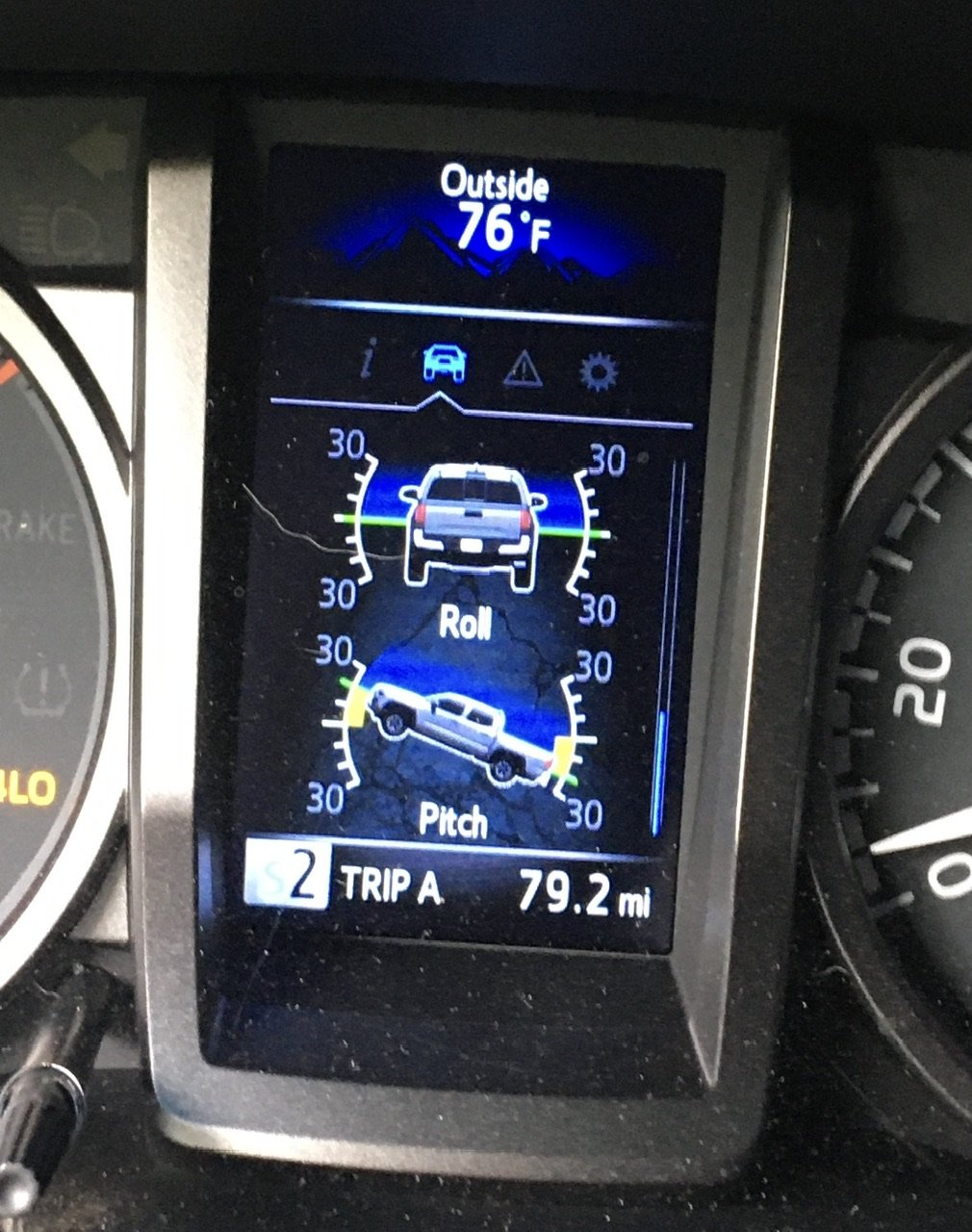

    cryptolime
    cryptolime Here to Help
    Dec 2, 2021
    #383651
    2,468
    Wilmington, NC
    2021 SR 4x4 2.7L
    i didn't even know that screen existed
