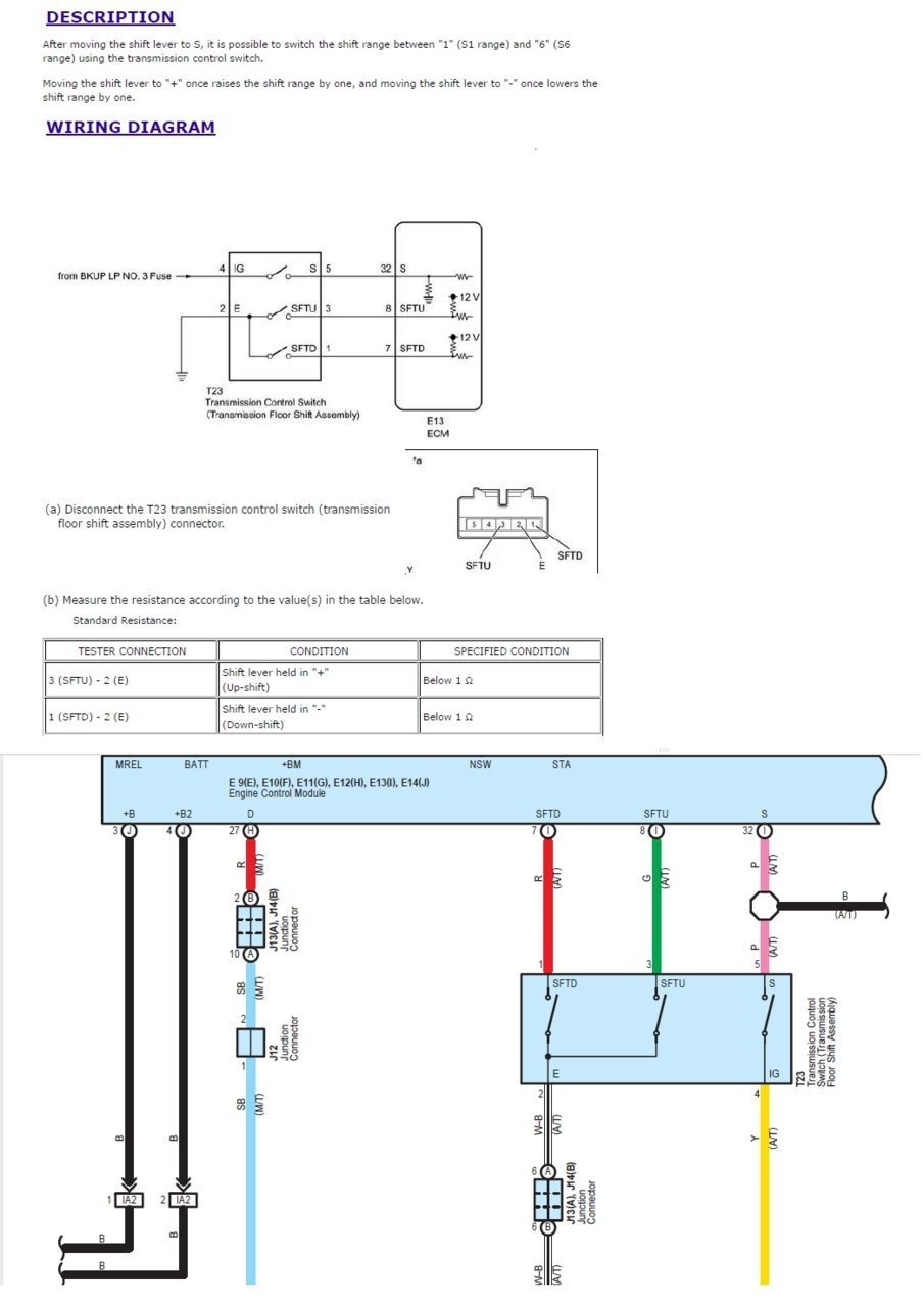

    I have been searching for a way to change the direction in which S mode shifts.
    I want it to shift up when I pull back and shift down when I push forward. Just seems more natural to shift with momentum, and I feel as though it will make driving in S Mode just a bit more fun.
    So here is what I did. First I started with this diagram hi-lighting the T23 connection
    which controls the up shift and down shift at the transmission floor shift assembly. According to the diagram Red Wire 1 is downshift, Green wire 3 is upshift. Therefore switching the wires will in fact change the direction of the shift.

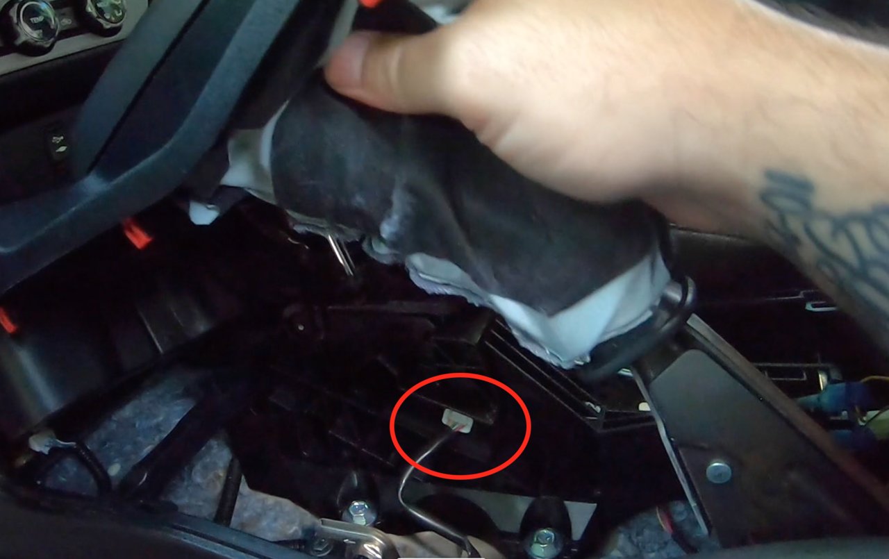

    Pull the clip and switch. Here is what you should be looking at.

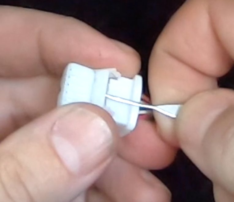

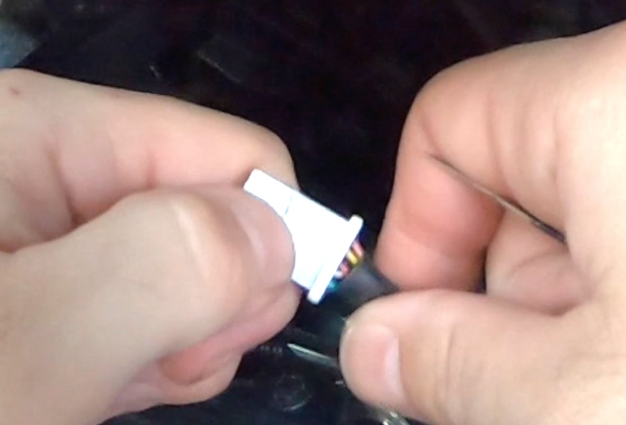

    Before you pull the wires out, there is a small clip on the under side of the connector which needs to come off here-

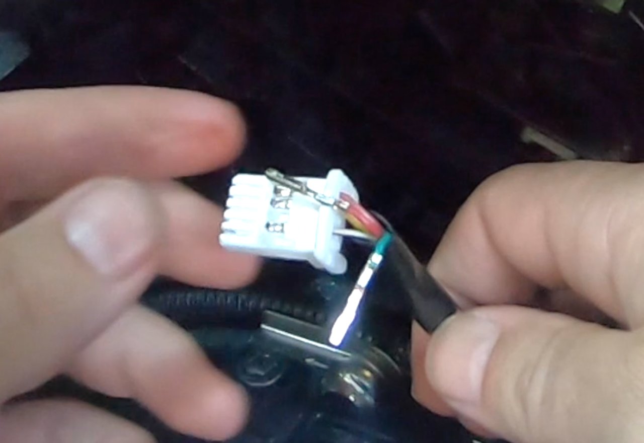

    Once that is off I used a terminal tool, be careful they are sharp. This is a huge set.
    Link- https://amzn.to/31pFMpa

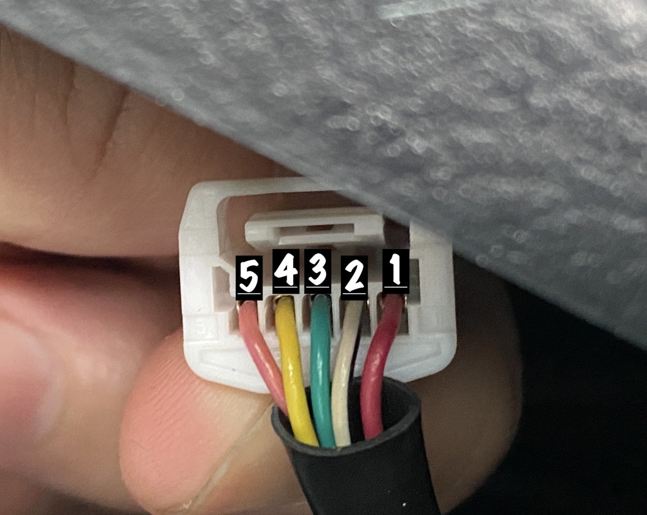

    Switch the red and the green wires.
    Red wire goes to spot 3.
    Green wire goes to spot 1. put the wire cap back on. Make sure the wires are all the way in and tight.
    Plug everything back in and enjoy your new shift directions.

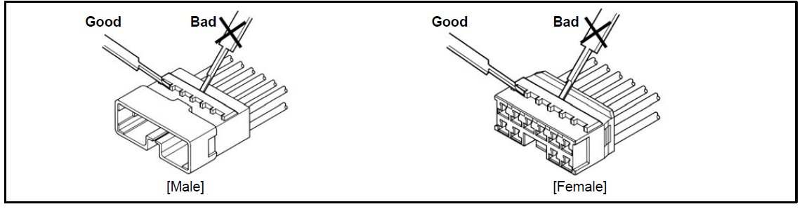

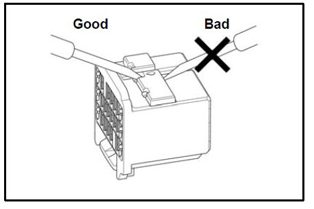

    As soon as I popped it up a little it came right off easy with no force and undamaged. It might be due to being a single stack of pins vs a double stack of pins as shown in the diagram.
    Either way, thanks for the heads up.

    The smaller connectors aren't really meant to be disassembled n assembled again, they usually fail.
