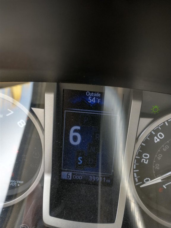

    I know its Friday, but as far as those S modes, they keep claiming you should have 6 modes. My 2020 sr5 only goes up to 5, 6th is locked out, otherwise the truck runs, and tows great....been that way from day 1. 6th is fine long as you use only the D mode.

    When you switch it into S (sequential) it defaults to 4th, but you can move it. All S does is limit the top gear the truck can pick - S4 just means it won't shift into 5th or 6th, but it can go 1-4 all it pleases. S6 is good so that you can be in pseudo-drive and can shift down to 5th without going into 4th. There is also some super specific thing in S6 vs D, I can't remember what it is, I THINK it has to do with LSD functionality, but it's been so long since I knew it. And, it's a very specific use case, so for all intents and purposes, they're the same.
    It's not tiptronic/"manual mode", so S2 is the same as D in gears 1 and 2. It'll still drop to 1st at the same time - although I think I read that S uses set shift points, and D uses "learned" shift points, so there may be a difference! But, 1st is still available to the truck in S2.

    You can shift S mode from S1 through S6. When going to S mode it typically goes to S4. Nothing prevents you from putting it in S5 or S6.
    As stated already the S mode position is an upper limit, the truck will still downshift as needed automatically. So while you have it in S5 or S6 it may be in a lower gear. Under reasonable speeds I’ve confirmed it can shift to 5th gear in S mode5 on a flat road at reasonable speeds. Likely the same for S6.

    I'm still not quite sure how some get the idea there isn't an S6. Slip into S mode, bump the shifter forward twice and there you are.
