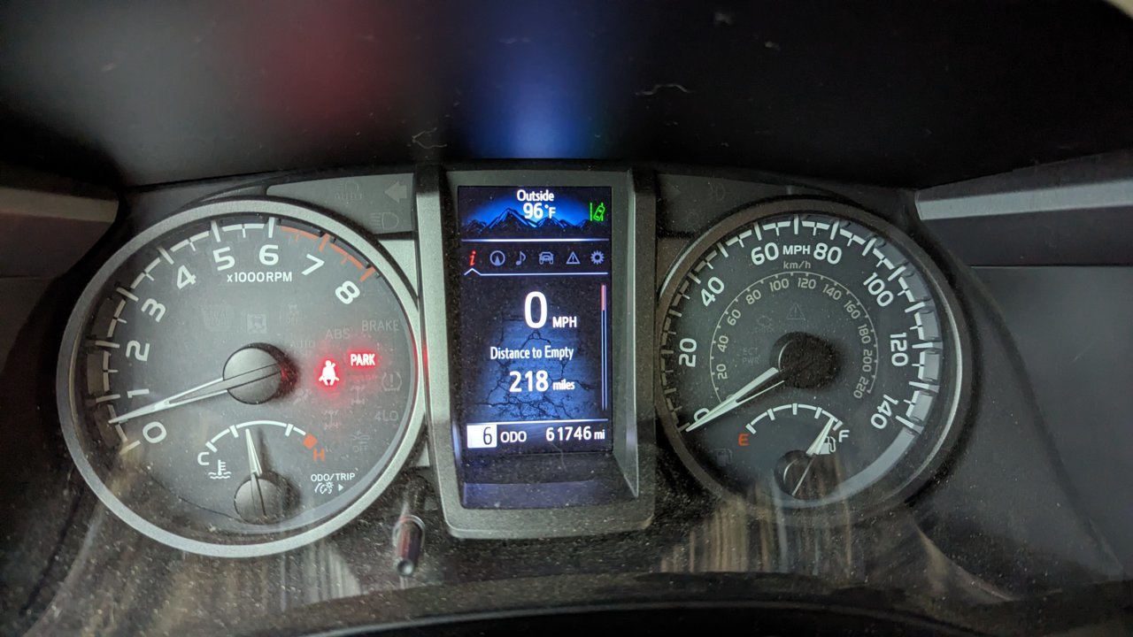

    What fixed the 2023 Tacoma that wouldn't go into S Mode? Mine is doing the same thing. When you switch the gear shift left it stays in Drive and no indication Stays D It will not shift any gears manually. But shifts ok in DRIVE. Plus one post on a 23 model described the same thing. Just to be clearer, when switched to s mode mine does not change. on the dash it indicates D. I can not shift any gears, but in auto it shifts find. I have a cabin in the mountains and I used it to down shift on down grades around 7 %. I KNOW HOW IT WORKS I WONDER IF ANYONE HAS SEEN THIS PROBLEM AND HOW TO FIX IT. GOOD NEWS WENT TO Toyota DEALERSHIP DID A Diagnostic ON MY TRUCK. TURNS OUT UNDER THE CONSOLE A CONNECTOR HAD COME LOOSE. HOW THAT HAPPEN I not know.

    I think you need to describe your issue better.

    So let me get this straight..
    - The Display does not show individual gears ie. 1 2 3 4 5 6, when you shift into S mode, just says D ?
    - is that just an issue with the display and S mode still functions as intended or does it shift the same way it does in D and you are unable to select gears?

    So when you move the transmission gear selector to the left for S mode, the instrument cluster panel does not indicate that it is in S mode?:fingerscrossed:
