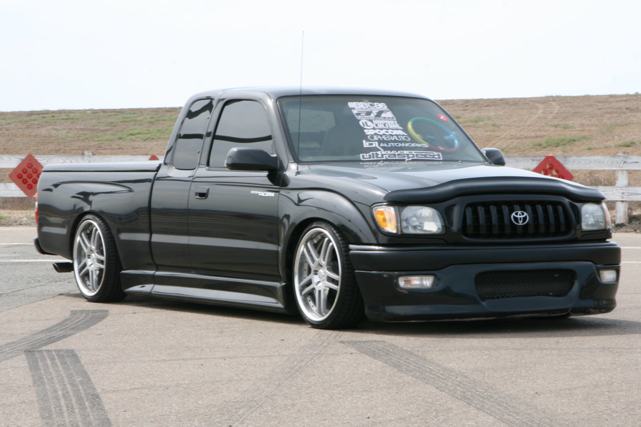

    '01 S-Runner original owner
    Exterior TRD 5 Piece body kit Grillecraft grill DDM Tuning HID retrofit Custom etched Lexus HID Projectors Custom two-tone pin stripe by Jprints Chrome Rocker panels Wheels/ brakes 99 Lexus RX300 OEM wheels converted to 3 piece by ChamorroBoy86 Cadillac ATS Brembo 4 piston calipers Cadillac CTS-V Ceramic Brake pads Mitsubishi EVO IV 12.6” rotors provided by BR Autoworks modified by ChamorroBoy86 Subaru WRX STI Stoptech Stainless Steel brake lines Suspension Custom FBSS air suspension Accu-Rate manifold Dual 444c Viair compressors Accuair Chrome tank Custom Polished Hardlines Streetacos weld on c-notch Custom front shock mounts Custom airbag brackets Streetacos ball joint flip kit Engine TRD supercharger URD 2.2” Supercharger Pulley 312cc NA 2JZ Supra fuel injectors JBA Ti Ceramic Headers Spectre Carb Legal CAI LCE Pro Clutch LCE lightened flywheel 16” electric fan HPS silicone radiator hoses Yellow Top Optima battery Custom Battery tie down Universal oil catch can Denso 105 amp alternator AEM 320 LPH Fuel Pump Interior 02 Lexus SC430 trispoke woodgrain Steering wheel Japanese Rose Wood dash kit Authentic JDM Tsurikawa Nishijin Sakura Gold Black (heart version) Authentic JDM Suichuuka shift knob Authentic Junction Produce Fusa Authentic Junction Produce seat cushion Authentic Influenced VIP satin Pillow set Broadway mirror Custom Aloha print door jamb decals from BigHeadzdesigns LCE Short shift kit Electronics Soundstream VRCP-65 Double Din Multimedia entertainment center Alpine MRV-F545 4-channel amplifier Alpine MRD-M1005 monoblock amplifier NVX VCW124 12” Subwoofer MB Quart DSH216 6.5” 2-way component speakers Black Vue 650S Front and Rear Dash Camera AEM boost gauge AEM Uego wideband O2 controller URD Mass Air Flow Fuel and Timing calibrator
    here is my s-runner that I'm still working on. I have owned it since 2001

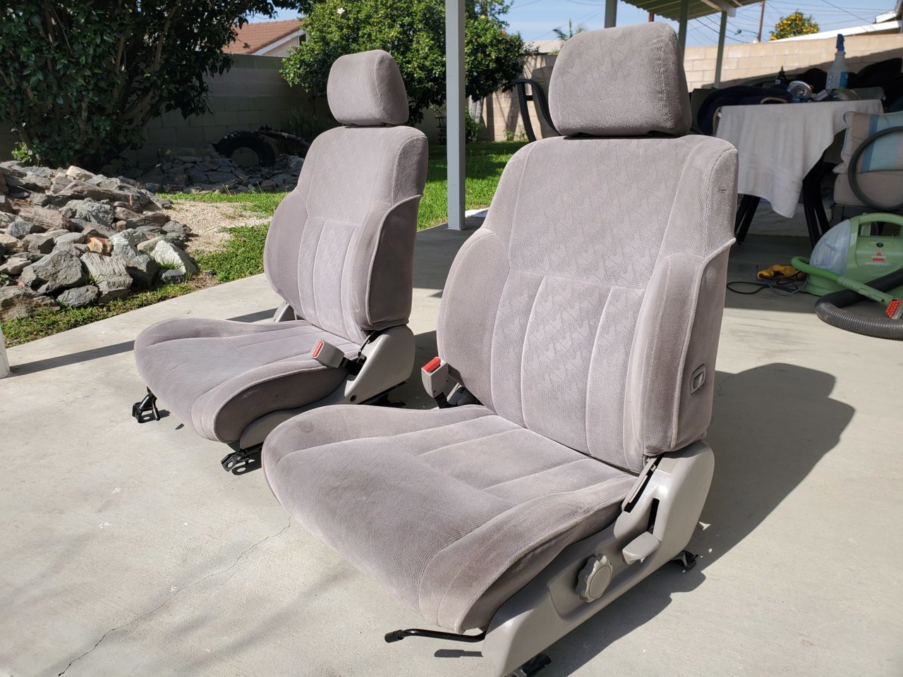

    Here are pics of some of the SRunner stuff I got to add to the thread also, since pics are great visual aids!
    Sport seats in charcoal with power lumbar:
    Front (which is not SRunner specific as far as I know, but I picked it up anyhow in hopes to reduce body roll and oversteer) and rear sway bar (on left) with all the mounting tabs and linkage (see those plates that mount to the frame, and the longer bent links).

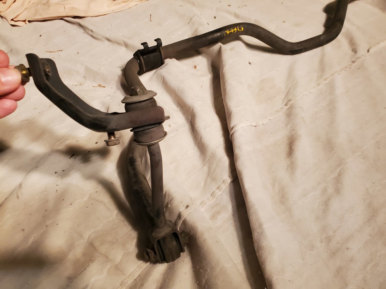

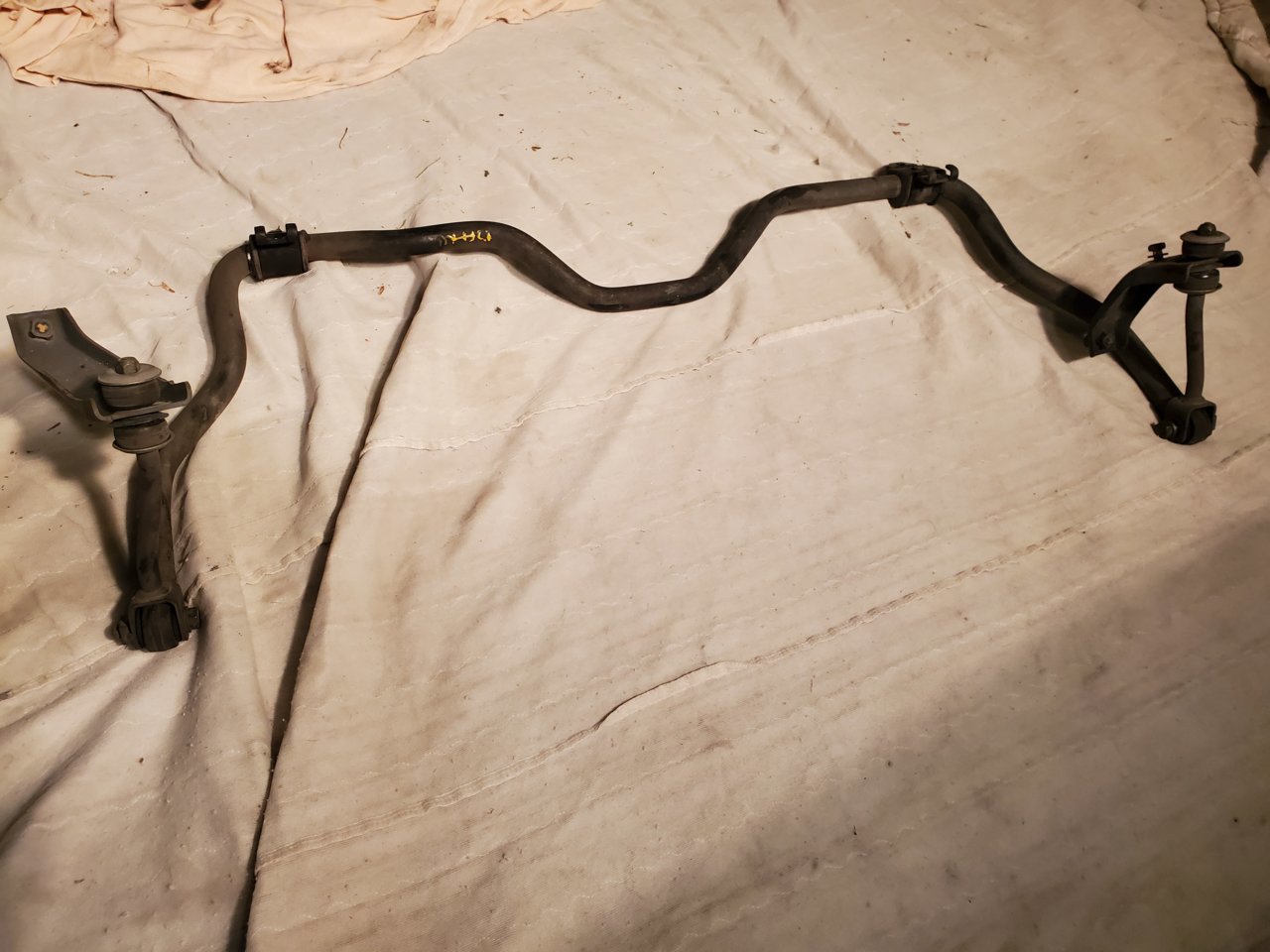

    @Sperrunner @e.deCastro Would you mind taking a pic of the rear sway bar and mounts for reference please?
    I started putting the pieces together and not exactly sure how they all go now!!

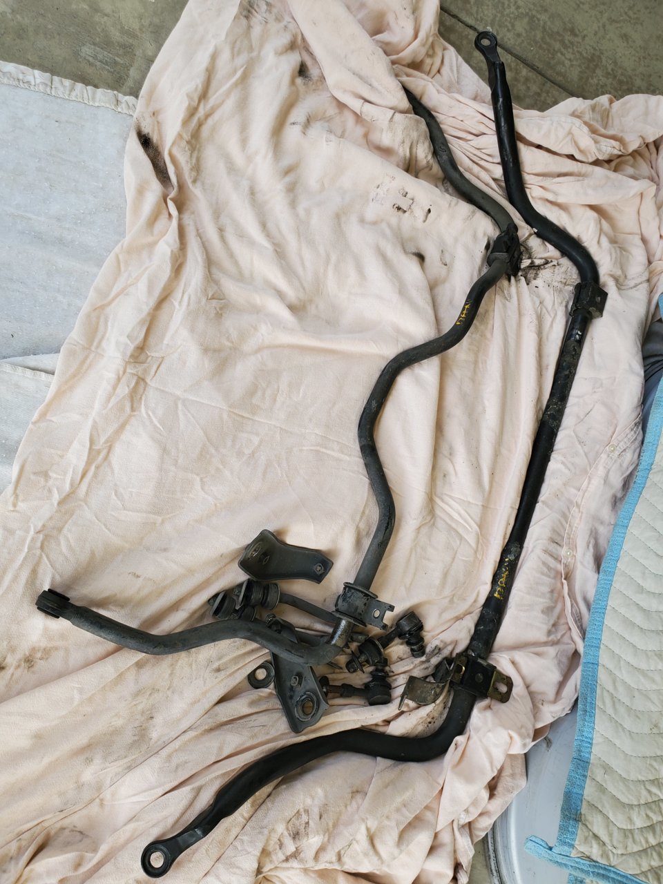

    I saw those at the salvage yard, and actually mentioned it above that I thought it should be added to your list of differences in the first post since I found out the hard way!
    No worries, I am thinking of running ubolts and saddle clamps to mount the bar to the axle similar to how aftermarket does it.
    But look at all these other parts, the links have a bend and I am wondering if it bends in or outwards from the frame:
    And also the part that connect the links to the frame, did I get this right on the left or right side (see bend in link also)? These are more what I am wanting to see pics of if you can oblige I would be quite grateful!
    Guess I could figure it out underneath the truck of course, but wouldnt an SRunner sway bar pic and pics of all the SRunner stuff just feel right at home in this ultimate online resource for all things SRunner thread?
    The beautiful black SRunner is my favorite part of the thread actually, even though it is missing the color keyed fender flares!!
    Thanks again either way :thumbsup:

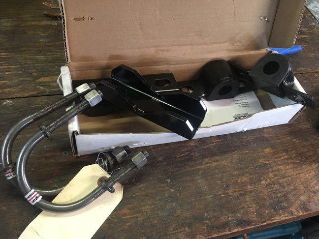

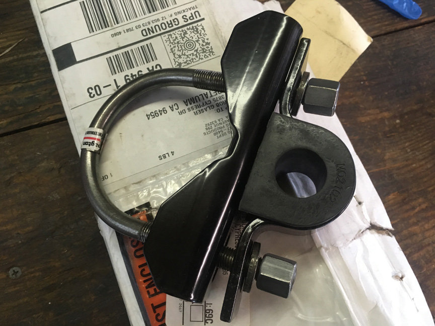

    I've had a complete S-Runner rear sway bar lying around and have done some leg work on how to mount it on a single cab Tacoma.
    Also can answer some of your questions on how it mounts.
    End link brackets - these are located inside each L/R frame rail, the bolts pass thru the outside and underside of frame to secure these L brackets.
    Note ALL 2001-2004 extended cab should have these holes, single cabs do not so you need to drill the frame. I've seen these holes on extended
    cab PreRunners, etc. So find someone with an extended cab and make a template for these holes.
    Aftermarket axle mounts - I started on this route, found stock parts from Helwig that could work, see my photos. I got the ubolts somewhere else.
    But these are pretty large and will require some rerouting of brake lines. So I started down the next rabbit hole...
    Replicate S-Runner rear axle saddle mounts - This would be far the cleanest installation, I designed these and 3D printed them to eyeball the fit.
    Haven't got around to fabricating a pair (which would then be welded to rear axle housing), these utilize the original S-Runner axle sway bar bushings and clamps.
    Hope this helps, looks like you scored with the S-Runner parts!

    Thanks for the reply, I had seen the Hellwig mounts and those inspired my saddle clamps post above!
    Good note about the brake lines, wonder if they can be bent to make do?
    Can't wait to see how your weld in mounts come out!!
