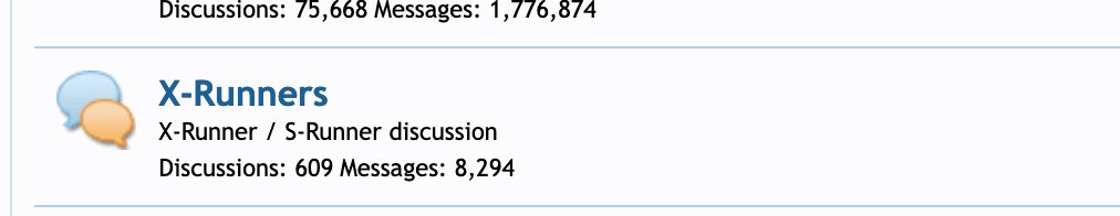

    I guess you missed the sub forum on here dedicated to X and S runners.
