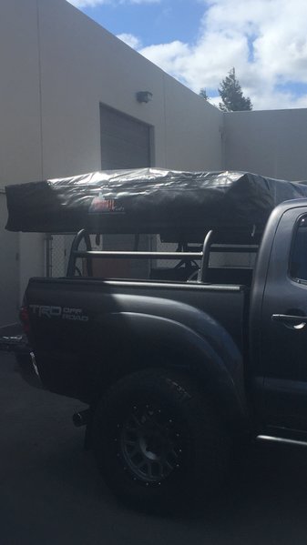

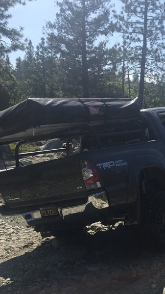

    It's the ruggidized XL roughly 6'x8' opened up. It'll fit the wife and I along with all 3 kids.

    No wonder it looks like it is hanging off the back. That is a big tent. :thumbsup:
    I love my tent it is the 3 person.

    Wow that is indeed a big mofo RTT. 4-person? Also, as far as the rear end sag goes, a lot of that weight is out behind the axle more. On a DCLB, the axle would be about a foot farther back, so there would be less weight behind the axle, causing less bro lean.
    I figure my Leer cap is about 150 lb. The Prinsu Toprac is 36 lb.

    Aha. I'd be looking at a 3-man max.

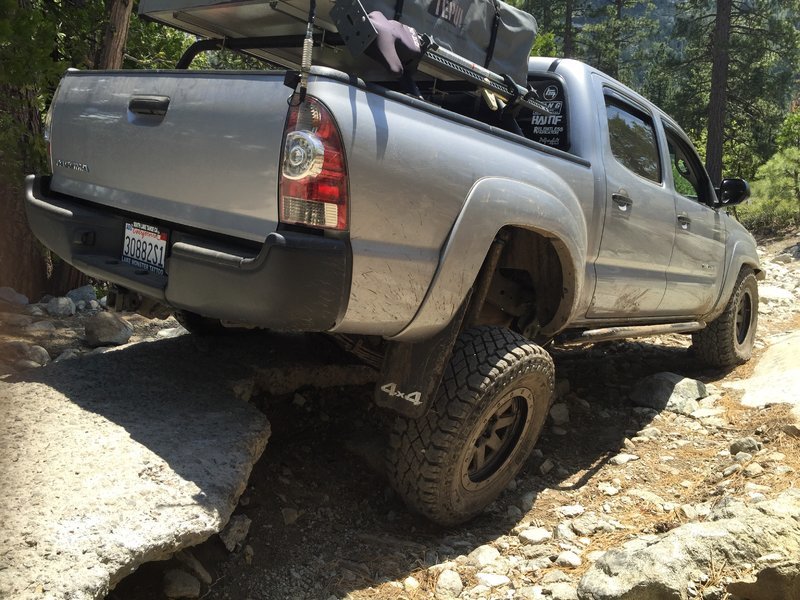

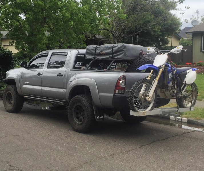

    Sound like a perfect candidate for expos. Heres mine fully loaded with and with dbike. image.jpg And heres one getting kinda droopy. Keep in mind i do have 12" kings, shock relocate and shackle flip.....

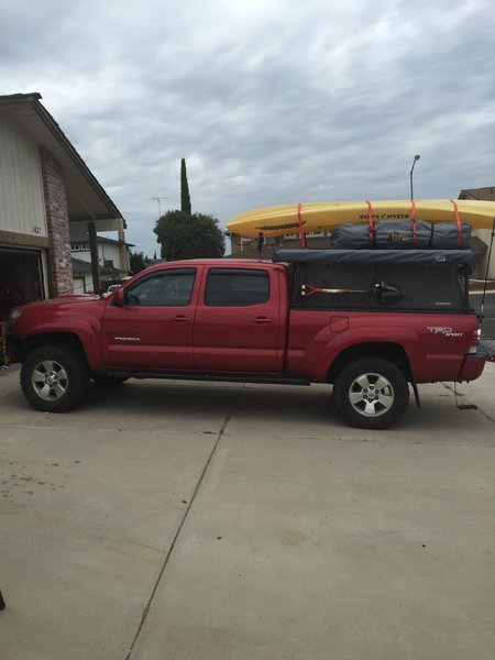

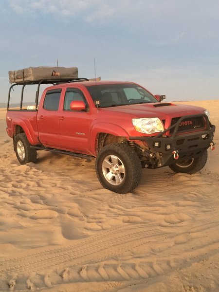

    I can't remember the fab guy. It was out of Texas. I have the autana from tepui.
    I normally run a soft topper underneath the rack.

    I like the fact that you can run the soft topper also. I may change my setup someday to do the same but for now it'll work. Your truck is looking good man!!!!

    Thanks, I'll find a pic with the topper underneath it.
    And kayak on top, lmao.

    That looks good man! No sag at all. I'm leaning more towards them than the Dakars, but my concerns are: 1. what shocks I'd run with them (front and back). I could get the rear kit from all-pro, which comes with billies, but then I'd want to match the front and I'm back at the billy/eibach thing. I read nitrchargers aren't long enough for expos, so that leaves more expensive CO's with matched rear, which starts to get out of my price range. 2. I read that they give even more lift on 1st gen (4 - 4.5"). I might either have to take a leaf out or lift my front up to a full 3" and then, I'm looking at UCA's which again starts to push things out of my price range.
