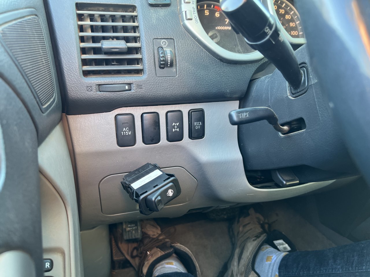

    I took a long time to finish my wiring, then went to a different PC (this one is in Roseville). Played on the rock pile just long enough to use my rear diff lock and see that it helps when all the rear axle weight is on one tire. I didn't want to stay long enough for the cops to be called.
    I've ordered the switch to fit the hole next to my center diff lock button, but it won't be in for a couple weeks, so the one that came from Eaton will have to do for now. IMG_1436.jpg 70157102269__21358262-29DE-4A7E-B03C-D5C7CA8A425F.jpg

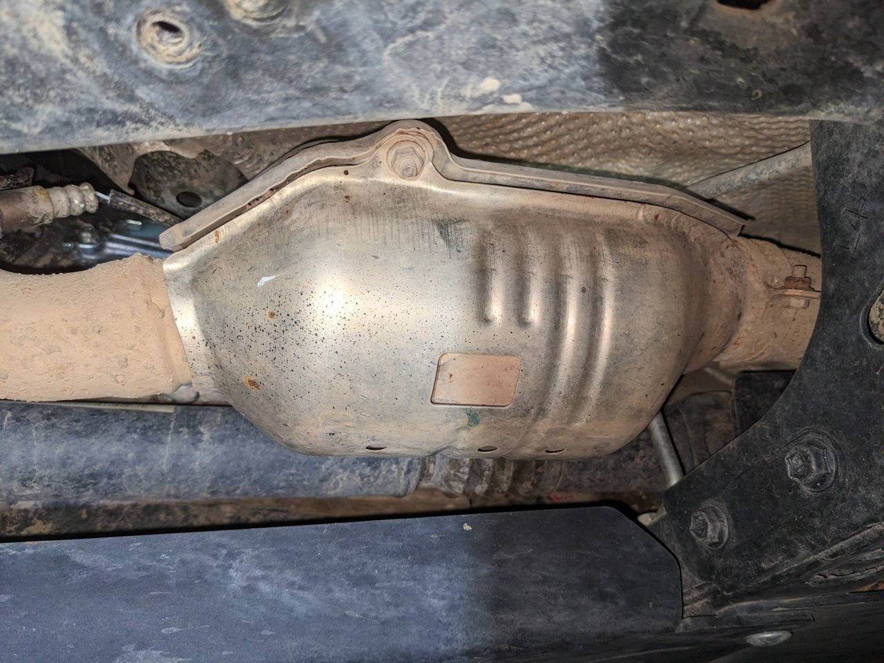

    Anyone know what this noise could be coming from? It happens when the truck is idling. I recorded it under the front passenger wheel well. That's where the it sounds like it's coming from. I haven't had a chance to dig around yet but any pointers would be appreciated.

    Sounds like something vibrating at a certain rpm frequency. My stock skid was doing that for awhile. I could tab the skid with my hand and it would make the same rattle sound.

    Its not the skids. I checked those at some point.

    Did some digging around. This thing is rattling at certain frequencies. Not sure why, all the bolts are tightened down.

    There's probably a small rock or other debris between the shield and your cat.

    If shields or skids are too close to other exhaust piping, it creates this noise. I suggest remove it and put a washer as a spacer to move it farther from exhaust piece.
